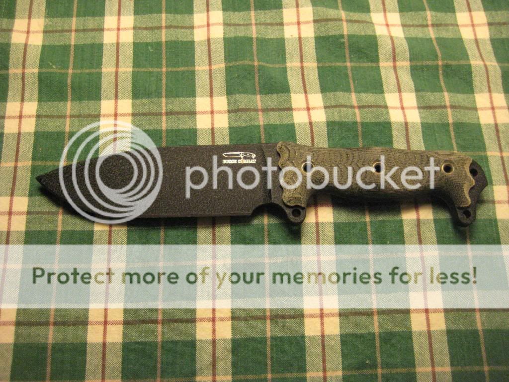

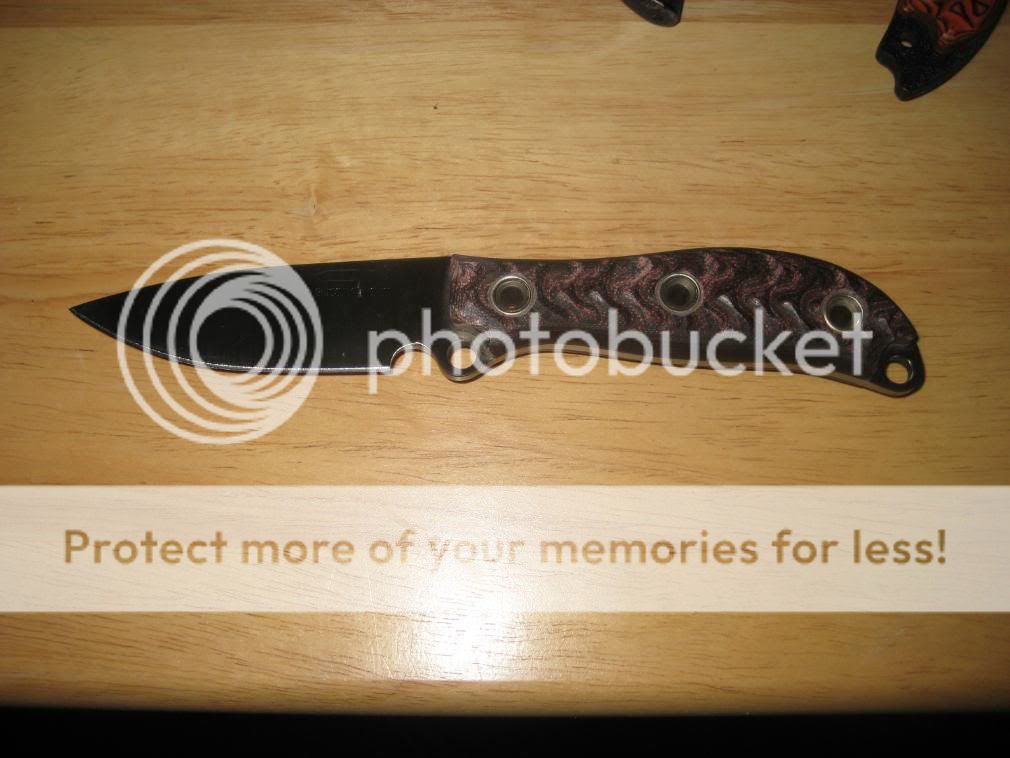

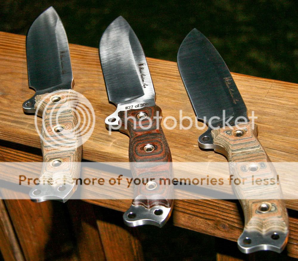

I prefer mineral oil. Sure, you'll need to apply fairly often, but when it comes to oiling or reversing the process, nothing's easier. Also, it's completely non-toxic, so whatever is absorbed into the skin of your hand won't affect you in any way. Here's a few pix of those that I've oiled, with the exception of the Meaner Leaner Streets... The MrLrSt with the larger choil came back from Busse oiled, so I'm not sure what was used on it, but it was darker looking than regular mineral oil usually looks. The tigerhide pops when oiled, but I find that it looks even better if you hand wash the slabs with soap & warm water using an old toothbrush before applying the oil to the slabs once dry again. :thumbup:
