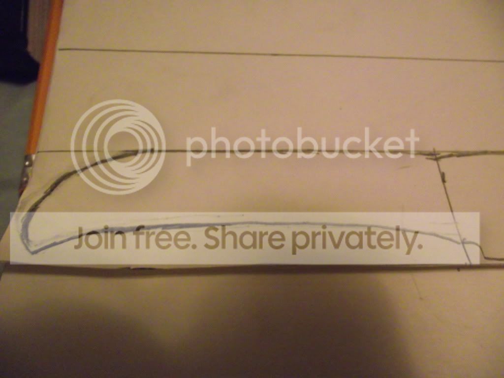

I have been posting questions and getting a ton of help, and i am finally ready to proceed with knife 1. i should be getting steel in a couple weeks, and so it is time for the design to get looked over. I am not posting a picture of my hand holding a cardboard cutout because i can not get the cardboard to come out right.
First of all, I would like to thank the people that have made diving in fun and easy. first of all, the whole community has been great. everyone give yourselves a hand. you have been great. next, Mr. Max Burnett. I read his heat treating tutorial, which was excellent, and then e-mailed him with questions. he responded quickly and gave me all the info i needed. thank you, sir. next is mr. Ray Laconico. he has allowed me to use his nessuk handle design, and i am very happy about that because i just fell in love with it. last, but most definitely not least, is Mr. Stan Buzek. I asked him about wood, and he sent me some "scraps" (read- super nice pieces of wood with nicks out of them), free of charge, to look at and use. Sir, thank you very much. the only reason they are not going on this knife is because i do not want to mess them up. :D You all have made my hobby a dream to start.
Specs:
3/16-1/4 inch 5160, 1.5 inches wide.
cherry wood handle
Blade: 7 inches flat
Handle, 5 inches flat
Handle attachment: big pins and a lot of epoxy
On to the design. I have fallen in love with drop points, but i also like my knives thick, chunky, ugly, and functional, and so here is what i came up with. This is a chopper, and so i wanted as much flat blade presented to the chopee ;) as possible. a little bit of curve is appropriate, and so i went with just that, a little. there will be no swedges or prettifications. i am going to be beating the living crap out of this. here is the blade

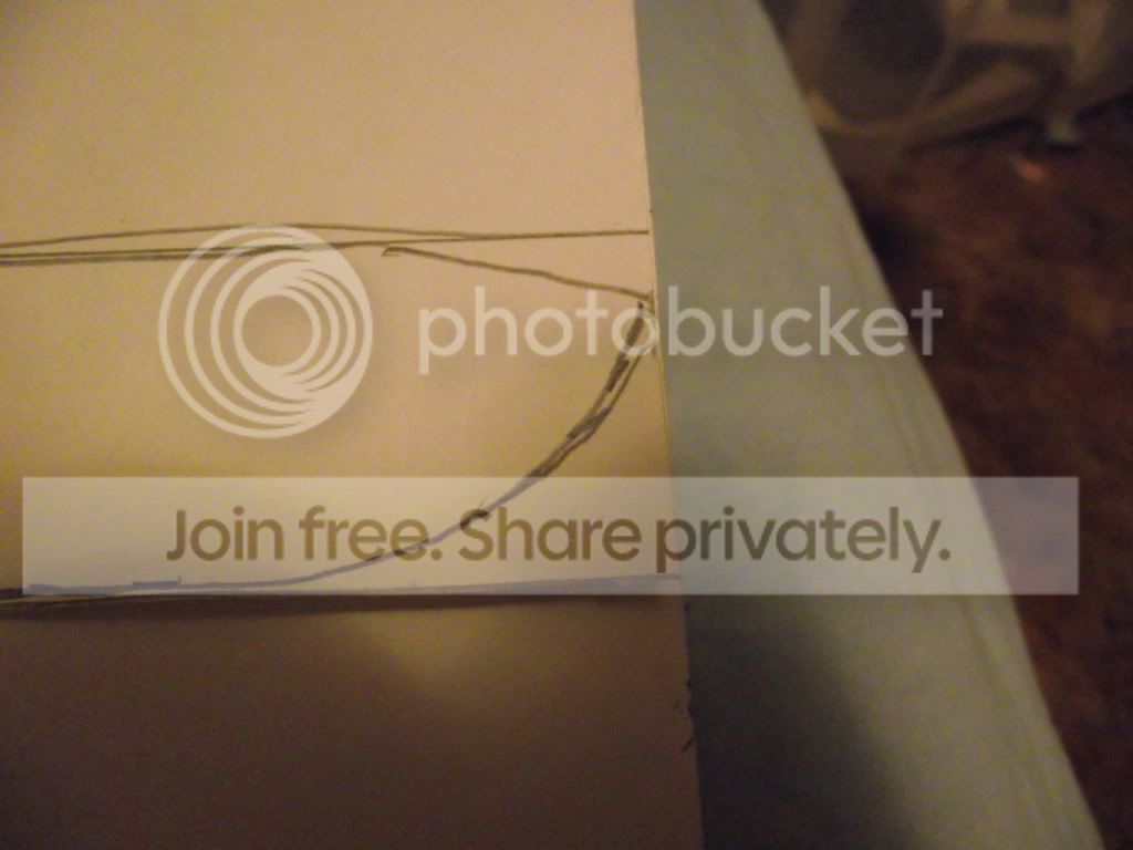

Here is an up close of the tip

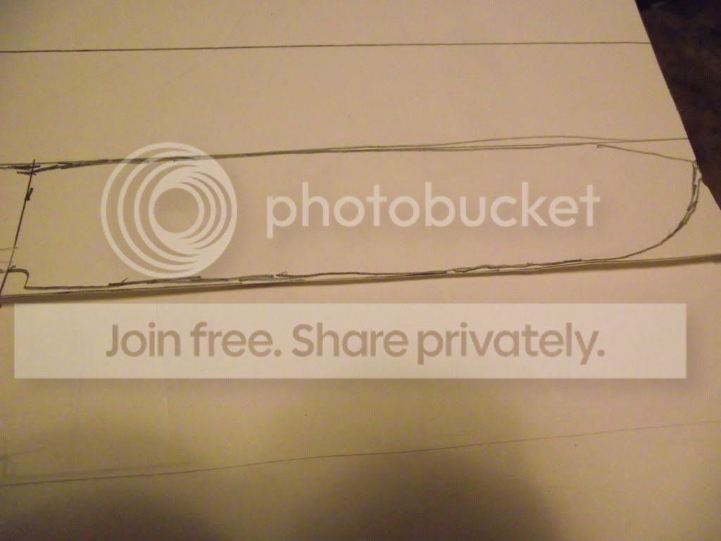

The handle is inspired by a nessuk in osage that mr. laconico did a while back. it is modified, of course. I prefer large handles where I can spread out my hand across the entire length, grab just the back, or come in close to the front, and so I want a very long handle. the most comfortable handle that i have every held is that on my ZT 0200, and the length is very similar. here is the handle.

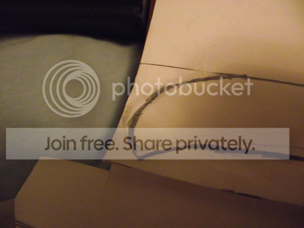

This is a close up of the end.
I am pretty much up in the air about the handle. i want the basic shape to stay, but i am not sure how thick or wide i want it to be, and so suggestions are welcome. same with the placement of the pins. anything is fine. I am not sure if i want a lanyard hole, seeing as it complicates the entire design and i am trying to go for uber simple, but i might need it at some point. what do y'all think? Thank you, and happy metal shaping.

CURVES....
I conducted Bladsmiths experiment with curves. And while still making my first couple knives will say that your design could benefit from some curves. The top of the knife is a straight line and would feel and look better with some curve.:D
Looks like you are really trying to think it all the way through. If you want a chopper, check out some of the competition cutters for design ideas.
Even for total abuse I think 1/4" is too thick for your dimensions. I have found that roughly 50:1 thickness to length ratio is a good starting point. That means 1/4" x 50 = 12.5" which is about when a knife that thick starts to look good. So 3/16 would be better suited and still plenty thick for serious abuse, if you draw the temper back properly at the spine.

Alrighty. i think what i'm hearing is that the design is fine, I should go with 3/16ths, i should integrate more curves, and that i should not try for perfection.
thickness: ok, will do. that was the original plan, anyway.
more curves: i am trying to make this as basic and simple knife as possible. the more curves i put in, the easier it will get to mess it up. i think that about the only place i would put something is tapering the handle a bit to the ricasso, and then tapering back up to the full height of the spine. just a thought.
as far as perfection goes, striving for perfection is never a condition i have struggled with. if it is perfect, it gets admired. that is why i do not own a sebenza.

I understand your desire to keep your design as is and respect your opinion. I believe what is trying to be conveyed is that if you add a bit of a dropped curve to the handle, you will find that the knife will perform better for hard work. A straight spine leading into a straight handle will cause stress and shock to your hand and wrist during use. By adding a gentle downward curve to your handle, it will be a bit more visually appealing of a design and a much better performing knife. I would seriously recommend that you study the designs of some of the competition choppers to see what I'm referring to. Believe me when I say that a minor adjustment to the design can save you lots of fatigue and pain during use later.
OK. should i have a gentle curve all the way down to the end of the handle? should i have the entire handle offset a few degrees down, Kukhri style?
by the way, thanks for setting me straight. probably would have never changed it if you had not told me it was actually functional.
Yes, you want to drop the entire handle a bit. It doesn't have to be as extreme as a Kukhri, but you want a slight degree. I apologize for not being able to give you an exact degree measurement. As recommended before, check out some of the competition chopper designs. They should be pretty easy to find.
As has been mentioned, 1/4" would be too heavy. Overkill, even for the most abuse you could heap on it.
Dropping the "axis" of the handle a little bit will also help with comfort when using a chopper like that.
If I were making this knife, I wouldn't swoop the tail end of the handle downward so much. I'd leave the top of the back of the handle straighter and use a smaller radius to start the curve. Does that make sense? It looks like having a such a narrow end to the handle might make keeping hold of it difficult when you're swinging it...as you'd be doing with a chopper.
The blade looks like it will be a good chopper, but I agree with Makermook about the handle. I wouldn't want to be standing near you when you start swinging it. If I'm understanding you correctly you want a clean looking handle. I drew the handles in the picture below. They are not examples of "fine handle design", just my personal quest for the "perfect handle". But I'm thinking that something like the third handle from the top might be something that may work.
Make some handle mock-ups with cardboard and see how they feel. Pull on the tip of the blade and see if there are any design elements that contribute to a secure and comfortable grip.

you are right. i am really liking that third handle down. do you mind if i use a mutated version of it?
Regarding 1/4" thickness....I see NO problem with 1/4" for a chopper...anything thinner and you will be chopping all day. I have made cutters with a spine of 3/8" that have won compititions. More important is getting a good grind and a thin edge.
The point on your drawing looks to me like it should be a little lower and a little longer(you could make the end of the knife blunt and it will still work as a chopper)...just my opinion on looks.
The handle...I agree the top/back part of the handle drops off too much...and it looks to me like you need more "pull"(pinky hookage) at the bottom of your handle. I have also found that if the handle is wider in the back it gives you more grip and holding power in a chop.

I do agree that a bit of a drop in the handle makes chopping eaiser. I have an Ontario 12" Cutlass Machete, it's almost straight down the spine and into the handle. It chops okay, better than shorter blades, but after a while it's not so comfortable. As a comparison, my Culberson Bolok has more curve going on. So does the ESEE Junglas...
That Culberson is forged 5160, and is 13/64" thick, a fat 3/16". I feel that if it were thicker, it would be too heavy, for me. But, it's all relative to the grind, note the Ontario machete, it's flat 1/8" thick all the way down till the convex starts. A 1/4" thick spine is okay if it's a full flat grind, that's lighter than a saber grind.
Another way to add to a choppers power is to have more weight at the tip, note the Bolok's height along it's length, gets fatter towards the tip, so does the Ontario machetes.
Hmmm. I think i will go with 3/16ths if i can get it because i do not have the ability to hollow grind the blade, and i think that that would be the only way i could get the edge thin enough. I will be revising the handle and giving it a more abrupt curve at the butt with a more gentle curve down the back, and doing 2 pins, 1 lanyard tube.
When i classified this as a chopper, i meant that it would be to be able to be abused, as opposed to a kitchen knife, which needs to slice well and survive little. if i was going for a full blown chopper, i would make this 10 inches or more. i don't think i am set up to heat treat that easily, and i am absolutely not going to pay the 30 bucks it will take to ship the stupid thing to somewhere, get it heat treated, and then shipped back. that's kind of defeating the purpose of doing it as cheaply as possible. i can get an adequate heat treat at home, maybe not perfect, but adequate. now that the rant is over, thanks all for the advice. this is really helpful.
