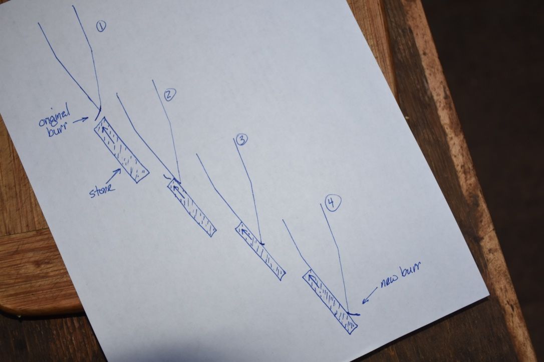

Here’s an illustration of burr removal and formation. Whenever you pass a stone over a fully apexed edge, a burr will form on the opposite side of the edge, bending away from the apex.
No. 1 in the figure below is a burr that has been formed by running the stone over the right side of the edge. The stone is just approaching the old burr.
No. 2 is the stone, now on the left side of the edge, cutting off the old burr.
No. 3 is the stone after continuing to move over the edge and starting to create a new burr.
No. 4 is the stone moving grinding still more over the edge and recreating a full new burr on the opposite side of the edge.
If you stop your stone after a very short pass (No. 2), you’ll cut off the old burr and not create a new burr.
That's a really nice illustration TwinDog. Something I think a lot of us easily visualize due to experience, but something that is really hard to explain to someone who's not familiar with the concepts. The illustration explains the process, over time, perfectly. Nice.

Twindog's approach is very similar to mine, at least as indicated in his sketches (very good :thumbup:). I don't raise the angle at all, to cut off the burr, but instead just rely on ever-lightening pressure at the same honing angle (with only the burr angled down into the stone) and keeping the stroke length to a minimum; just enough to clean up the edge. I also start the stroke at just slightly lower than the honing angle, and very, very gently pivot the bevel into flush contact with the hone during the early part of the stroke, just 'kissing' the apex near the end of the stroke. Practicing the technique with the coarsest hone is a great way to reduce or nearly eliminate burrs altogether; at least to the point they're negligible, requiring little or no stropping afterwards. Burr-removal essentially becomes automatic in the refining steps in sharpening, once you get the technique down.

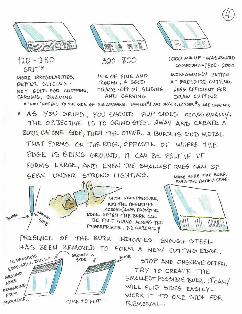

Here's the pages from my Washboard manual that deal with it. Many ways to skin the cat, but the basics are the same.
