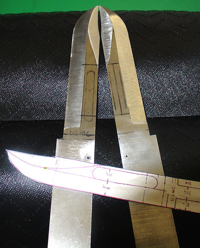

ok now its time to start thinking about a ball endmill
Dec 6, 2004
6,212
well i got most the 2 knives that need "blood fullers" :D ground out but now i have to figger out the size ball mill i need any help would be great
least i know if i get the wrong one that MSC can have another for me in a day looks like i ll need something that spans 7/16 wide but no more then 1/16 deep so i know i ll need a mill much bigger then the 7/16 but im not sure how large or how to figger it out
hoping that someone out there can get me in the ball park
thanks
butch
Have you thought about using the thick grinding wheels on an angle grinder to just grind in the fullers?
Butch, I don't know the geometry of ball end mills, but I can tell you that the circular segment described with a width (chord length) of 7/16" and a depth of 1/16" has a diameter of 0.828", if that's any help.

Here is something Mary Lou might not think of. I have to make ribs for rifles every so often and if I don't have a ball mill of the size I want I just tip the head on my mill and use a square ended cutter. You can get any sort of radius you need this way. Works for me. Good luck
that would be great if i could figger out how to get the nice round ends on the fullers
if my math is right and im not say n it is the cutter would have to be something like 3 1/8 that is if the ball radius is half the di of the mill bit and i dont thing i can pay out that kind of cash or even find something like that
goingto have to look at die grinder ball ends today to see what it might take to reshape a few
butch
I thought he was talking about using a 7/16" flat cutter end mill bit and putting the blade in legnth wise to make the fuller with the 7/16" rounded end on one end, flip the blade around to make the rounded end on the other end of the fuller.
Using a 7/8 ball end end mill and cutting 1/16 deep, would leave the groov .450 wide. If the width is 7/16, the depth would be .058..........why do the math when I have AutoCad?

nevermind....I didn't figure anything wrong after all. That said, cutters don't come in 0.828" size. :o
Fitzo's advise struck a chord with you guys.
Unless you are dealing with mating parts (which a fuller is not) just use either a 3/4" or 7/8". I would use the 7/8 and just cut to the desired depth.It will be a few thousandths wider than the design specs,but otherwise will be fine.
