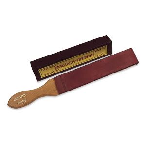

what method can be used in the field to maintain a convex edge? is there a tool of some sort that will consistently put on the proper convex edge?
A Strop
to maintain a convex edge in the field you can use a leather strop with some white rouge if the edge isnt too bad and doesnt need a burr worked up before stropping. most use a mousepad with abrasive paper attached but i think thats too soft. get a kitchen table placemat and cut it into 2" wide x 12" or so strips. then attach some 400 grit wet or dry abrasive on one side and some 320 in the other with some spray adhesive or rubber cement. you can roll this up and carry it with you.
knivesshipfree has a few of great in-field strops and a complete kit for all your needs. i use them they work great for all my barkies. think i'll convex my next izula.
