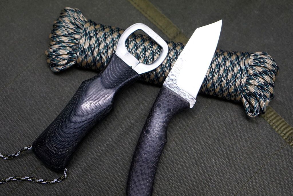

The handle design just melts into your hand and offers a couple of grip options:
From the side, this little puppy has lines that rival an Italian sports car:
Chris stacked the micarta to allow for a very nice expression of the weave in the micarta:

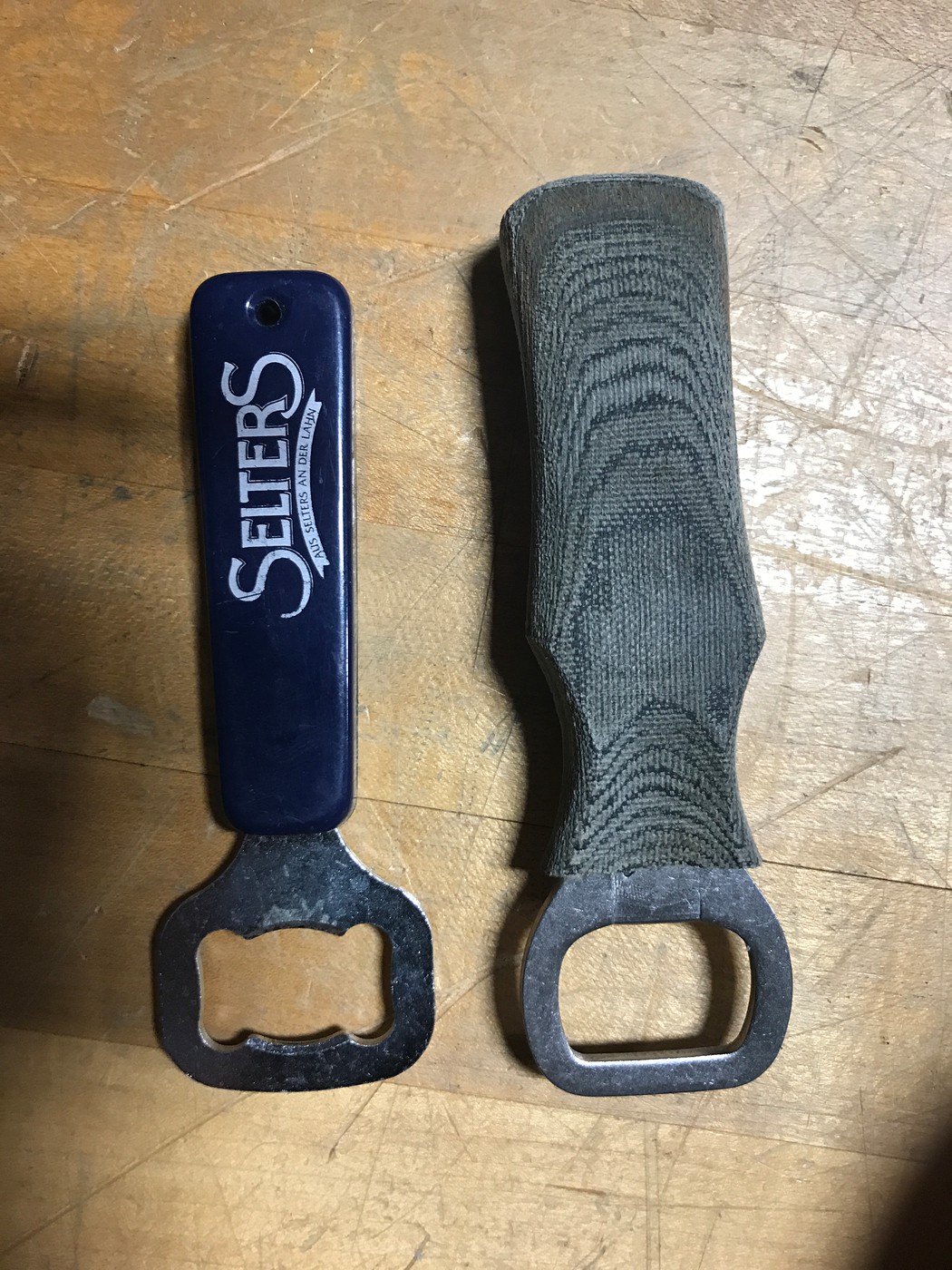

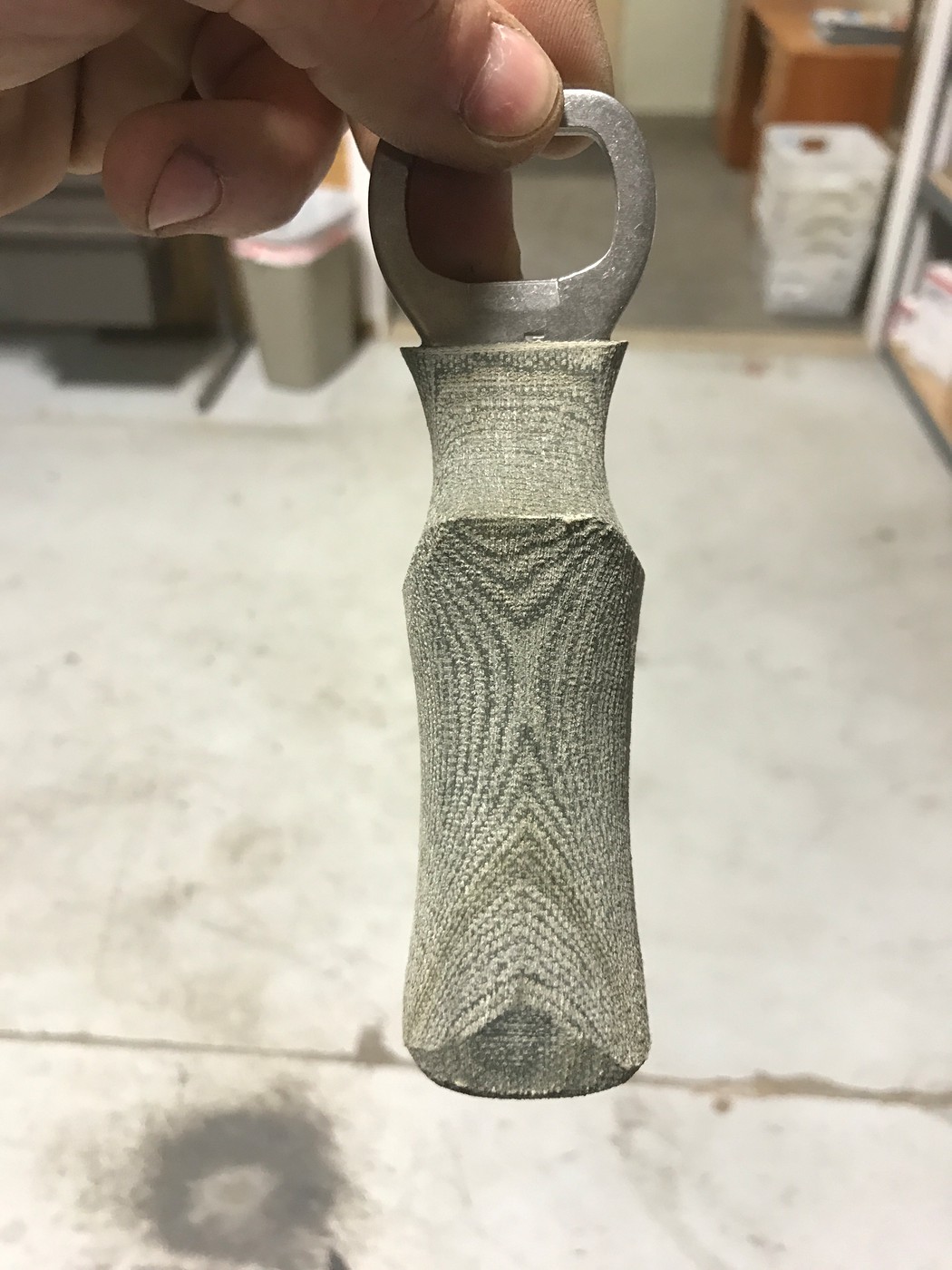

Peter came to me with a Yeti bottle opener and the vintage Micarta, and asked me to put a simple scaled handle on it for it. I don't know how many of you have met Peter but he has Large hands by my standards and I am on the cusp of an XL myself. After having the materials for a few days and mulling it over, I decided I really wanted the opportunity to create something different and individually tailored. I thought to myself there is a reason he ask me and I can do better than the simple scale on either side construction.
I had an abstract idea in my head of what I wanted to achieve, and had never constructed anything of this sort prior.
After a few weeks of going back and forth looking for sources of inspiration and a loose idea on how to execute. I decided to just go ahead and work out the remaining hangups I had with my hands. You could say there was a learning curve throughout the process.
Here are some pictures and descriptions of the construction process.

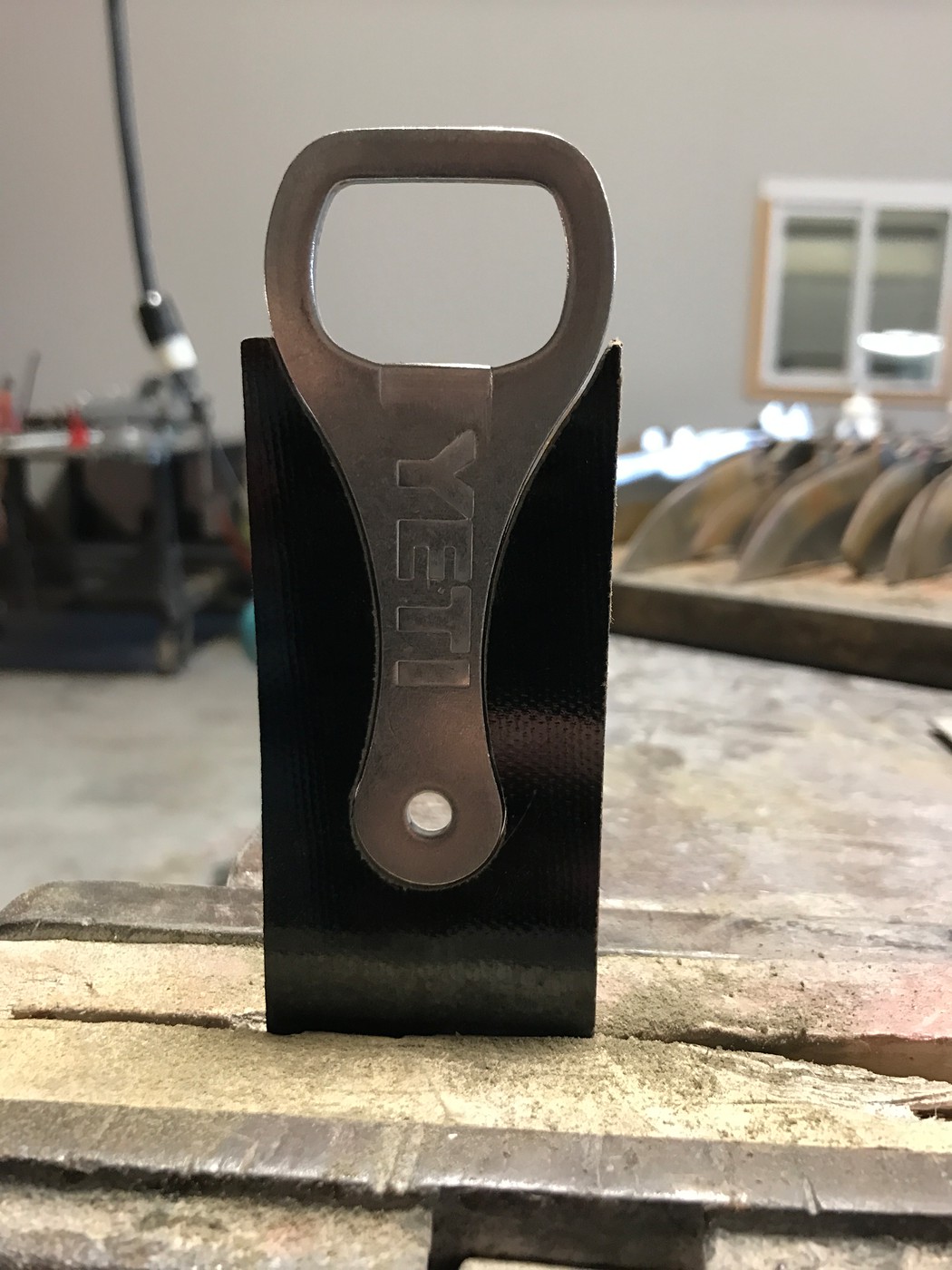

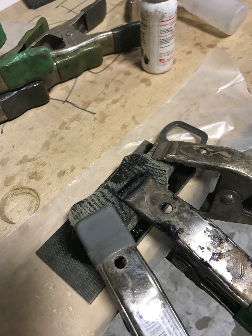

I started out making a sort of puzzle piece out of micarta for the bottle opener to sit in while I build and then sculpt the handle around it. I had to had file this piece to shape as close as I could to insure a tight fit.
Hosted on Fotki
Hosted on Fotki

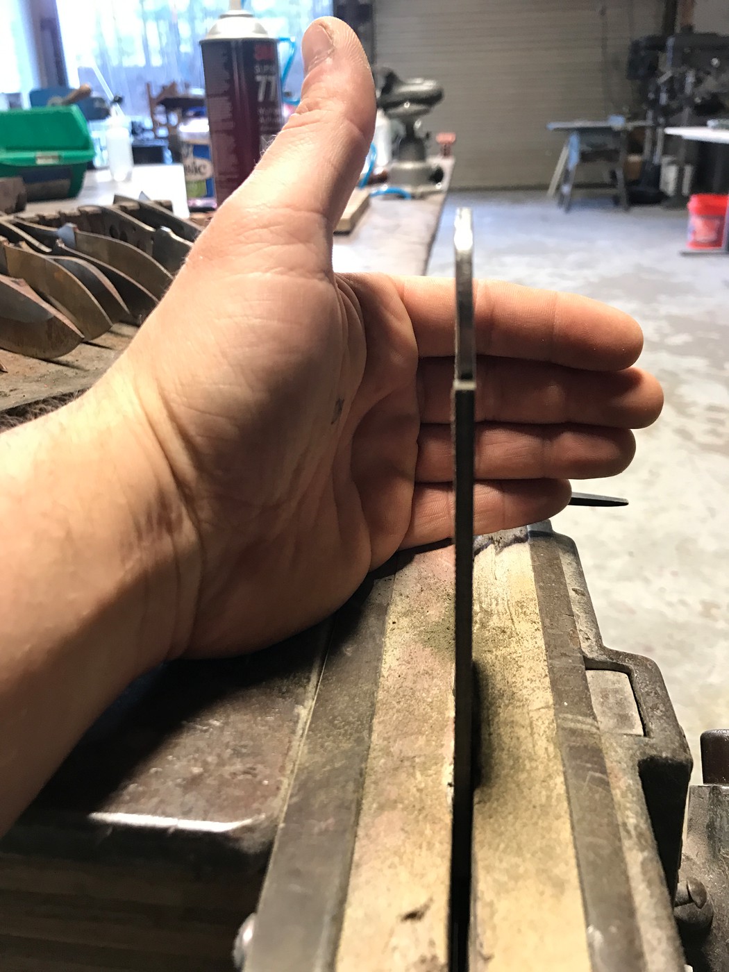

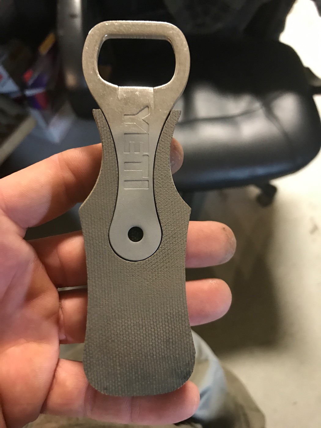

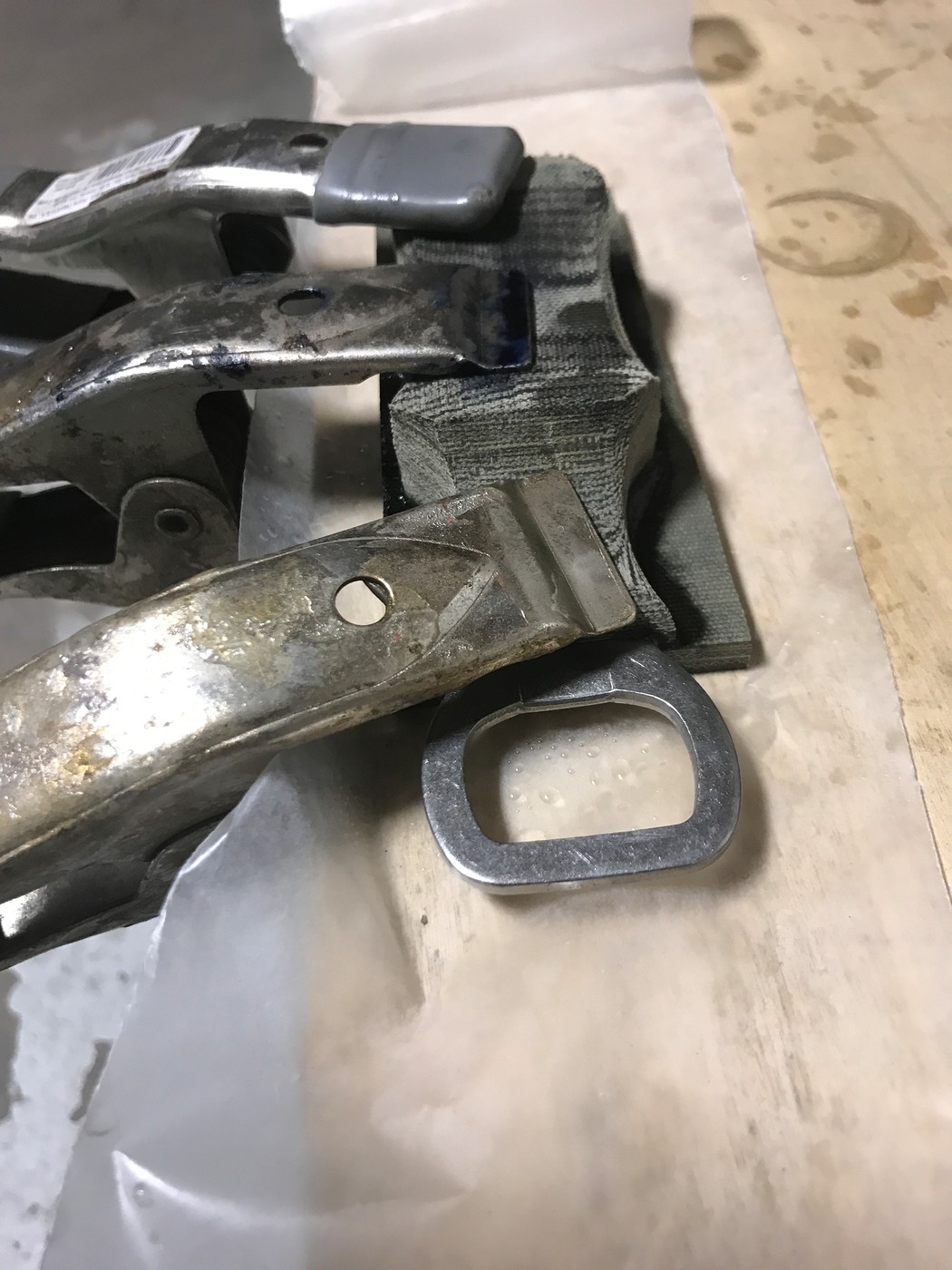

After that I laminated the bottom part of the handle to the puzzle piece, the bottle opener is not attached yet, at this point I am still working it out as I go and am not certain of my next step, it's all part of the fun in the experience though.
Hosted on Fotki

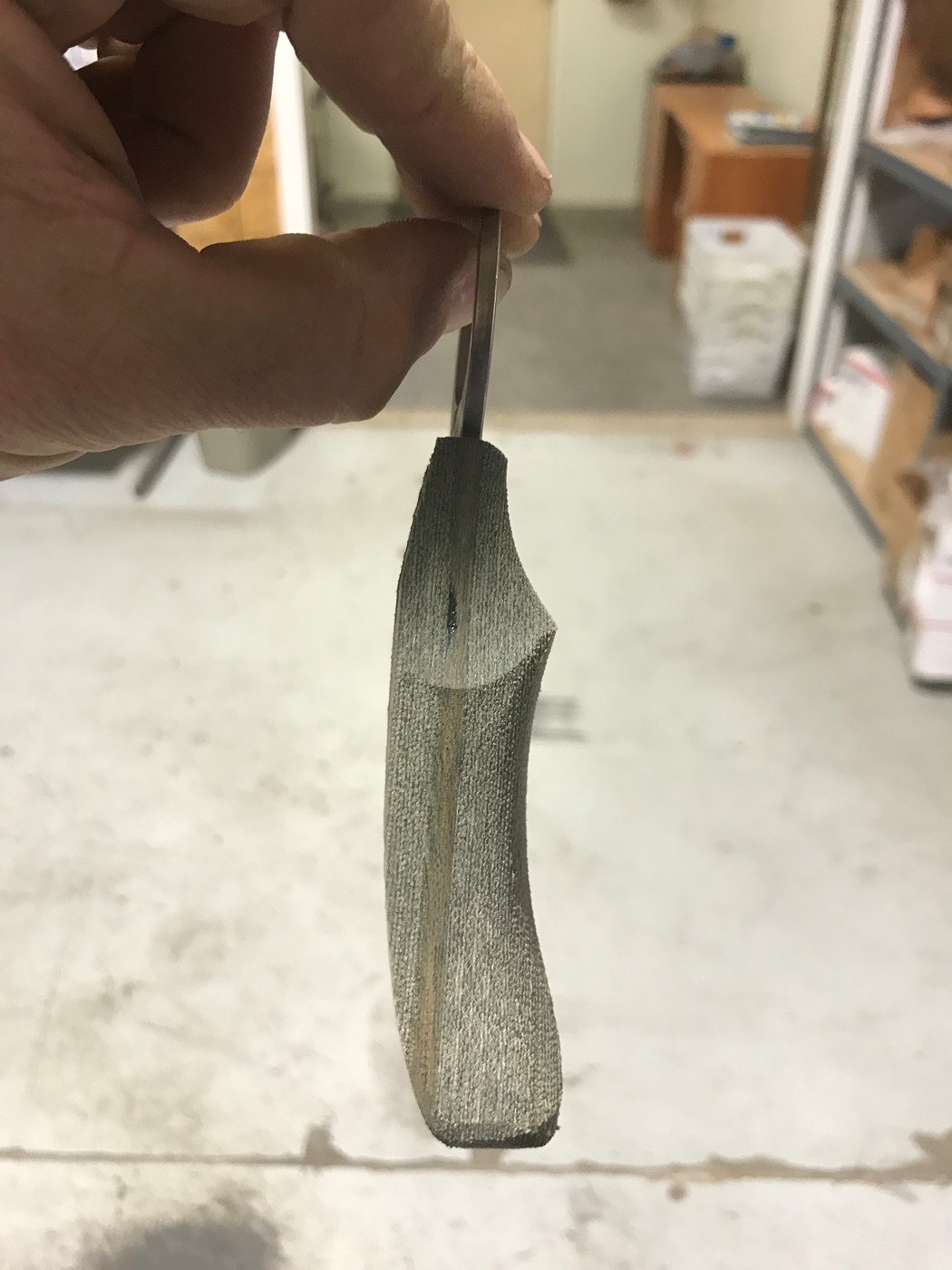

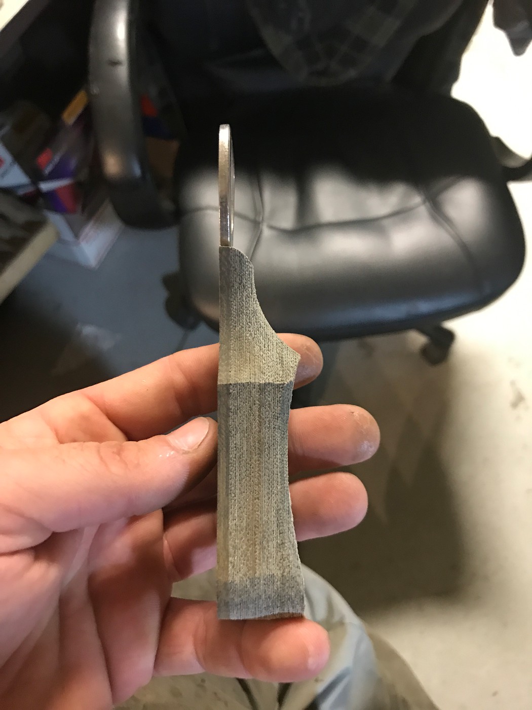

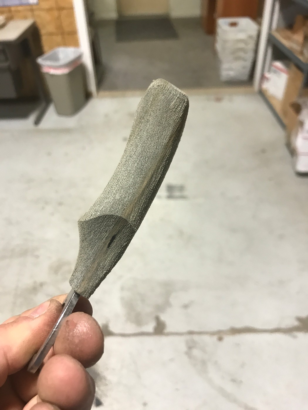

Here is a side view showing the half sculpted handle.
Hosted on Fotki
Bottom View
Hosted on Fotki

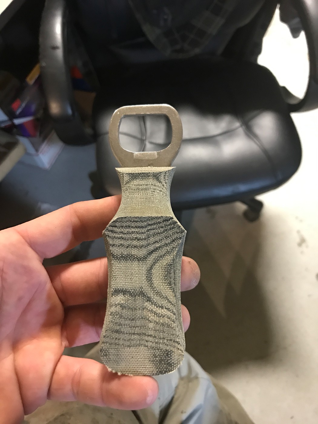

Next I glued the top scale on with the bottle opener permanently seated inside the handle, I also would like to mention there were absolutely no pins used or harmed in the production:D of this project, LOL!
Hosted on Fotki
Hosted on Fotki

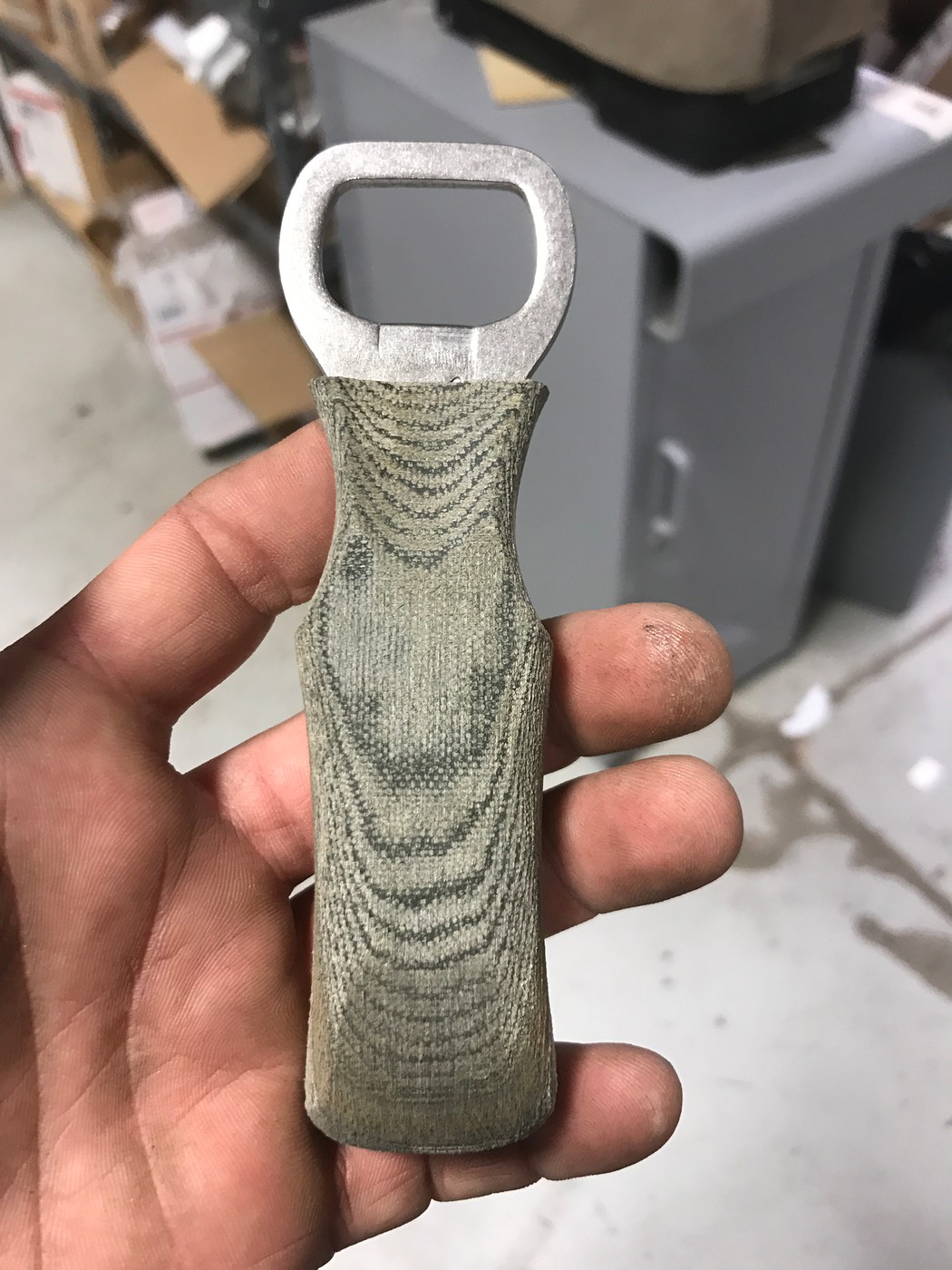

After that I started the final sculpting which ending with a good bit of handle filing to smooth out the final shape, the pictures below are of the bottle opener rough shaped.
Hosted on Fotki
Hosted on Fotki
Hosted on Fotki
Hosted on Fotki
Hosted on Fotki
