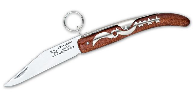

Guys I have a new Okapi ratchet knife and it came as sharp as a dollar store butter knife.
So I took my Spyderco sharpmaker and tried re-working the edge with the diamond coated rods @ the standard 40 degree bevel. Did about 50 strokes per side. Didn’t seem to sharpen much so I switched over to the 30 degree side and did maybe 30 strokes per side, then went back to 40 degree and did about another 50 strokes per side all with the diamond coated rods.
Well I then went to the brown medium stones and after a while on those at 40 degrees, I went to test the knife on a thin cardboard TV dinner box and it cut WORSE than a dollar store butter knife!! :eek:
Needless to say, I’m doing SOMETHING wrong!! Guys please help me get this African wretch to a passable edge!! Thanks in advance, Mitch

You can not sharpen Okapi new out of box with sharpmaker.These thives come without edge out of factory and have to be thinned out behind the edge and reground to be efficient cutters and for you to be able to touch them up on sharpmaker.You can do that on rough sil carbide or diamond stone,or belt sander.I did mine on beltsander and now it is hair whittling sharp and excellent cutter although edge holding could be better but its easy to touch it up or strop it.Id put it flat to stone first to thin it out ,then make secondary edge and sharpen it.Opinel is much better choice than Okapi for same price,or cold steel kudu,but nevertheless theyre ok knives once you regrind,light to carry and good for edc.

Norton economy sil carbide stones can be bought at home hardware for cheap,use that to thin it out and reprofile,then sharpmaker to get a micro bevel on it.Grind on stone untill you get the burr on both sides.I thinned mine a lot on belt sander,then polished the sides on waterstones and strop and sharpened it on sil carbide medium,cuts like crazy now,their out of factory edge sucks as theres no edge at all lol.Have another okapi,keychain knife,similar thing,have to put it on beltsander,its sharpened on sharpmaker,it cuts paper,but the bevel is simply too thick almost equal at top and bottom lol.once you regrind them theyre ok knives,i order them online so couldnt see them in person,but some of them are better than others,have other one nib that has decent edge and better quality overall.
These knives as they come out of box are too thick behind the edge and dont have actual edge on it lol.Even if you got the edge on it now,my sugestion is to thin the primary grind on stone too,then it will be much better cutter.
Thanks, all. It does not appear the edge is so sharp as I first imagined it was. I’m going to buy a coarse stone and try and thin it, as others have suggested. Kind of a pain in the neck, these are $15 so the same price as an Opinel (which comes wickedly sharp) yet has a butter knive’s edge?? Hrrrmmmm.....
