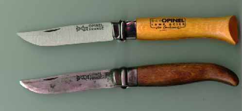

The Opinels have excellent blade geometry, and usually better edges. The frictin fit can be a problem. In damp weather the knife can be difficult to open. After much use it can become too loose, and open up in your pocket, which is a hazard. I've cut myself this way. This can be cured by soaking the handle in linseed oil to swell the wood a bit. You don't want to use water for this, because the wood fibers will swell and crush, then will be looser than before when it drys. I've also seen folks drive small tacks in the end of the handle to tighten it up.
I carry both brands (not necessary at the same time), especially when in period attire. Both get modified before I carry them. The Okapi just needs to be sharpened and tightened up if necessary. The Opinel gets the handle reshaped. (See the image) This actually takes a lot longer.
