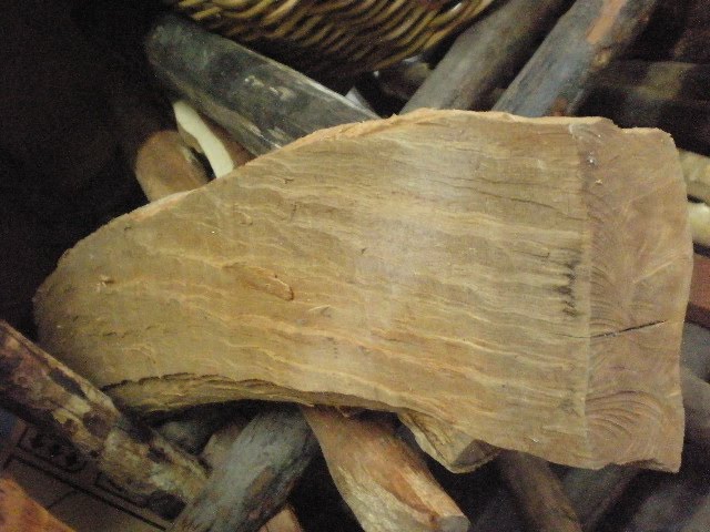

.. And I went to his house bringing along the template of it early last month Nov, 2013 ..
In the following picture the template was seen lying on the yellow plastic basket just beside another template of another large knife.
And at the same time I collected my newly built SOD :cool:

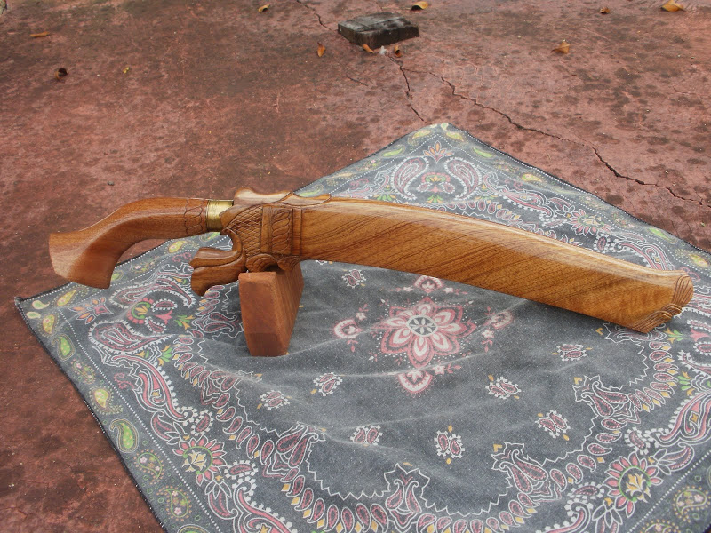

Here is the sample of Serian wood as a hilt of a large knife.
Notes: This is Jay's NMAOK as was shown in thread The cleaver discussion thread

Here is the picture of a raw Serian wood.
And here is the picture of a finished Serian wood as a handle and a sheath.
.. I would stabilized it or at least treated with linseed oil ..
O'Katz doesn't do wood stabilization so he'll just apply beeswax to the wood.

The latest good news is that O'Katz found a couple of large Serian wood scales in his keeping.
O'Katz said:
.. Just when you thought you have used them all up. Suddenly these two pieces of beauty turned up from the bottom of the barrel.
I love this sort of surprises ..
Oh .. how I love this sort of surprises as well :D
So IMO the Serian wood handle will be glued, fixed and shaped before end of this week ;)
