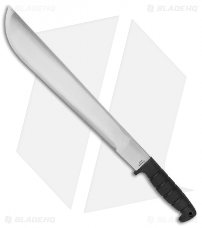

I'm not trying to make you drool, but if you like 420hc choppers, then this thing wins (imho)... SP-X
don't get me wrong, I love the wood handle of the woodsman, but this is the n'th degree ( 15 inch blade, 20 overall )
