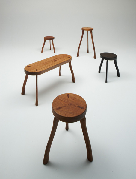

There is always the option of using them for something else.
yeah, would require a lot more axes than I currently have
but there are many days in a year! hadn't ever thought of
re-purposing like that I was stuck thinking axe handle!
I try to save as much of the handle as I can (assuming it just can't be reused), and I save those "discards" for use on smaller axes and hatchets later. I've been able to repurpose several mangled-up-top-but-otherwise-nice old handles that way.
