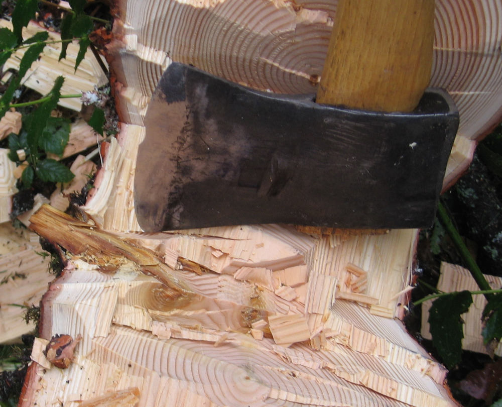

Chopping spruce knots (or hemlock knots: shudder!!) at low temps is about as tough of service as an axe can experience. You definitely want a little softer steel for that work. See a recent mishap I had.....
