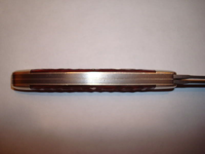

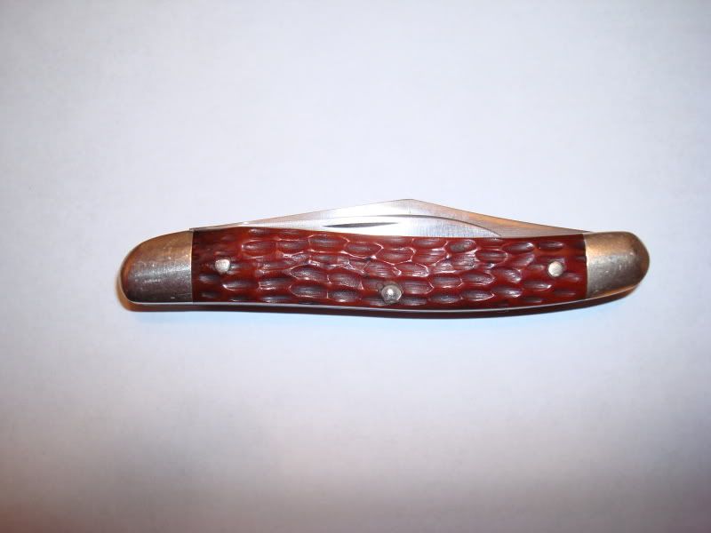

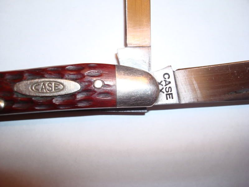

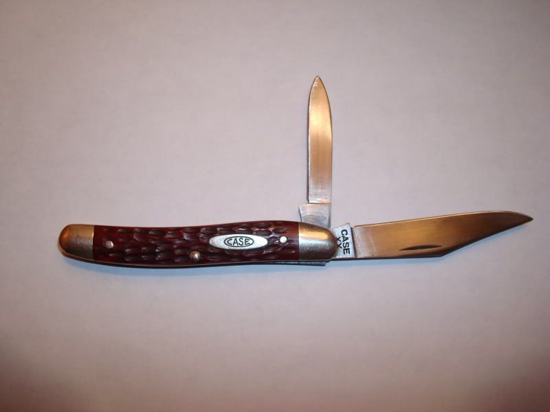

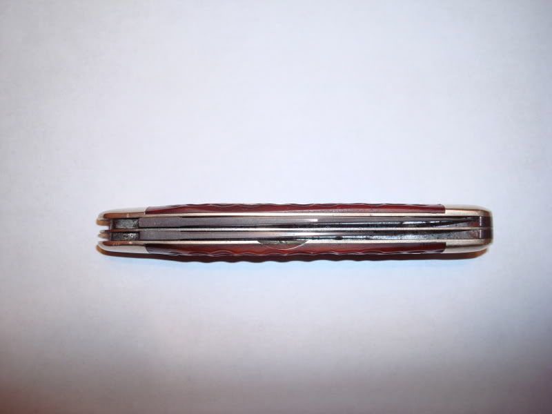

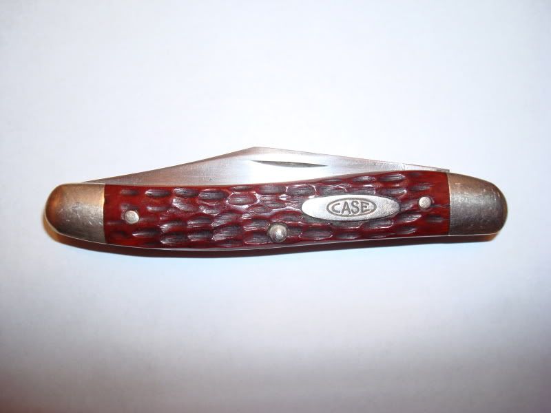

I put this in my pocket a couple of days ago. I am going to carry it for a few months. It is a beautifully made knife. The fit and finish are supurb. It rivals some customs I've seen. I found out that it was made between 1940 and 1954. It's called a Serpentine Jack. It's a bit bigger than the Peanut, just what I wanted. The spring tension is great, the bone is a perfect fit (and I mean perfect), It looks great also. I wonder how the steel compares to the modern CV. It is defiantly one of my favorite knives. I needed money and had it up for sale a couple of times..... I'm so glad it didn't sell! I love that the shield is double pinned on. :cool:

How do you know the shield is double pinned on? I am just curious.
Thats a fine lookin old Case... Gotta love the older red bone.
I may be mistaken, but I have a feeling the double pinned shield he referred to, was the two total pins, one on each side of the shield

Thanks for all the great replies! That is a great little excerpt on old and new carbon steel. I love the Case CV, the newer is quite a bit harder than the older. You can see the duel pins (one at each end of the shield) on the inside of the knife. If you look hard enough you can see the pins on the shield also. I would love this pattern in newer CV for sure. It would be easer for me to use also. It is the perfect pocket size and weight. Thanks again guys!
