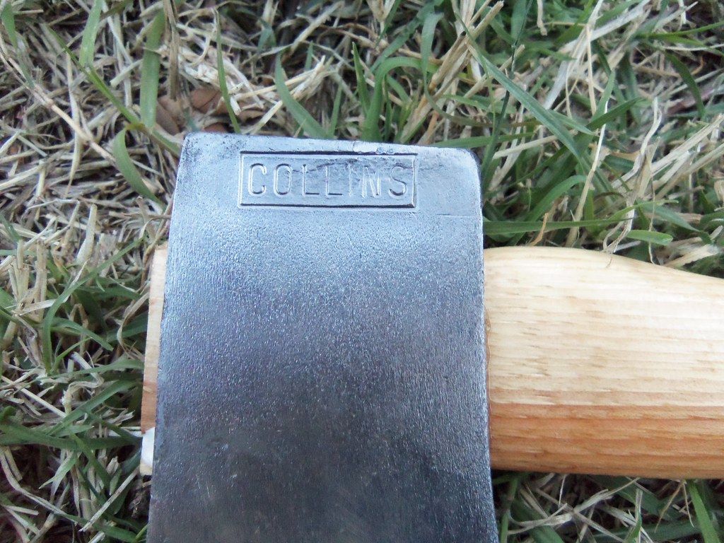

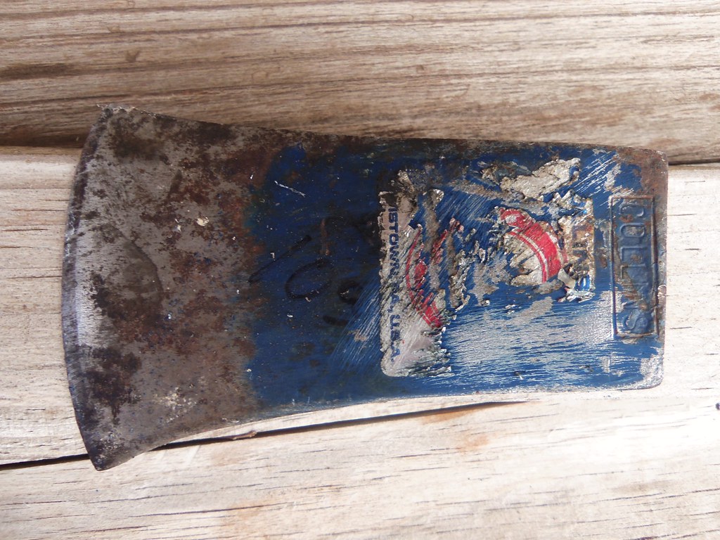

Hey folks, Well I was finally able to get my hands on an old Collins hatchet. I've always wanted one of these hatchets as I like the thin cheek profile and lately I've been wanting to carry an older USA made hatchet rather than a swede. So here we go.

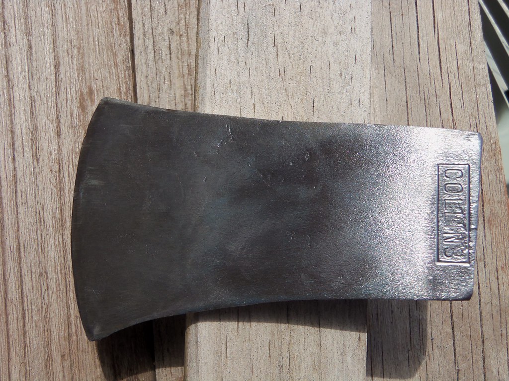

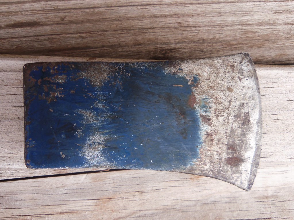

Here's the head as I got it. While dirty it looks hardly used. Edge and poll were in great shape

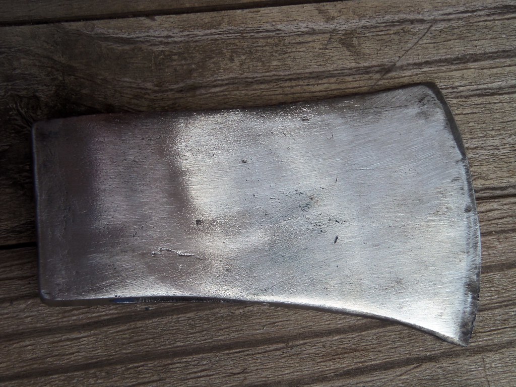

cleaned up

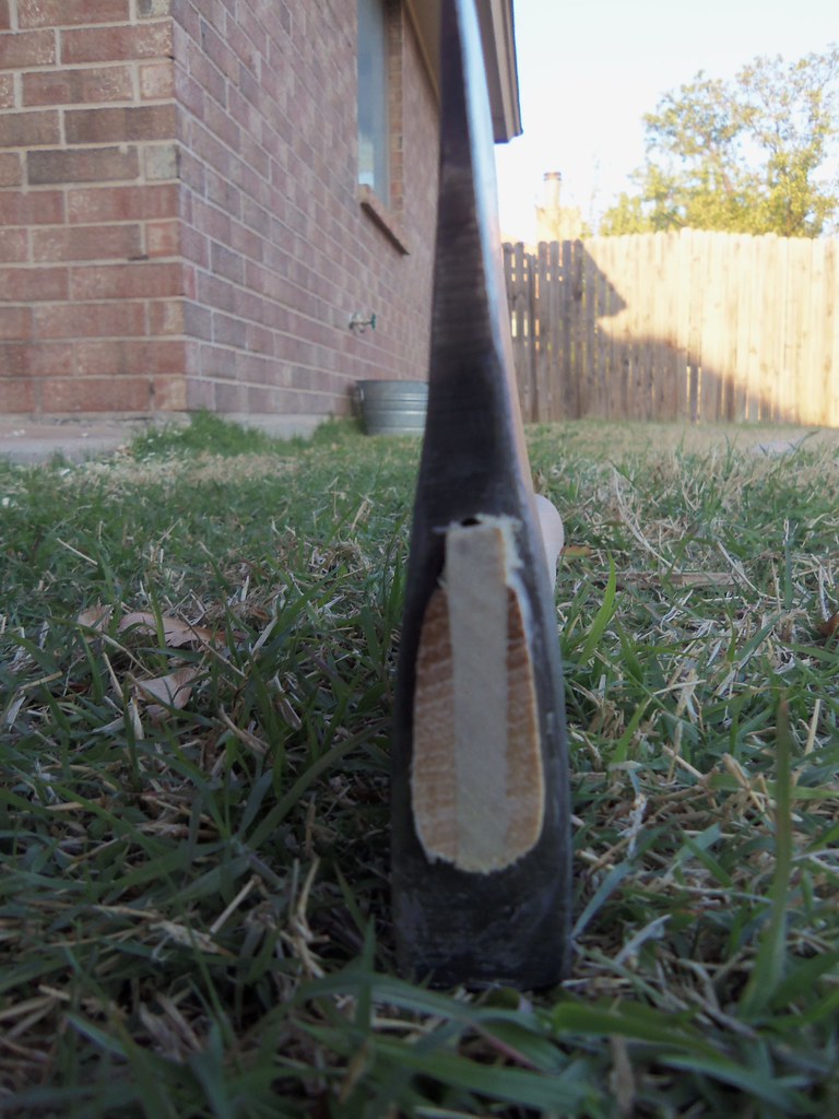

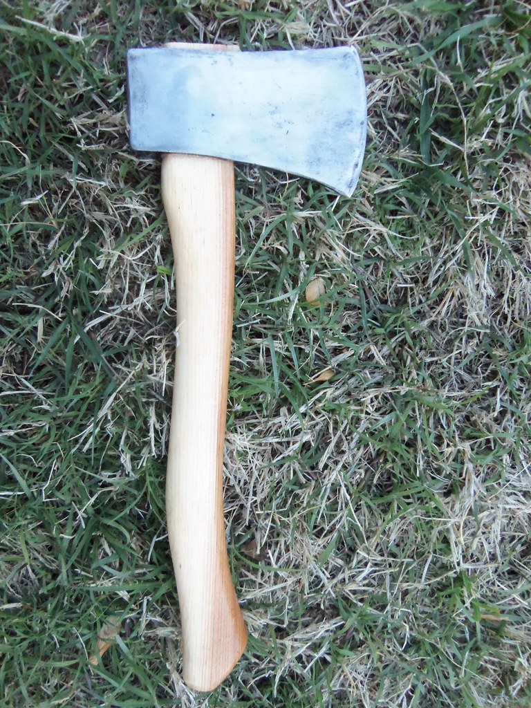

this is about half way through the fitting

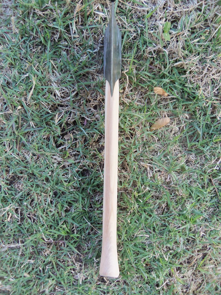

the eye on this head was very small and took a lot of fitting. Finally got her hung straight and got the neck and shoulder thinned out for a smooth transition

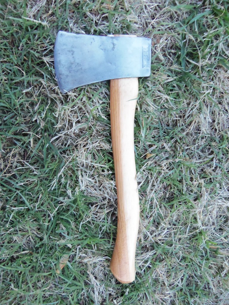

and after a couple coats of BLO
Well I recently sold off my swede as the American now has the spot in my bag. Gotta love the USA stuff
thanks for looking
The sapwood rule, and it is not universally accepted it should be pointed out, is that when using hickory for a handle the whiter outside wood of the tree is preferable to the hart wood.

I was aware of the grain alignment and hartwood when I bought it. It was the straightest and most evenly shaped of the options. It's a 14" hatchet, pretty sure it won't be swung hard enough to notice the difference...

I'm with Peter vido on this, regardless of this "rule", I don't see that a 1 1/4 head / hatchet is going to see much abuse that would cause some sort of failure.

Nice to see a head that hasn't been pounded with. Is it a 1 1/4 lb head? What brand haft? 14"?
Nice job on the transition, good proportions.
Thanks filedog, yeah 1 1/4lb head and 14" Link handle. I wouldn't buy Link handles unless you can hand pick it though. More seem to have unacceptable flaws then not, but the wood is very dense and good from my experience.
