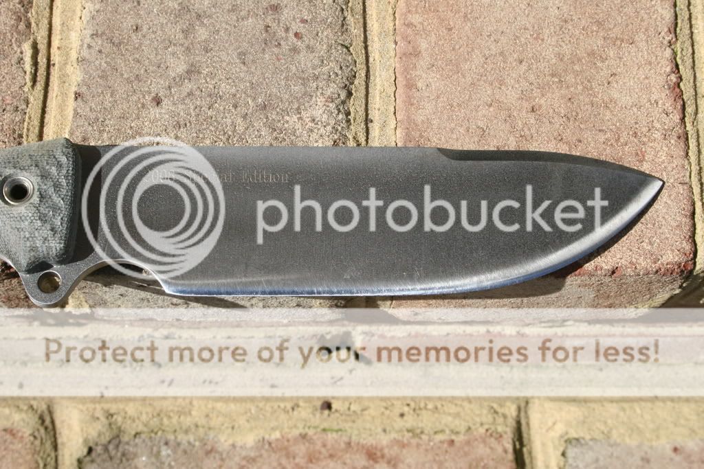

This started out a week ago as a review. You know -- big chopper plus general camp knife -- in this case, CG NMFBM and Comp Grade SARSquatch (Special Edition with the great edge).
The knives have worn me out. And they're still about the same.
Here's where they started:
Don't worry about that bit of rust on the 'Squatch. It's Comp Grade and that just doesn't matter (it's decarb related anyway).

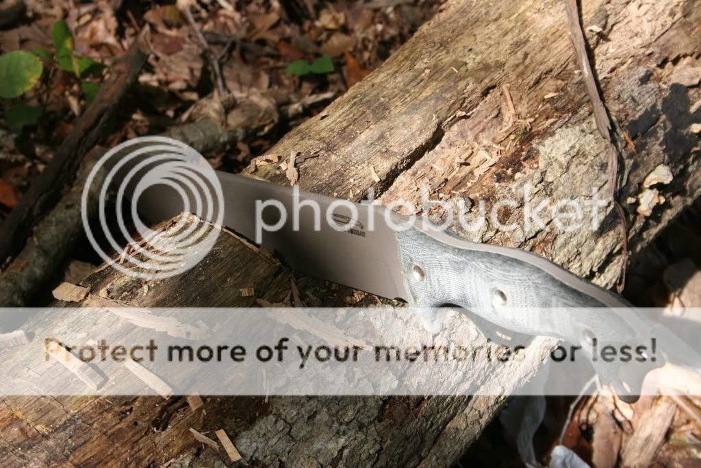

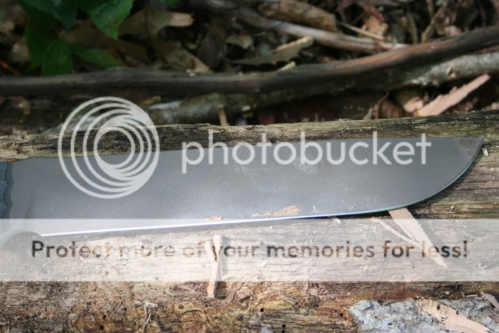

Here's 50 chops in:
Then, 100 chops in:

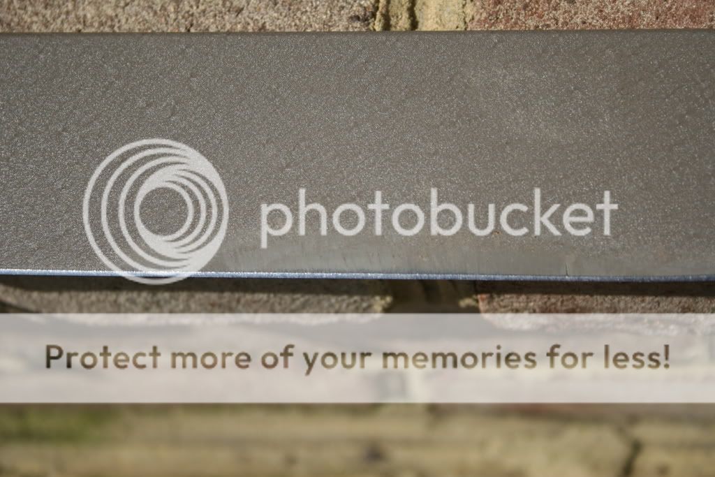

Frankly, this did nothing to the edge at all. The coating is just a bit smoothed:

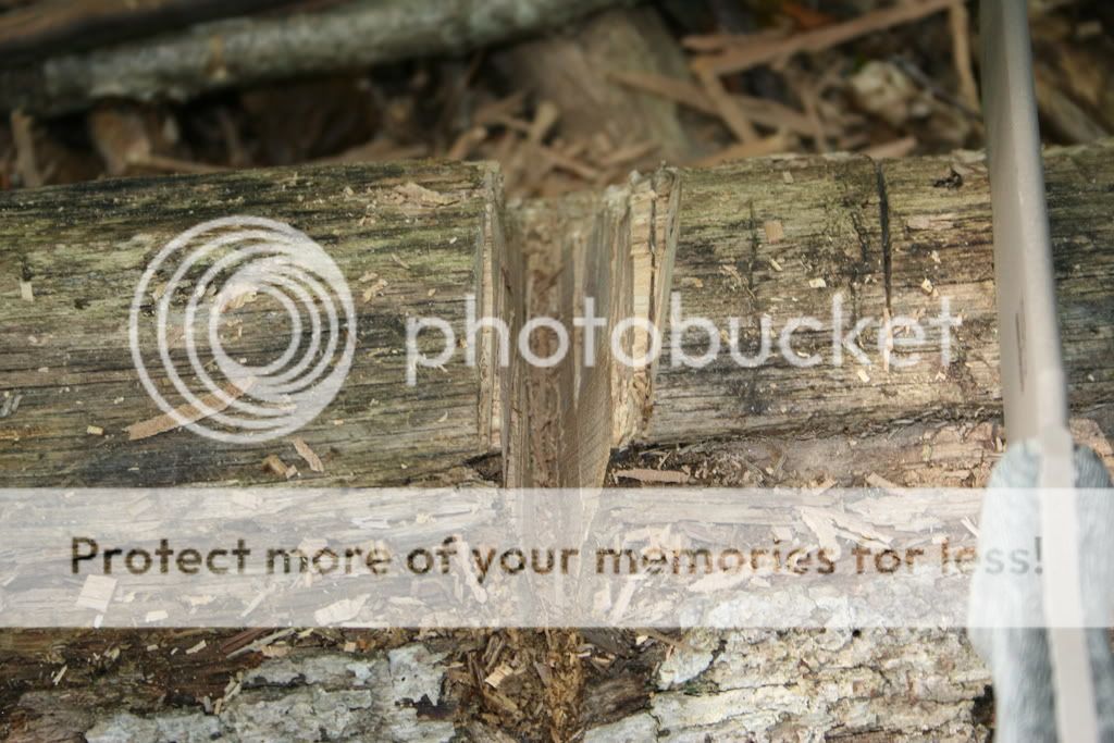

I alternated angles, chopping slight right then slight left. After 120 chops, the cut looked like this:

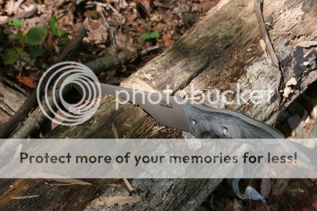

Not to forget the SARSquatch, here are 25 chops:
Please keep in mind that the 'Squatch is a camp knife, not a chopper -- although it really does about as well as my Chopweiler (Ratweiler is a bit better). Also, please remember this is very hard wood.

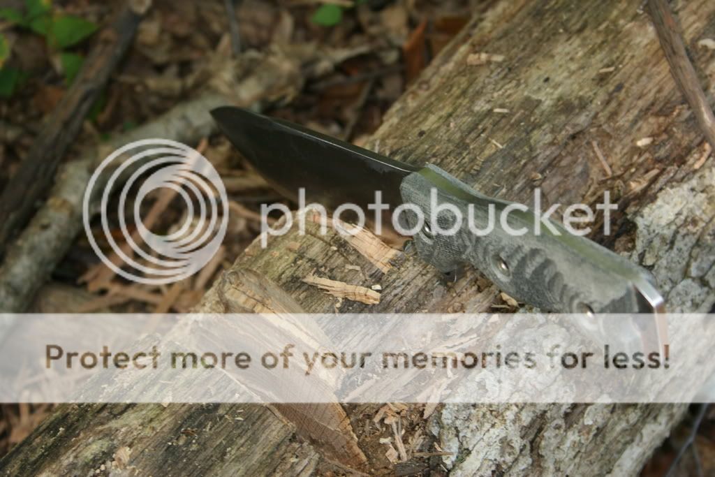

That was a good start. I kept on in a similar vein, chopping various forest woods, some free hanging and some fallen. Here's the NMFBM after about 250 chops:
I'd show you the NMFBM after 800 chops ... but the doggone thing looks exactly the same!! Very irritating. :mad: Previously, I've been able to seriously peel away Busse coatings well before this point. I've ruined lots of black coatings this way ...

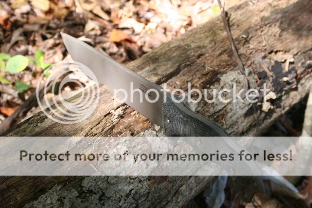

Here's the SARSquatch after about 400 chops:
If you look closely, I think you can tell that I've removed some of the decarb from the sweet spot and off the tip. I've also managed to add some vertical scratches to the polished edge. The edge still shaves hair off my arm, by the way.
So. I can't even press on to more sophisticated cutting tests yet. I haven't managed to really dull or turn the edge on either knife. :mad: The coating (Sage) just smooths out ... haven't really removed any yet.

i would go in at a wider angle.the gap you've made looks to be about 2 inches or so.general rule of thumb is to make the gap as many inches wide as the tree/limb is thick.
so if its a 10 inch thick tree widen that cutting area out to around 10 inches and you would've been through it already.

2) Northern1 is of course correct. I should have widened out my cut so I could chop free bigger chunks of wood. I was actually a bit surprised to see how deep I could get with such a narrow cut. When I return ... tomorrow ... I'll widen the top and see if I do better. I'm going to avoid batoning at this time.

I'd expected to fairly rapidly wear away coating, much like Northern1 did. I think this Sage coating is tougher than expected.
