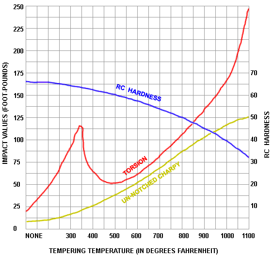

Some say over 62 is realistic but most say the edge will chip unless it is kept to below 58C
Who says this, exactly? 1095 is tougher at 62 than it is at 58.
As for Old Hickory, I have no idea how hard they run their steel, but in my experience it's softer than GEC runs theirs but overall just fine for their intended purpose.
This goes against all logic. Where did you get the values that show that?
Here is the figure I'm used to seeing, but now I can only find a very low quality version (you can still read the text if you look closely enough):
Here is a reproduction that's easier to read and has the same info:
I am no expert but the folks at Becker, ESEE and plenty of other places are. They run their 1095 lower than 62 and I'm pretty sure it's due to toughness.
After looking at that graph again, I stand completely corrected and the experts show why they're experts.
Graphs like that are wonderful items, but it would be nice to explain what it all means relative to the subject matter.
It graphs hardness and two measures of toughness against temper temperature. Basically the Charpy and torsional impact values (different measures of toughness) tend to increase as HRC decreases except for a big spike in torsional stability around 68HRC. I apparently remembered the graph incorrectly. The torsional stability values aren't all that much different but the Charpy values are significantly higher at 58HRC vs 62HRC.
I think what must've stuck in my head was, "big peak in torsional stability at 68HRC" and "1095 retains good toughness into the low 60s" and over the years it got a bit distorted.
Ok, maybe I am reading this wrong but at an Rc of 63, the Charpy value is 25 ft lbs, while at an Rc of 57-58, the toughness is 52 ft lbs or double which is logical. So from how I am reading that chart the toughness goes up as the hardness goes down which is logical.
That's also how I'm reading it, I just hadn't looked at it for a long time and didn't remember the significance of that peak in torsional impact toughness around 68HRC.
ok, got it. I like that graph, shows a lot
While it is sometimes counter intuitive, lower hardness does not indicate higher toughness. Various forms of temper embrittlement see to that. The graph above is specific to 1095, but the same trend is fairly common in the tempering range for cutting tools and knives. What that graph shows is the tempered martensite embrittlement in the lower range of tempering temperatures. ESEE tempers high enough to avoid it, though the hardness is lower. A handful of makers temper at or near the peak, and have a higher hardness than normally thought adequate. What the graph also shows is the lack of sensitivity of the Charpy impact test at detecting the embrittlement in high carbon steels tempered for cutting tools. As carbon goes up, toughness goes down, generally. As the toughness goes down, these variations become more difficult to detect, and different tests become preferred.
