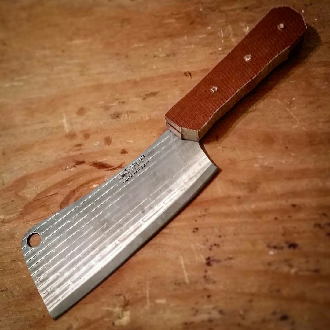

Obviously, the handles weren't designed for the types of use that I put them through, so I don't hold it against the knife at all. I have other Old Hickories (Hickorys?) in my kitchen that have held up fine for years. I still like how it performed though! Once I get some new handles on it, I see it having a permanent place in my camping box, partly because it works, and partly for the cool conversation factor.

Making a bit of progress on the re handle. I also modified the heel of the blade to better get your fingers behind the edge for wood carving.
Micarta is rough cut and I drilled the holes out to 3/16 to accommodate the pin stock I have.
Next up, cleaning up the front end of the scales and epoxy!
Toooj will remind me that this is considered abuse, I know. But I am one who likes to know my blades limitations, LOL.
