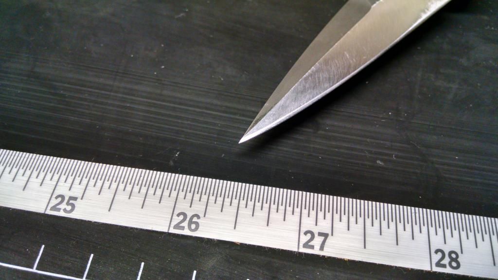

Here's a CTS-XHP Military I did freehand on waterstones, then finished on a strop:

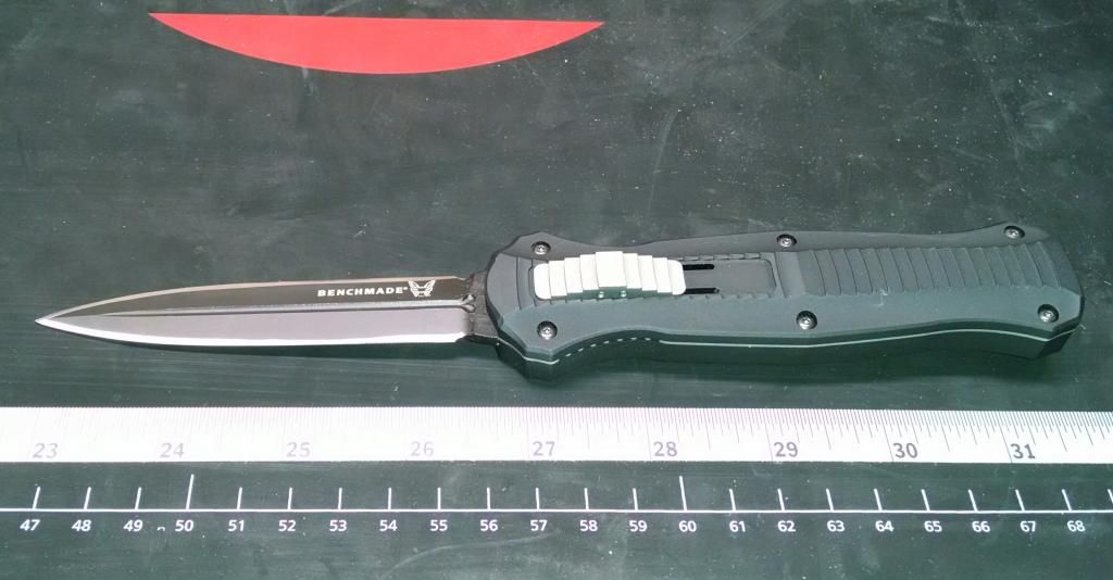

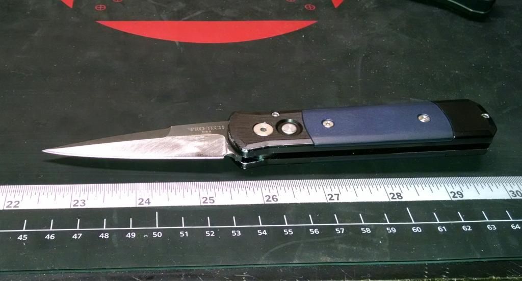

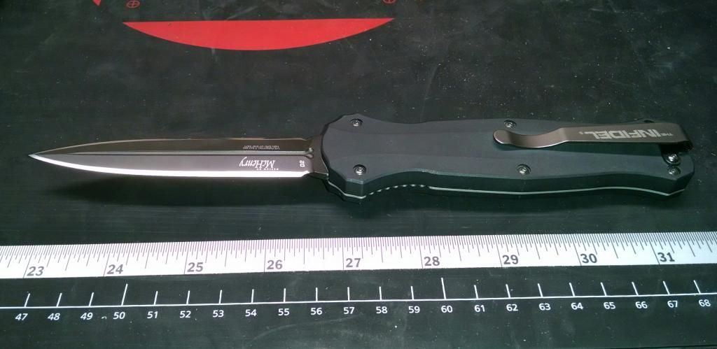

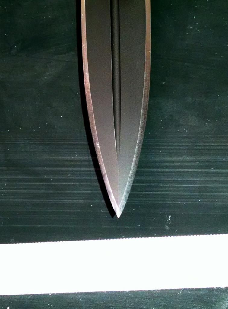

Here are a couple freehanded edges on fairly $$ knives. My EDC ProTech Godson (was DLC but I wanted a thinner blade behind the edge so I thinned it, which removed the DLC there) and my Benchmade Infidel, which I completely reprofiled from a chisel type grind to ~35° inclusive.
These were both sharpened/profiled on a DMT coarse then micro-bevelled on a 1,500 grit Suehiro and stropped.
