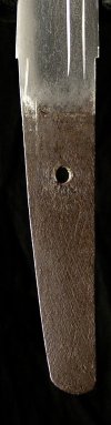

The tanto is signed Kanetoshi.
Nothing is absolute and this is merely my opinion based on a few photos, as such my assessment is based on probabilities, opposed to absolutes,
Note that the following information is assuming that the mei (signature ) is legit.
There were many mei faked, though with this being an uneventful and possibly undocumented smith, the probability of this being gimei (fake) is low.
Occasionally the last character is read as Chika, but there are no Kanechika listed which use that character for chika, eliminating that possibility or, making the probability very, very low (there were undocumented smiths).
There are 2 smiths listed who used this combination of characters for Kanetoshi which were Sue-Seki smiths from the Momoyama period (late 1500's).
A few things seen in the blade coincide with that time period while others are questionable.
The Yasurime (file marks) seen on the nakago fits as does the hamon (temper line).

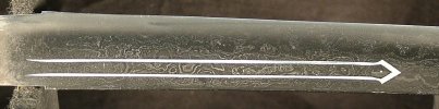

The jihada (grain in body of blade) on the other hand does not look like typical Sue-Seki hada at all, but more like a Shinshinto Muji hada.
I reiterate that I am basing this opinion on one less than optimal photo of a poorly polished blade.
I am including photos of a tanto from the same period and same area (Mino/Seki) in order that you can see the similarity of the yasurime and the difference in the hada.(see below)
