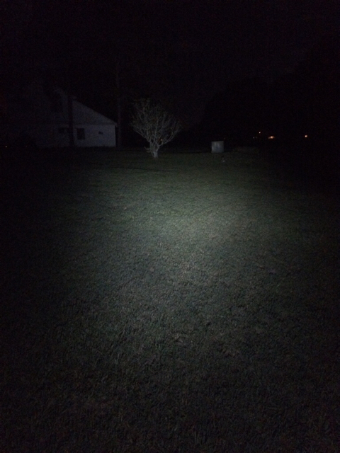

Beam shots if anyone is interested. The first picture shows a palm tree at 3 yards on low, the second shows a large tree at around 8 yards in medium and the last is a fig tree at about 25 yards on high. It is very floods, no defined hot spot or rings.
Nice sir, are those outside shots, and those are at the 220 lumen setting!
