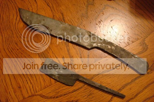

On the bench, rough forged, and ready for grinding.
Small japanese style razor.
and
a recurve fighter
What kind of wood should be used for the recurve's handle? Thoughts?
Got to work on them some tonight after work. The fighter is partially ground, and a change of plans has been made. I am not leaving it rough ground, and I plan to give it a hamon, and I'm thinking some kind of sleek black handle material.

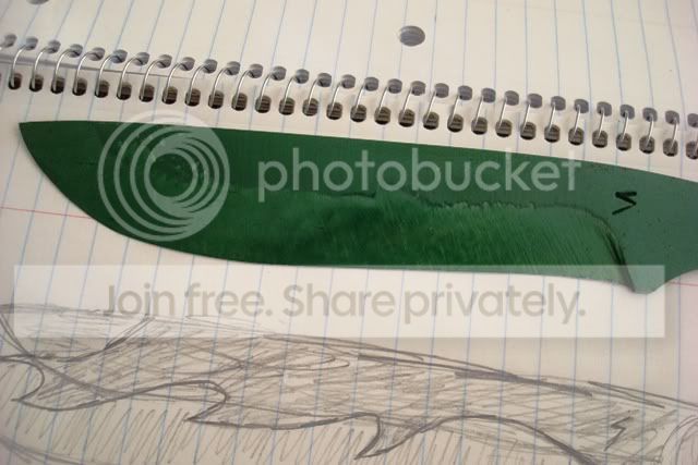

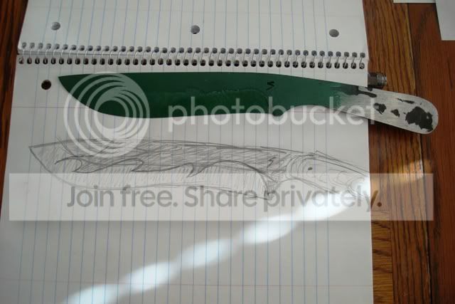

Here's the recurve thus far, and yes, it is coated in green spray paint. When I'm grinding bevels I like to spray the blade with paint, let it dry, then grind, then I can see right where I'm hitting it, and where I'm not.

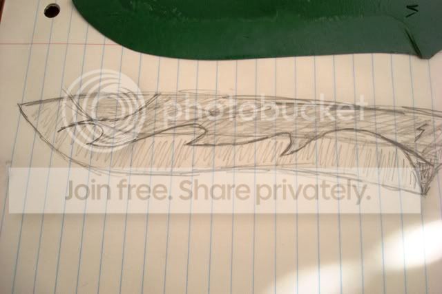

With it you can see a sketch I did of it, with an idea for a hamon. I want some kind of hamon running down the blade like a flame. And I'm thinking buffalo horn handle scales, and thin copper liners, and possibly some mosaic pins my brother got me for my birthday. Thoughts? Any worries or tips when working buffalo horn? And where would you get buffalo horn? I see that Jant'z has it, but I want to check other places.

As for the knife, I have found out on another forum, that contrary to my prior thoughts, Aldo's 1084 isn't good for hamons, so I won't be claying it up at all. Thus I learn....
Well I like the copper liners idea. Of course I'm using therm on a batch of drop point hunters I'm starting soon....
Nice looking knife. Try the Hamon. I've seen more than one person get em on Aldos 1084. I'm on my phone , or I'd do a search and find some links. I like dark wood like cocobolo, or walnut the way it highlights the copper liners.

If you nail the hamon, I would go with flame pattern walnut.

I would also consider African Blackwood, Bog Oak or vinegarooned Oak (but use liners if you're going to have a mirror polish on the spine) Buffalo horn is "shiney pretty" but can be slippery with a high polish. Flame maple could be a good choice if you nail the Hamon. 1084 is a water hardening steel and you would have to source a pretty fast quenching oil to oil harden it. There was some issues with manganese content (and hardening issues) in 1095 but 1084 should be good for a hamon.
