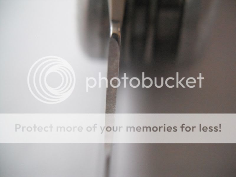

I tried to make a few macro pictures of the sheep foot blade on my Electrician Plus. Hope it adds some information.
This picture shows how the blade looks like. As you can see, it is partly plain edge and partly a wire stripper. On the picture you can also see that both have a bevel on this side.

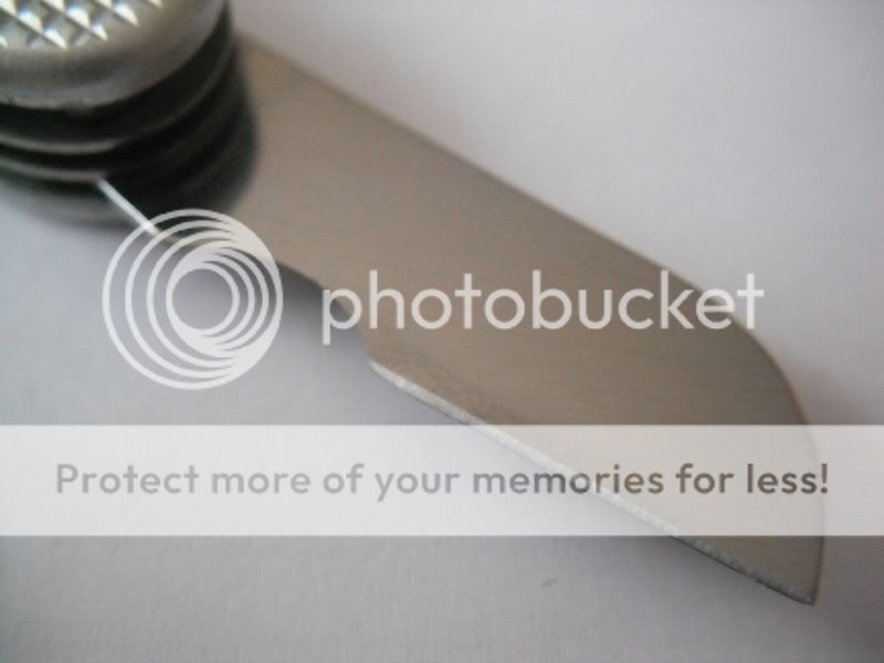

This is a close up of the wire stripper part.

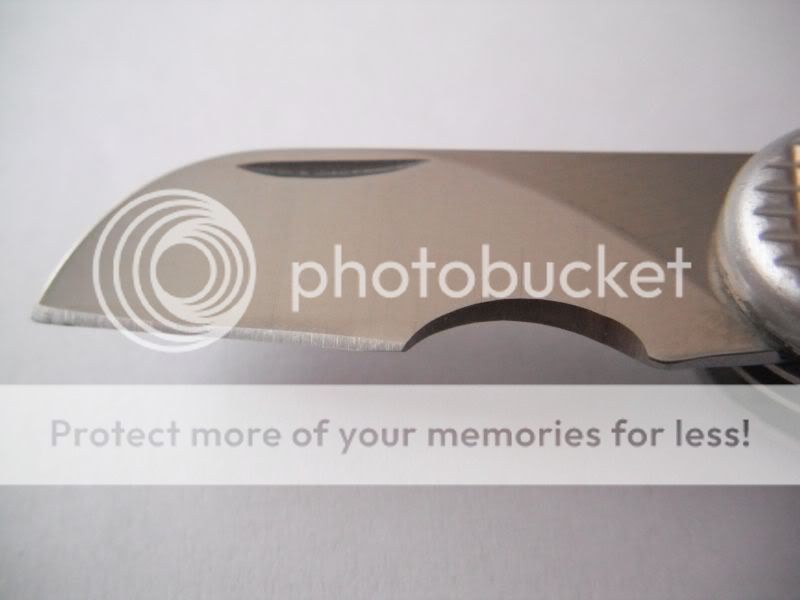

If I turn the knife, you can see the other side of the blade. Here you can see that the plain edge part has a bevel, but the wire stripper part doesn't. So the plain edge part is a double bevel grind (this is also called sabre grind, correct?) and the wire stripper a chisel grind.

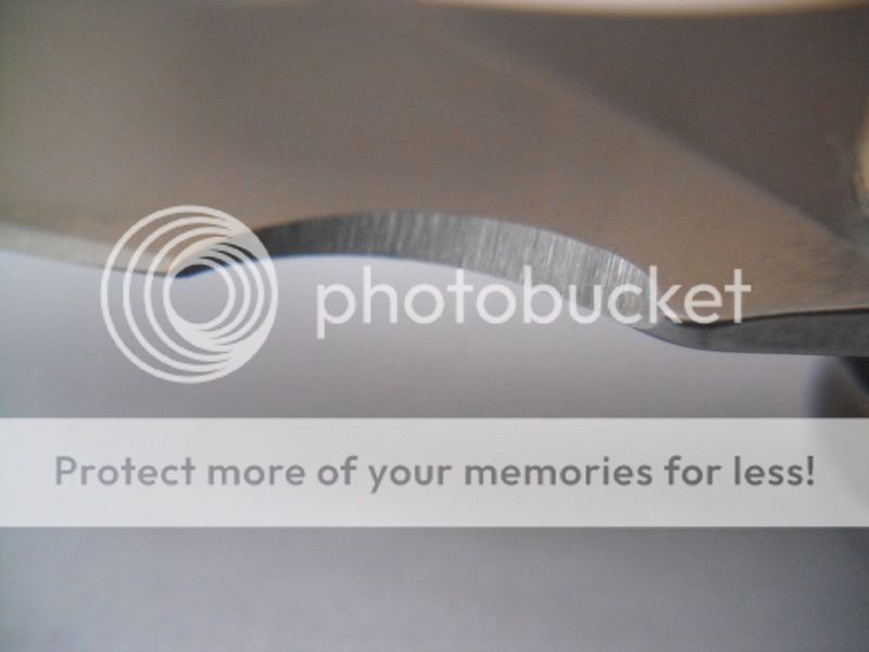

The picture below shows the wire stripper part from under. I tried to do this for the plain edge part too, but my camera couldn't focus on that part. But also in the picture below you can see that the bevel is only on one side of the blade.
I was just looking at mine and the blade itself is a chisel grind. It's only ground on the side with the nail nick. The edge though is a conventional double bevel.

A double bevel can be called a v grind but it is not a sabre grind. A sabre grind is a primary grind that only goes partway up the blade, like a third or a half.

I think it's really just for clearance and ease of manufacture. If it was a conventional grind it would hit the main blade on the Apprentice and the bottle opener on the Electrician.
