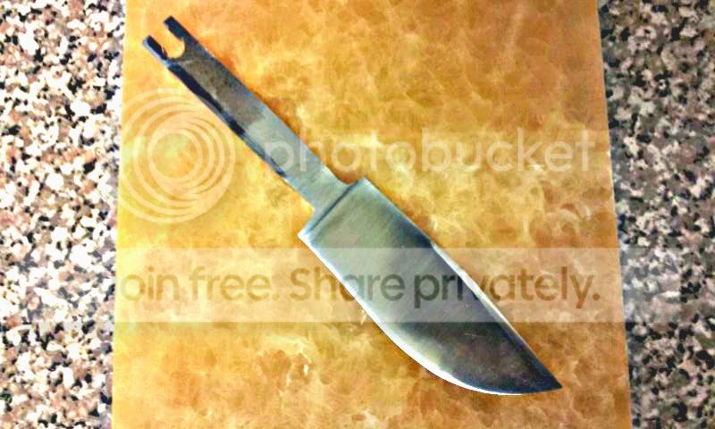

Hello knuts. As a BF junkie I've gone past messing with my knives to actually attempt to create them. I'm still learning and need to keep on reading, doing and taught if I can find an available smith willing to take a student...but I digress. I want to know your opinions on these 2 knives, good or bad is always good :D

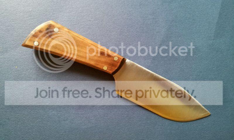

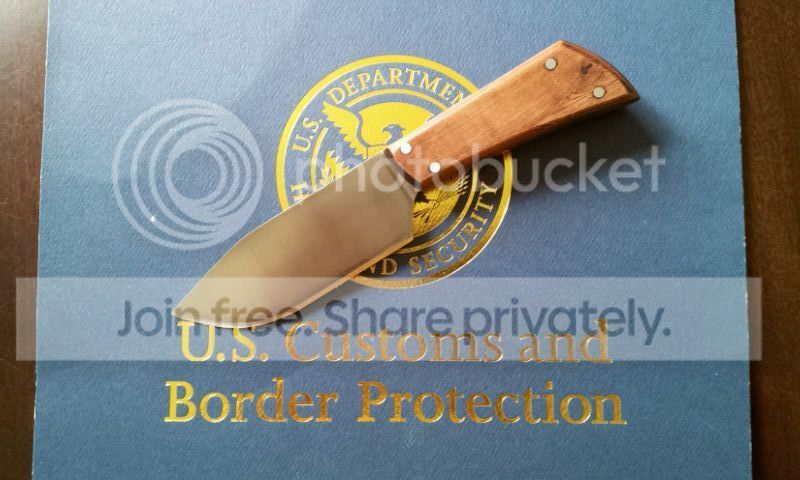

These are my 6th and 7th knife. The small one is made from Aldo's 1084, 1/8" full flat ground with scales from a guava tree and aluminum pins. I made this for a female friend so I had to add some "girly" etchings after she saw a photo and remarked it didn't look girly enough...photos are without the etchings :) (I cut 2 blanks in the same pattern and will make a non-girly one for me later :D)

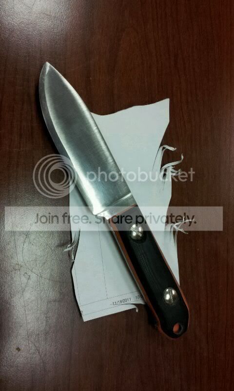

This one...only one catch, I have no clue what the steel is. I made it from a bar that a friend of mine has at his shop that I had used previously to make my 2nd knife and it has held a sharp edge fairly, so I decided to chop up the rest of the bar and make knives out of it for a couple of friends after I finished this one. On the bright side, I traced the outline on a 3/16" bar of Aldo 1084 to make a proper knife later.
I haven't measured it but it looks like 3/16" thick. Blade is 7.5" with a convex edge, overall 13". Scales are homemade mycarta from an old BDU shirt. Pins are brass rods found at an inspection area where I work sanded down to 1/4" diameter. The sheath is blue .08 kydex, rivets spaced for big tek lok but I decided to make a leather harness with belt loop for it as I don't like blades over 5 inches riding high at the hip.
Overall, I'm very happy with it. Haven't been able to put it down since I finished it yesterday, took me like 2 weeks since I cut it. Another bonus is the cost was kept low as the blade is practically made from recycled materials. So please let me hear it. I'm in the process of expanding the garage and getting more tools to keep on making knives, so I need all the input I can get. Thanks.
Your handles are way too blocky. Round them some. Also, to do that to the first one, you'll have to move the pins in a bit.
How did you heat treat the unknown steel?

Blocky handle syndrome is something that almost everyone who starts out making knives suffers from. I have done it too. You have to round them out for the sake of comfort. Just start removing wood/micarta from the edges, rounding out until the handle feels good to you. Don't really worry about removing too much material. If you constantly test it, then you will stop in time.

thanks for the feedback guys. I left them kinda blocky for 2 different reasons. The small one I should have done only one pin at the front since that area is less than an inch wide, I forgot to post measurements but blade is 3-ish inches and an overall under 7. Didn't want to eat too much at the pins outer edge so I just beveled the scale edges and gave it a thorough sanding up to 1000 grit with wood wax.

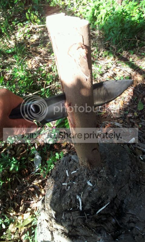

The big one I left blocky on purpose. I hate when a big knife rolls in your hand. I cut some wood yesterday and yes, battonned and chopped with it plenty of 2-3" diameter with just 2 small rolls on edge, and the handle felt good in the hand. It doesn't show in the photo but the upper bevel was rounded and sanded till I felt it right for my hand.
The heat treat, just went with "fire till red-hot, non-magnetic, quench, triple temper at 400". Seemed to work for the previous one I did with that steel. Here's the first one I did from that bar, like it so much it's doing a "rotation tour" strapped to my duty belt and will see how it does for the next month.

Can you post a top down shot of the black handled one? It looks like you have a bit of a palm swell. Also, the handles don't look as blocky on the middle picture of the last post.
It looks like a good chopper. I encourage you to make another one of that pattern using known steel and get that heat treat spot on. I bet it will blow this one out of the water.
Be careful only taking a piece of steel to non-magnetic. The Currie point of steel is 1414*. Generally the austenizing temp is 50-75* higher. However, by the time you get a whole blade up to nonmagnetic in a fire or forge, it will probably be higher in the thin sections. Decalesence/recalesence is a much better way to judge using a solid fuel setup.

OP, I was not trying to be a butt about your handles. You're right, by putting the pins how you did you can't round the handles without ruining the pins. I was planning on doing the same thing on the Rooster, but I was advised against it, given that I wanted rounder handles.
This is what happens when you put the pins too close and round the scales. Dang. Now I have to remake them. I'm sure as heck not leaving them like that!
