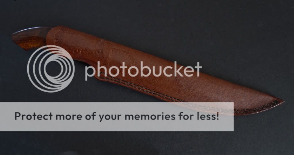

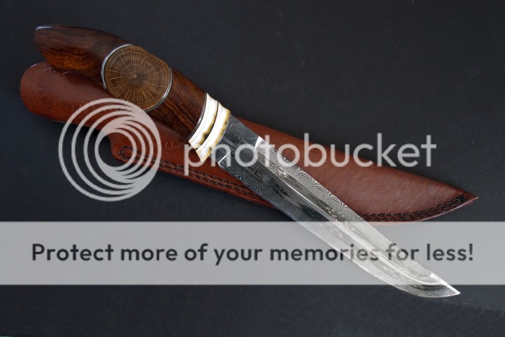

Hi! New to this forum i want to show you one of my knifes I´v made 2010. Im from a town kalled gavle in Sweden. Hoe you like the knife.

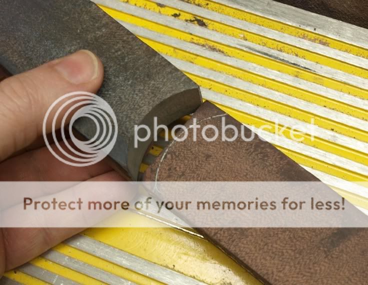

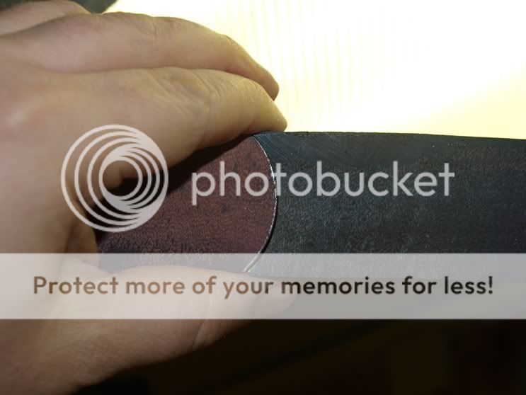

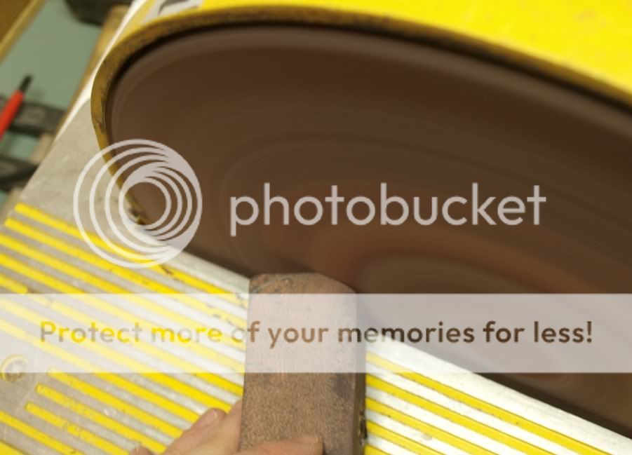

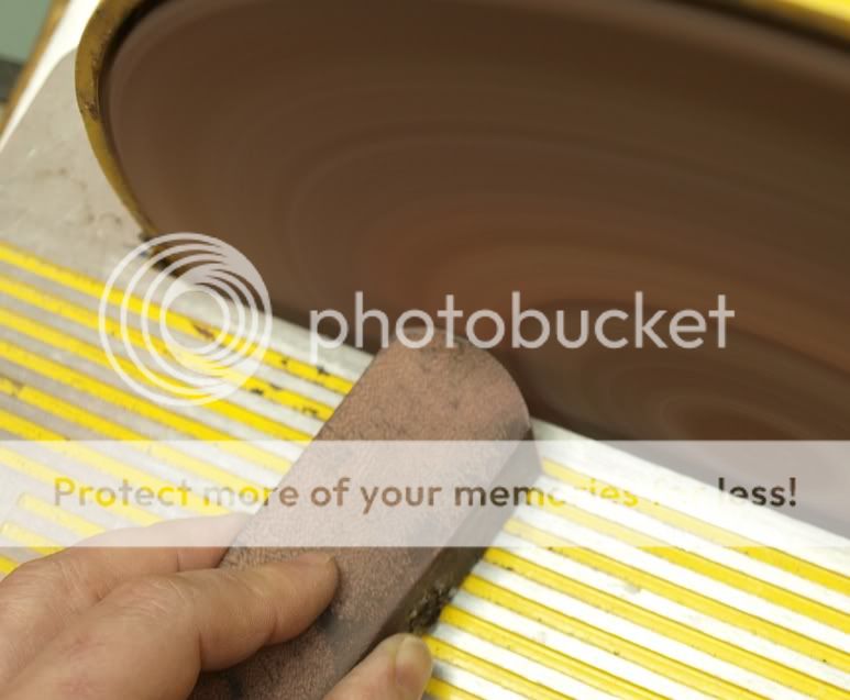

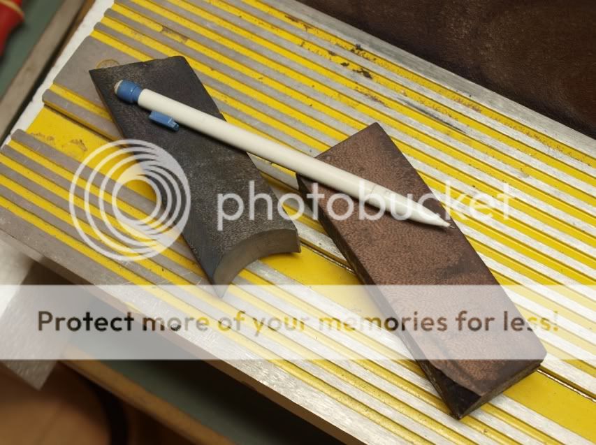

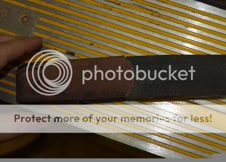

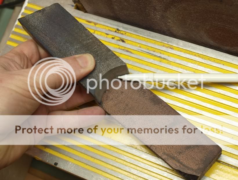

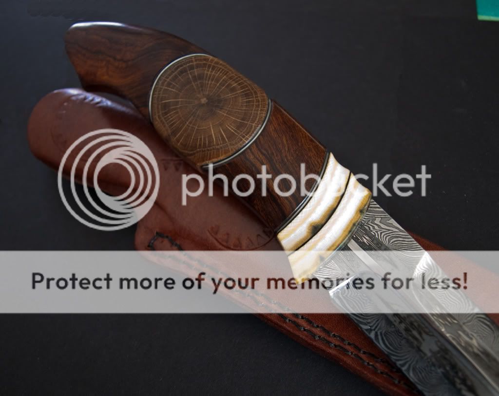

* how I inset the endgrain piece on the scale: No trick just learning by doing ;-). her are some pics how i "do it"
Hold the pieces upp to the light to check the match often...
Easy :)
* What is the bolster made of? The two frontpices is made out of Mammoth, then Desert Iron Wood and Oak. The sheath are made out ​​of a kind of hard crust cow leather
