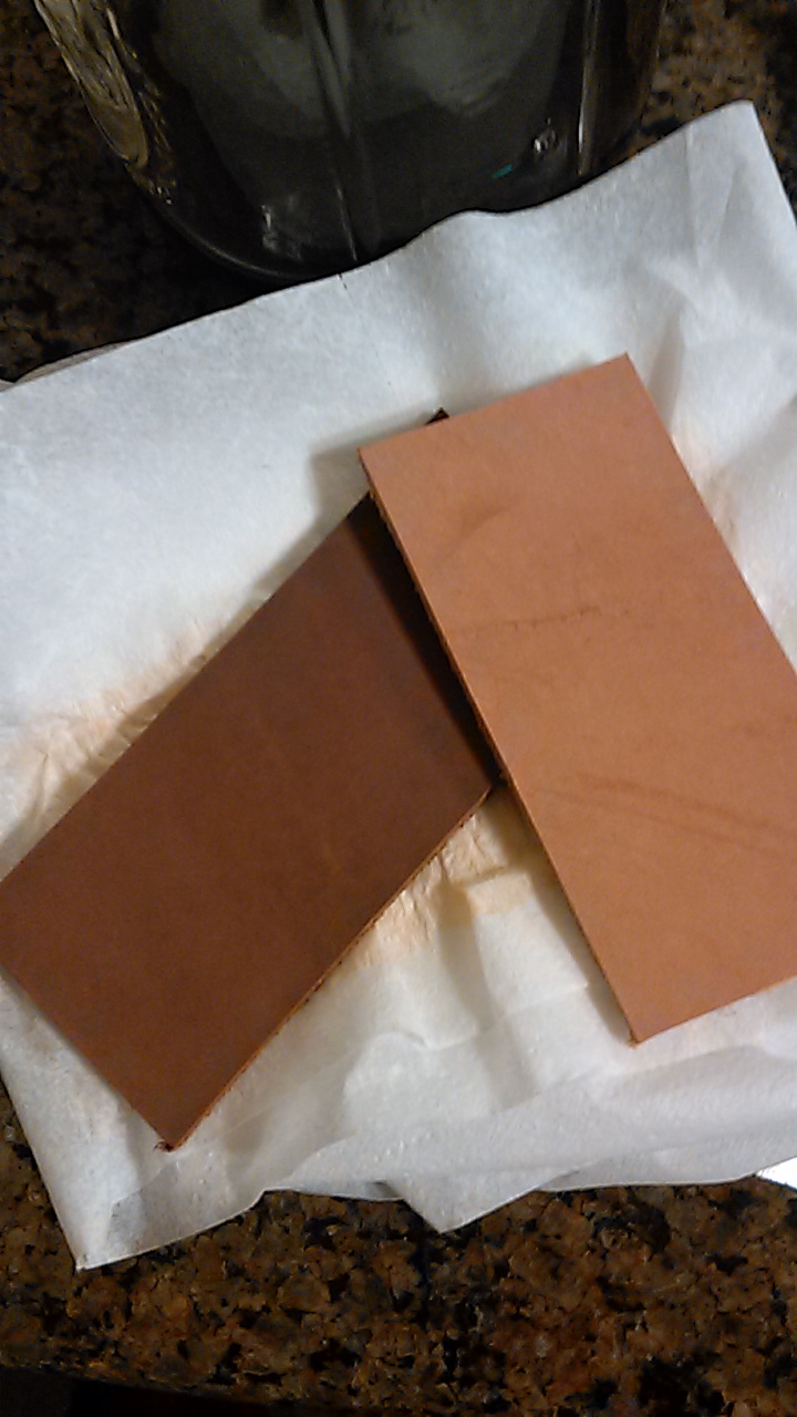

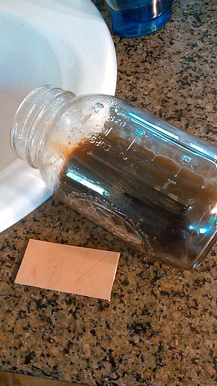

Strong San Francisco Bay coffee with a control piece, and submerged piece. Both have surface marks, but no discernable wrinkles per se.
I'll check on it and post results later.

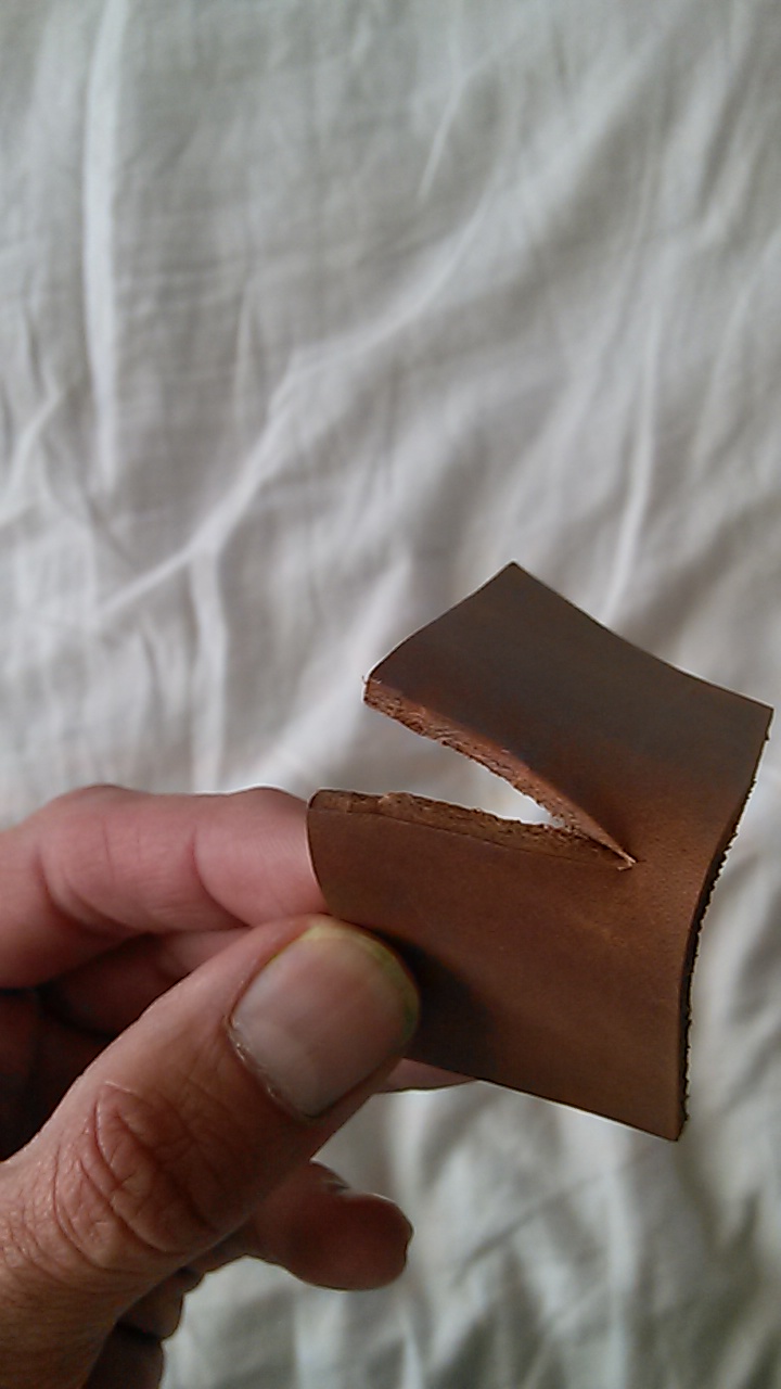

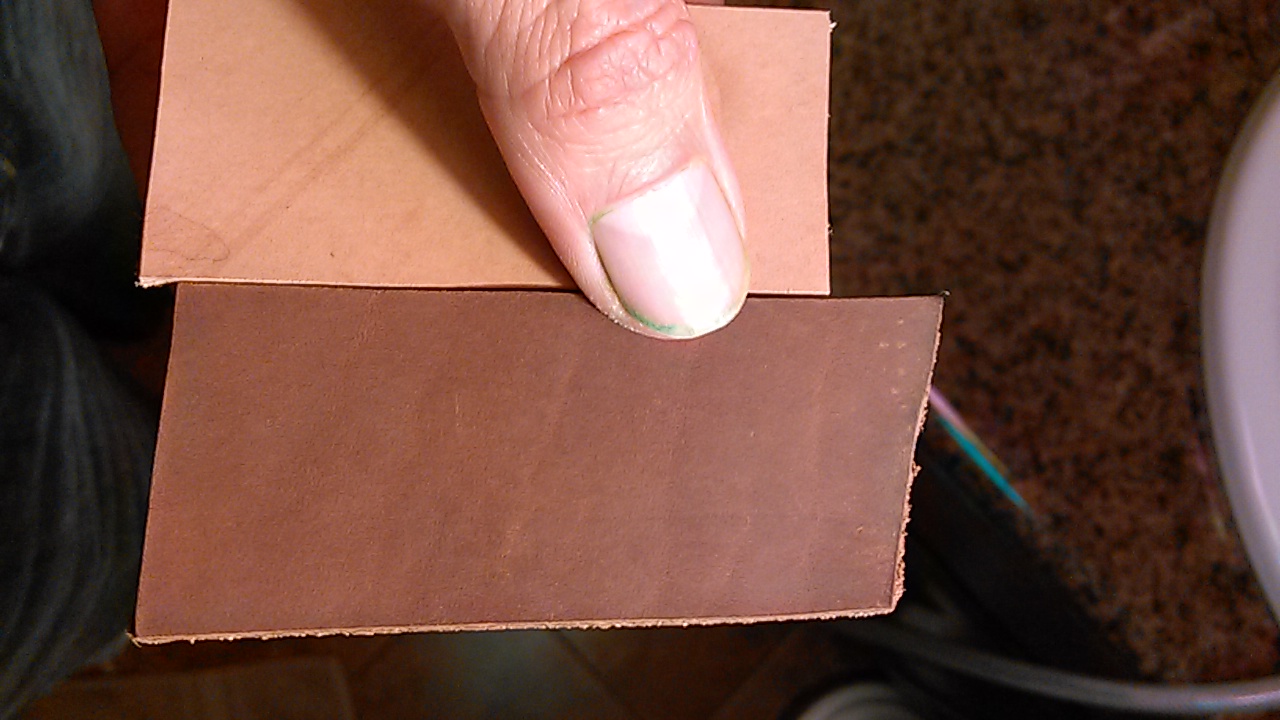

Gotta admit, I'm pretty impressed. I let it soak for exactly one hour then pulled it, gave it a quick pass under the faucet, then let it dry for a few hours.
Aside from the mentioned surface marks, this is what I consider very good leather. You can see the wrinkle marks in the second picture.
There also seems to be some pull up. The leather lightens a bit in a stressed (folded) area which is pretty neat.
I'm trying to think of what might be in coffee that could damage the leather, but I'm not an expert. The pull up may be from the oil present in coffee, but that's wild speculation.

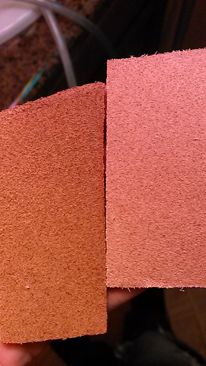

The color from my camera (and poor lighting) isn't great, but it's pretty obvious that there is some nice even dyeing going on after an hour.
I'm pretty used to working with this particular leather. I need to make something from the coffee dyed stuff to see if I can detect any perceived issues, but so far I'm liking it.
