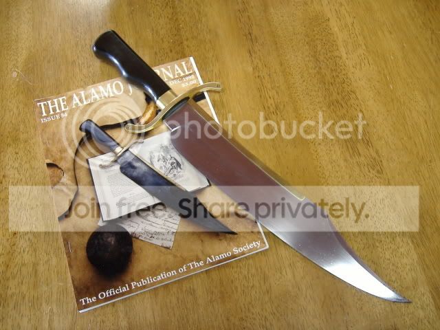

It is slightly hollow at the ricasso and maybe 2" to 2 1/2" Here is a photo of of it and mine. You can see the shadowing of the hollow on the original. The drawing done by Joe is much better than the one I see in these threads, and includes most all measurements. The blade at the guard is 7/32" thick, and tapers to 3/16" around the false edge, then holds that thickness to very near the point. The weight of the original is only 1 lb, 12 oz. The original guard is 1/4" thick and was a brass sand casting. I made mine, took three tries, from 3/8" by filing out the center. I tried 1/4" brass twice, and was unable to get enough width on the tips, and still get the tip thickness correct.
As far as I know, the only place you can get them is from Joe Musso, or someone who has them and would do a copy for you. I made a promise and can't. Google Joe's name up, and see if you can find a contact for him. However, the drawings above should get you by, if the drawing is layed out accurately enough to take measurements from. It looks right. By the way, the grip wood is not known for sure. It may or may not be oak. It was never tested. I don't mind giving you any unknown measurements, but I can't give you a copy of the drawing by Joe.

LRB - would you please relate the availability of that Alamo Journal? Or date of printing or issue number, it would be greatly appreciated.
Ed, very odd you should ask. I was thinking about that magazine last night, and I don't remember where I put it. I will try and find it today. It was put out by Arnold Chernof. I bought it as a back issue. I will try and find it.
ED, I was wrong. The publisher is William Chemerka. Back issues are $5.00. It looks like issue 84 Dec. 1992. I still cannot find my copy, but that's what the pic looks like to me. Hope that helps. If I find my issue, I will surely let you know. I cannot find a phone #, or email, but maybe you can.
