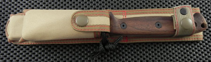

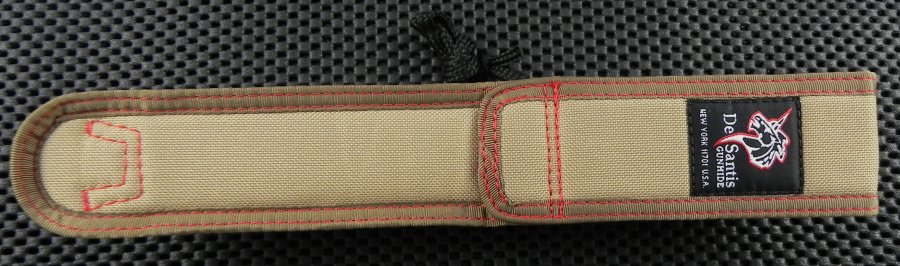

Also Ontario proudly mentions that the sheath was made by gun holster maker DeSantis. To that I say....Really? Don't get me wrong Ontario knives usually sell for cheaper as far as USA blades go because they skimp on the sheath, and the Bushcraft sheath is not that bad, but its not anything amazing and showing the need to bring in Desantis to help create.
Link Removed
(On a side note the above pics are from a knife reviewer-retailer, I just wished I understood what language he was speaking)
