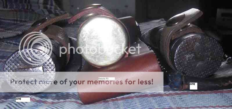

The ads I have seen for the P3 all mention using the butt to hammer. You can actually do that with a 225Q, but I strongly advise against trying this with a P3. The 225Qs have a steel cap that averages out to .49 inch in thickness, note also the way they are made causes hammering to just seat them tighter. Conversely the thin brass disk making up the butt cap of the P3 appears to merely be held in place by an epoxy of some kind underneath it. Because the P3 cap conceals the tang I do not yet know if the P3 has a narrow tang or the wide tang of the originals. No doubt attempting to seat a brad or thumb tack with it will soon reveal this to me.

The butt cap on the 225Q is held in place by the two twisted nails, the second plate locks in place with a slot. I have one taken apart. I will try to dig it out and take some pictures.

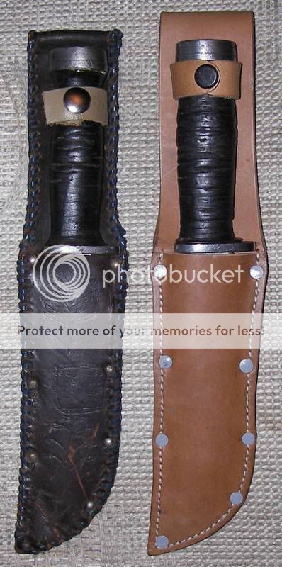

For what it is worth the replacement sheaths I ordered from Allied arrived today. The original sheath pictured alongside it bears the previous owners 'trench art,' and he resewed the edge sometime in the past 60 years and I added a new snap when the old one ripped out. IMO, the Allied seems pretty faithful to how the older one must have looked 60 years ago. Judge for yourself.
