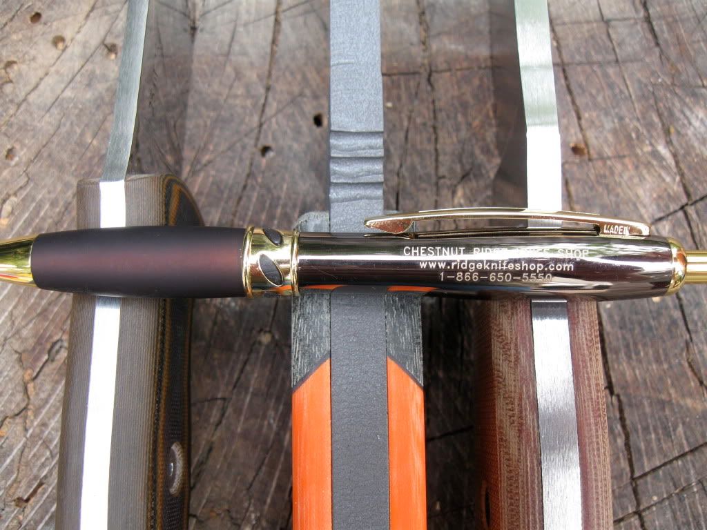

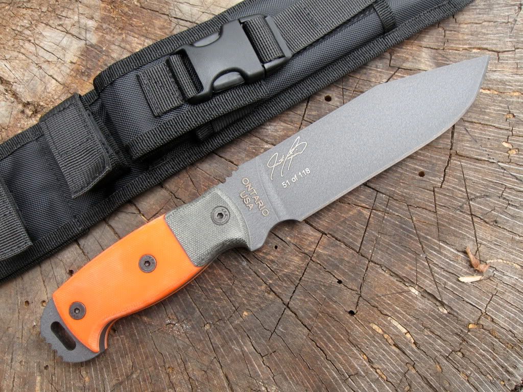

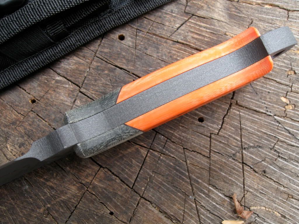

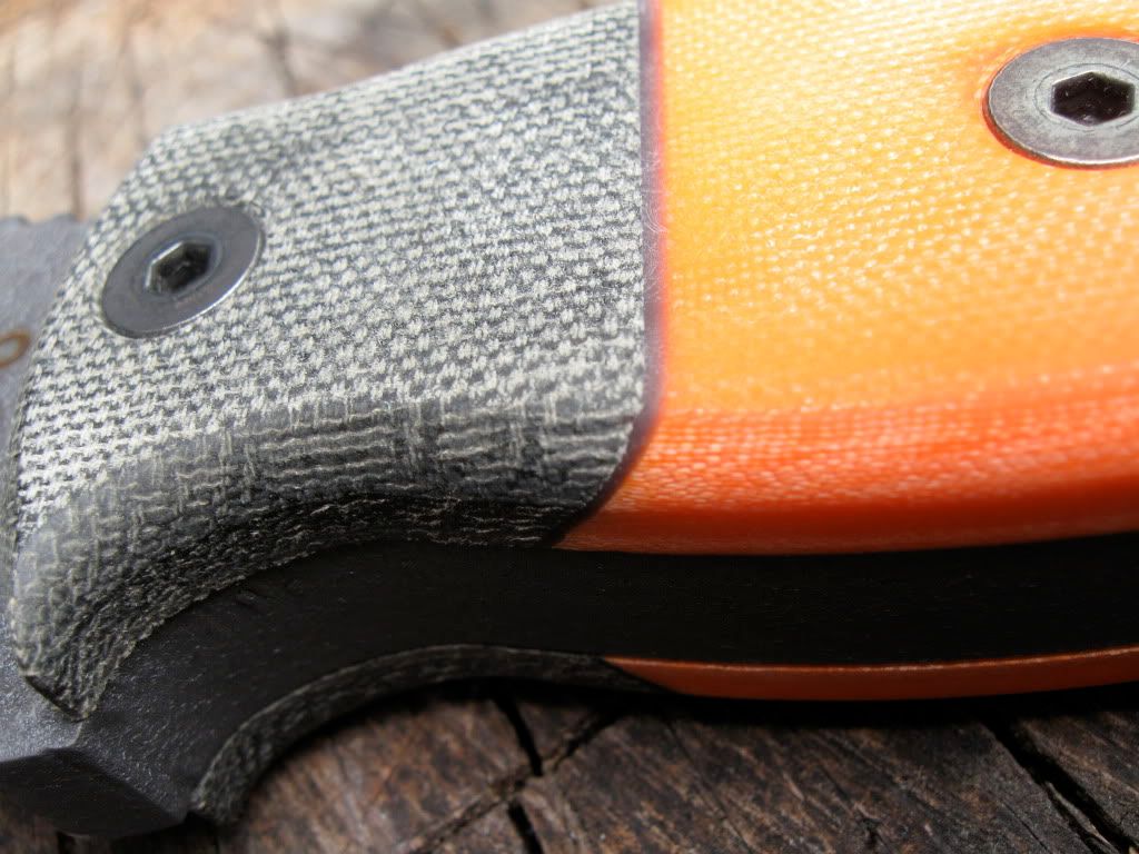

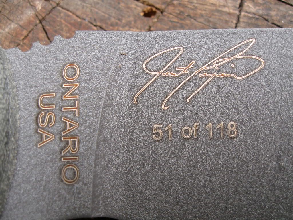

Here are some pictures of my RD-6 Signature Series.
3/16" "Shark" Ranger Forum Blade, 3/8" Signature Series RD-6, 1/4" Ranger Afghan
The fit and finish is pretty good.
This is a Signature Series Afghan.
