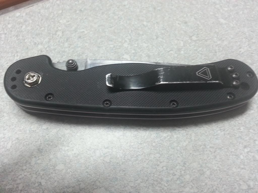

Let's start with how the paint wore. The pocket clip has worn pretty bad but in my opinion it looks pretty bad.... ass..... pretty badass.... so i kept the paint on it.

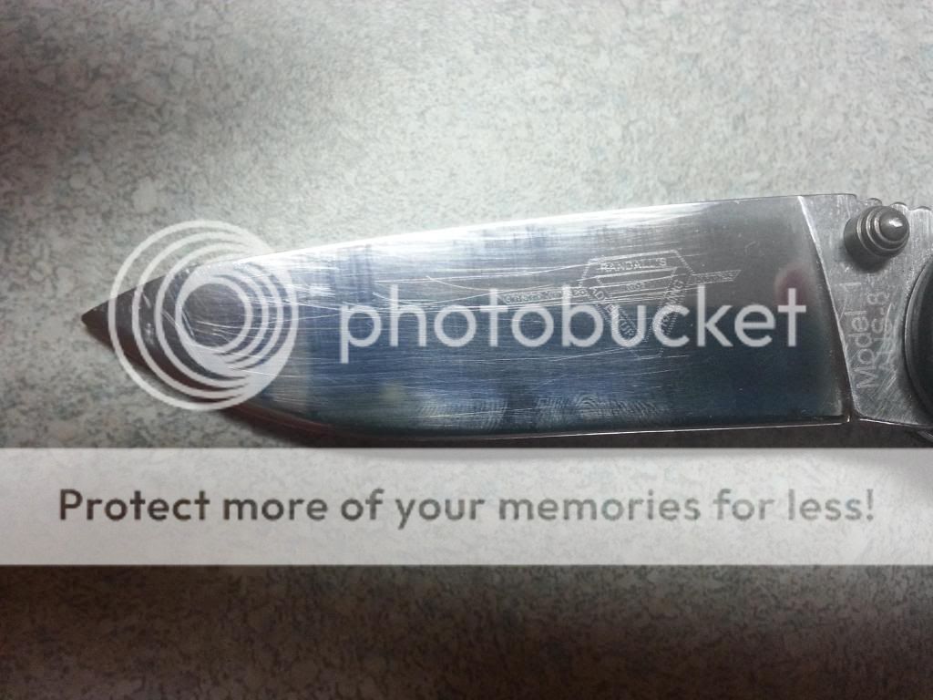

The paint on the blade did not wear as well as i had hoped so i ended up stripping it off.

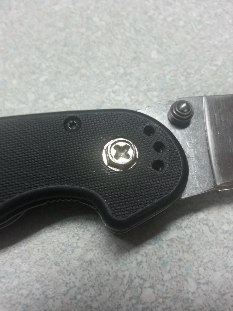

The head of the pivot screw stripped and the other snapped after tightening them back down dozens of times and disassembling the knife for maintenance about a dozen times. I found short computer screws fit perfectly as replacements.
I have over a hundred screwdrivers, bitdrivers, bits, etc. but a couple times i didn't have access to any and had to use my RAT as a screwdriver (I know... it's sad, and breaking my own knife rules but you gotta do what you gotta do) I ended up snapping the tip twice. I ground it back down to a usable, pointy, and stronger tip. Here's the new blade profile.

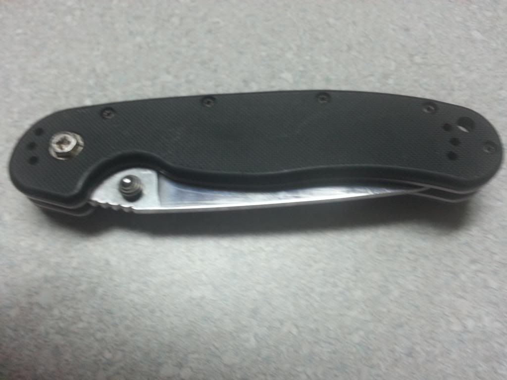

The Nylon 6 handle scales have held up amazingly well. There's barely any noticeable wear on them.
Lockup has suffered a bit but is still rock solid at about 80% engagement.

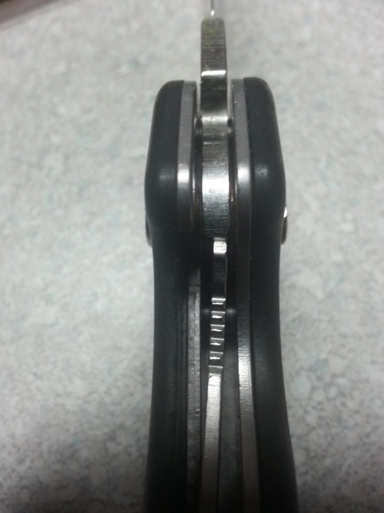

Final notes: This knife has been put through A LOT in a short period of time and is still a tank, sharp as a razor, and my favorite knife. My RAT is at my side every second of every day and has never failed me. One thing i forgot to take pictures of is blade centering which is still perfect. It opens as smooth as the day i got it although i did have to polish the washers once and clean and re-oil it many many times. I hate for my knife to be less than razor sharp so i've sharpened it more than necessary and have had to remove a lot of metal to get rid of chips and dings in the edge.

I've seen some people saying they have problems with blade centering after reassembly and i've found why. When reassembling you have to make sure that the washers are in the right position to fit onto the pivot when you push the liner and scale back on. It's hard to do because the fit of the parts has very little wiggle room.
