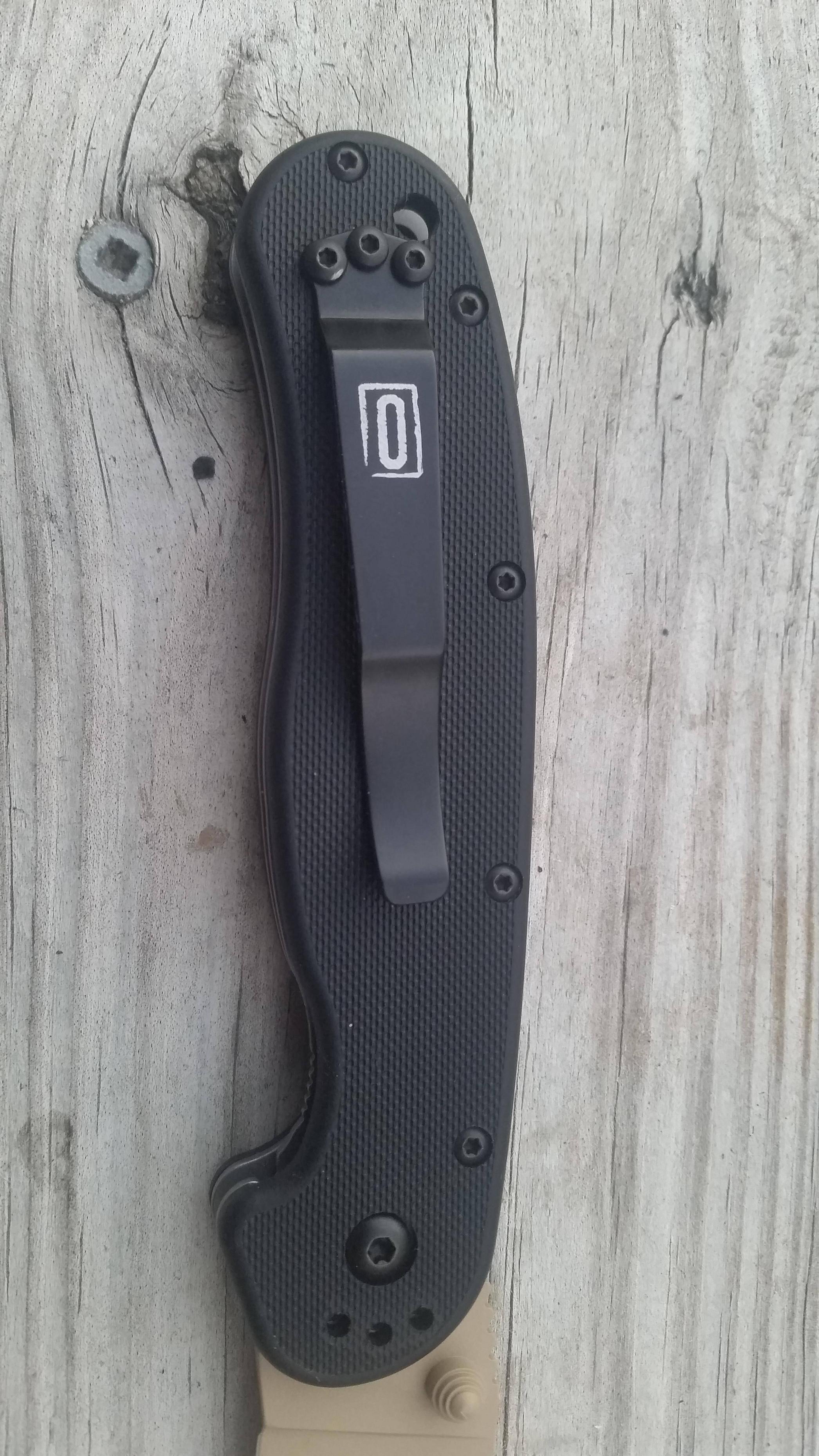

Woah, this is a cool knife. Feels good, action is great, size is just right. Again, feels fantastic.

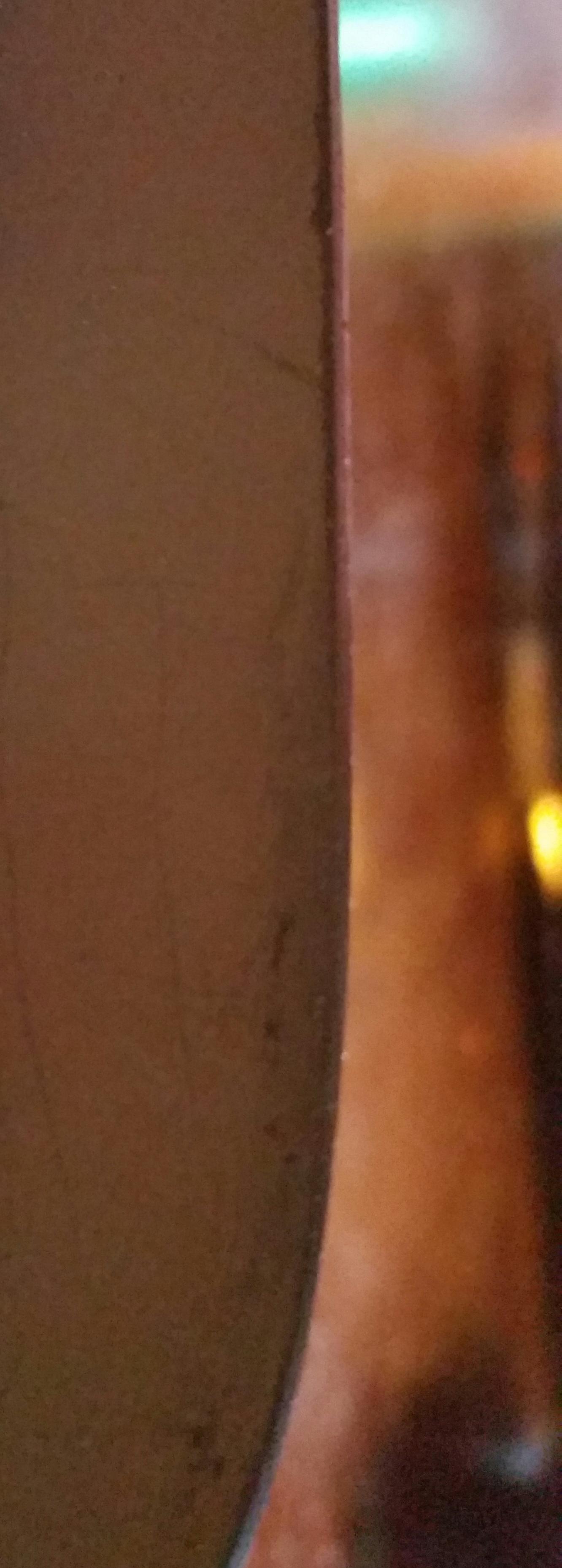

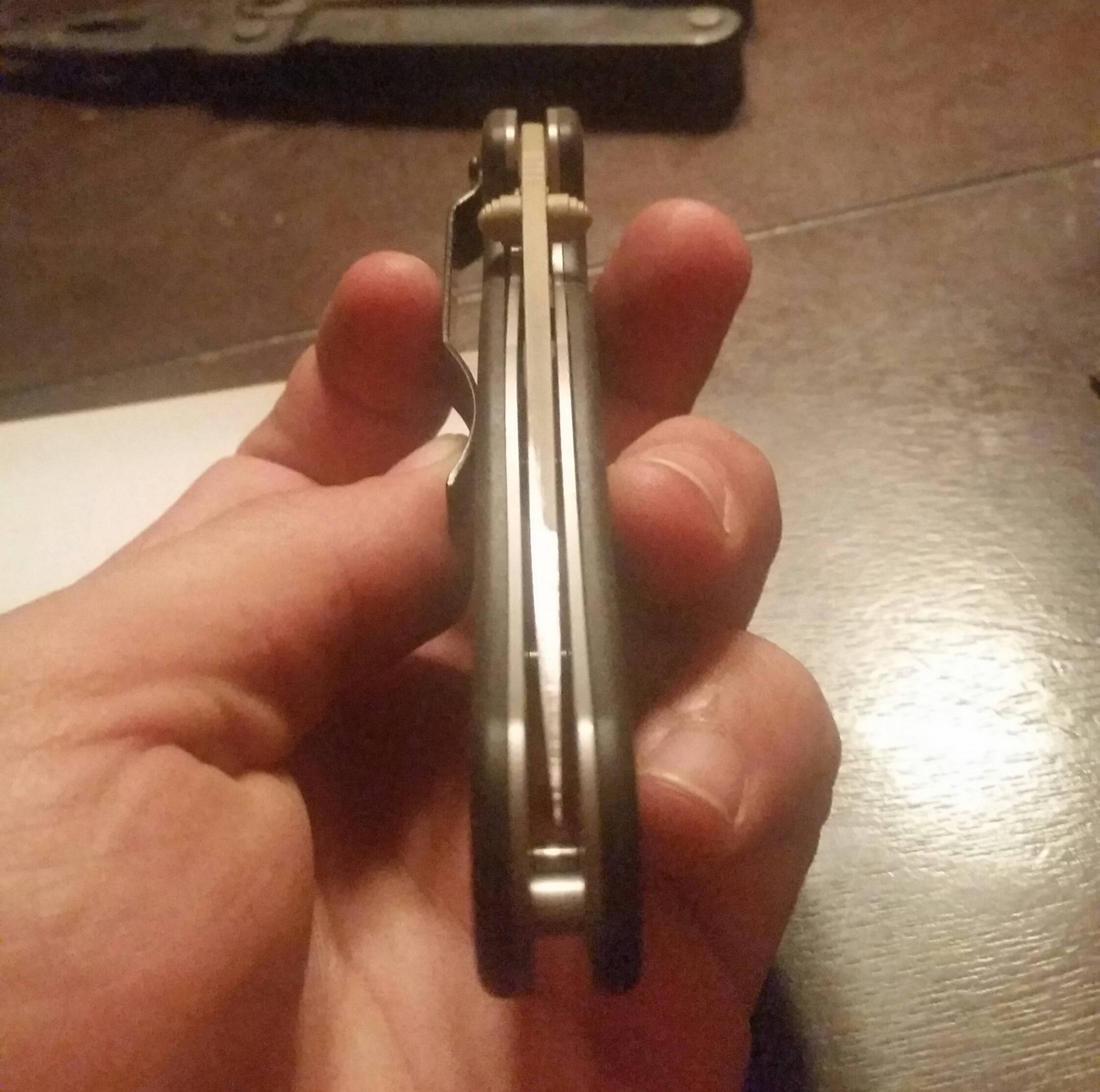

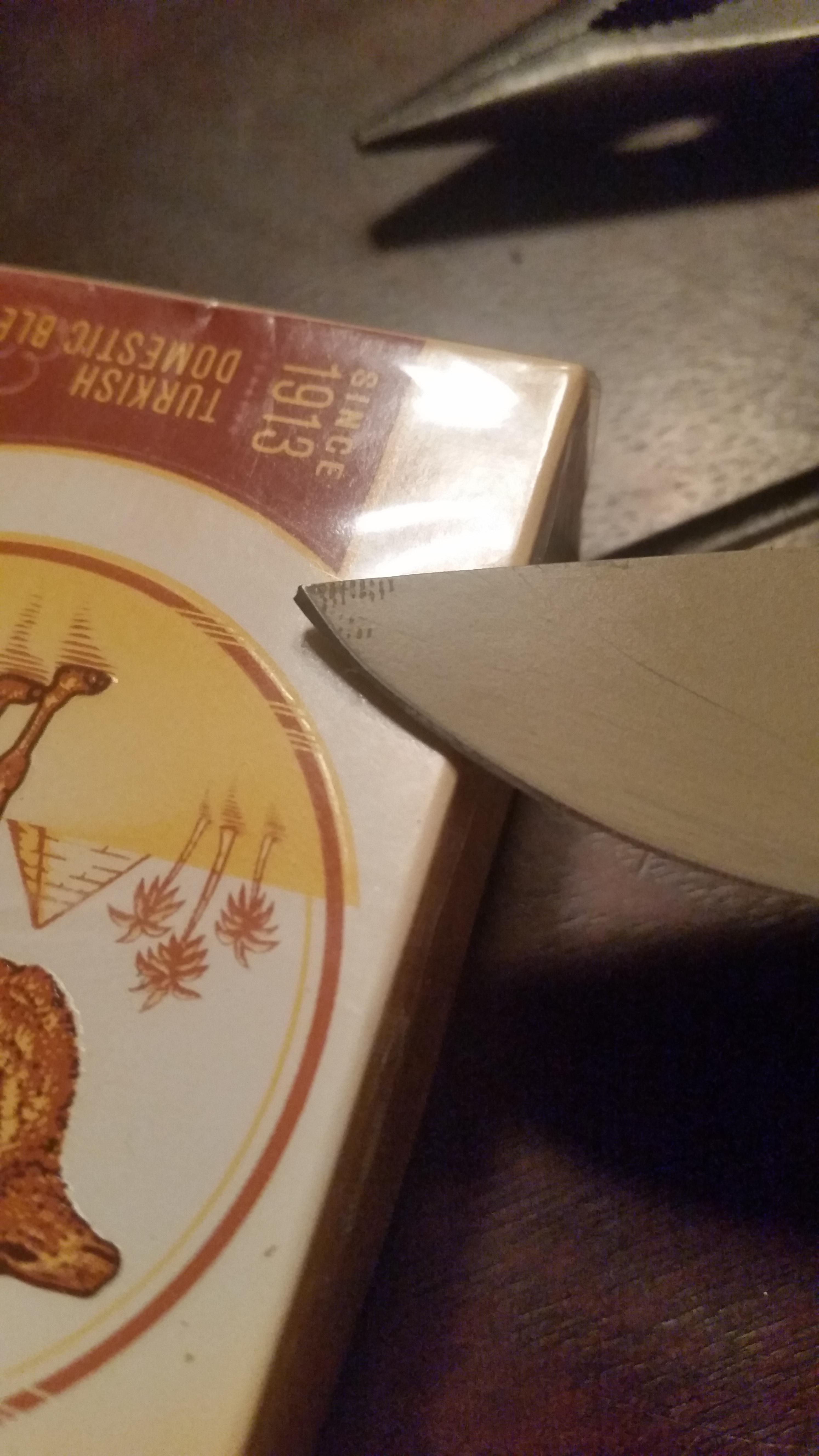

Upon closer inspection I saw that the tip is slightly off. Don't know if that's because of the regrind or through use.
The cerakote is pretty much intact.

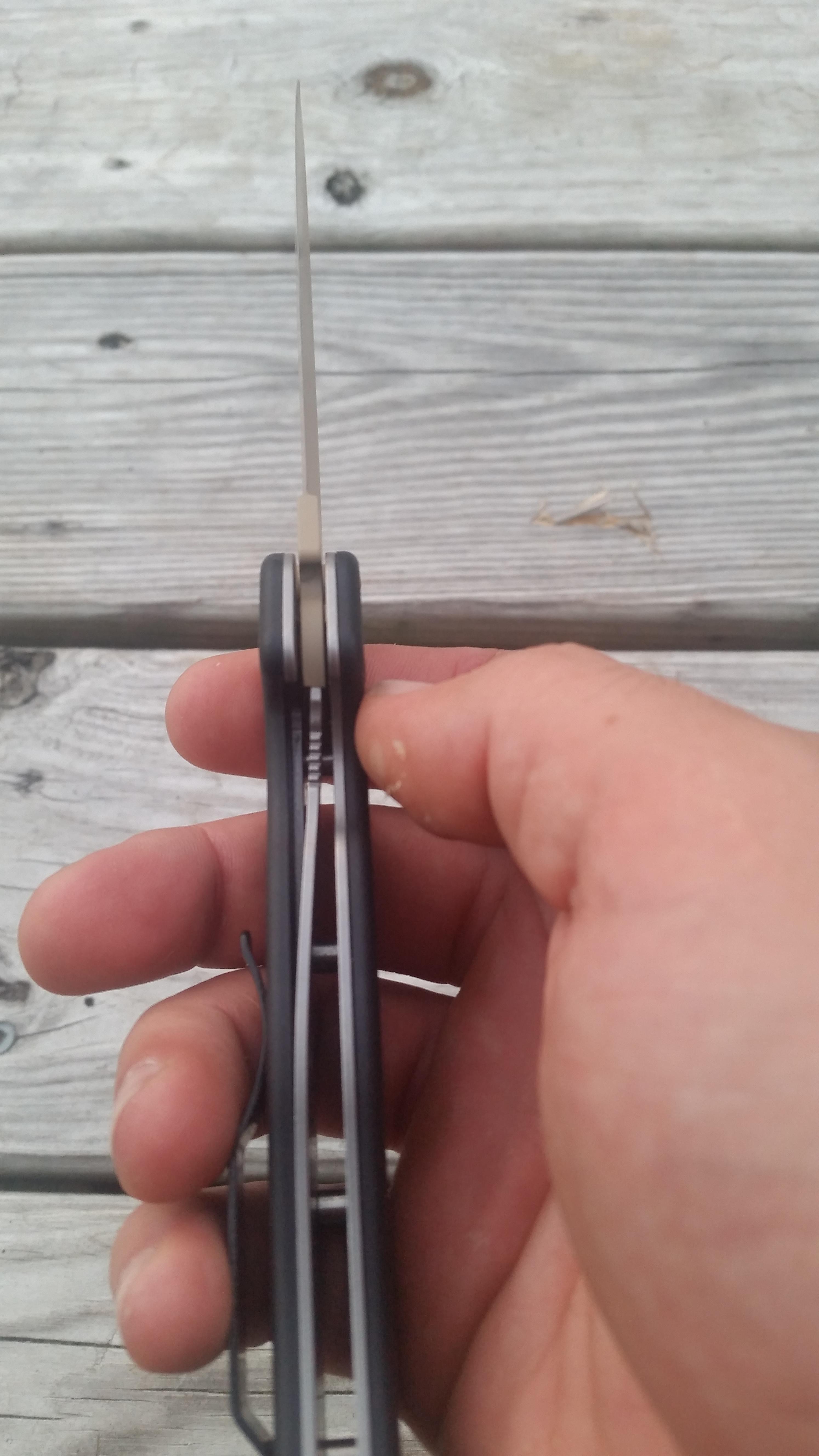

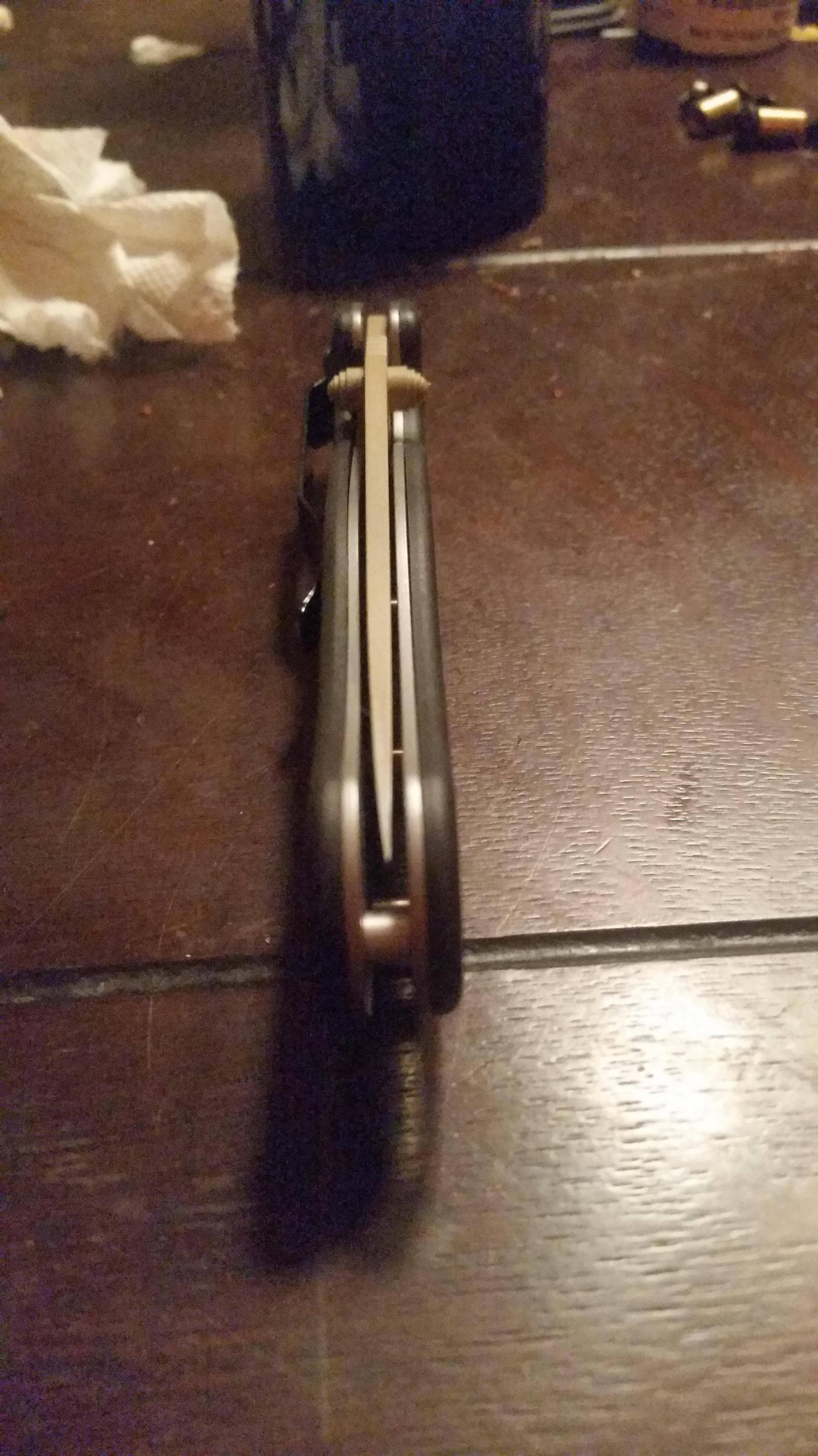

The centering is off. It's hard to tell if it's because of the tip being a little bent or the blade simply being off center. It looks kind of like a combination of the two. The blade does not rub and opens very nicely.
The lockup is greater than 50%. Again, I don't know if the regrind has anything to do with it. It's solid, though. No wobble or up and down play.
The plunge lines are very well done coming to a very even edge
The markings on the clip are a little worn off but I think it looks pretty danged cool as is.

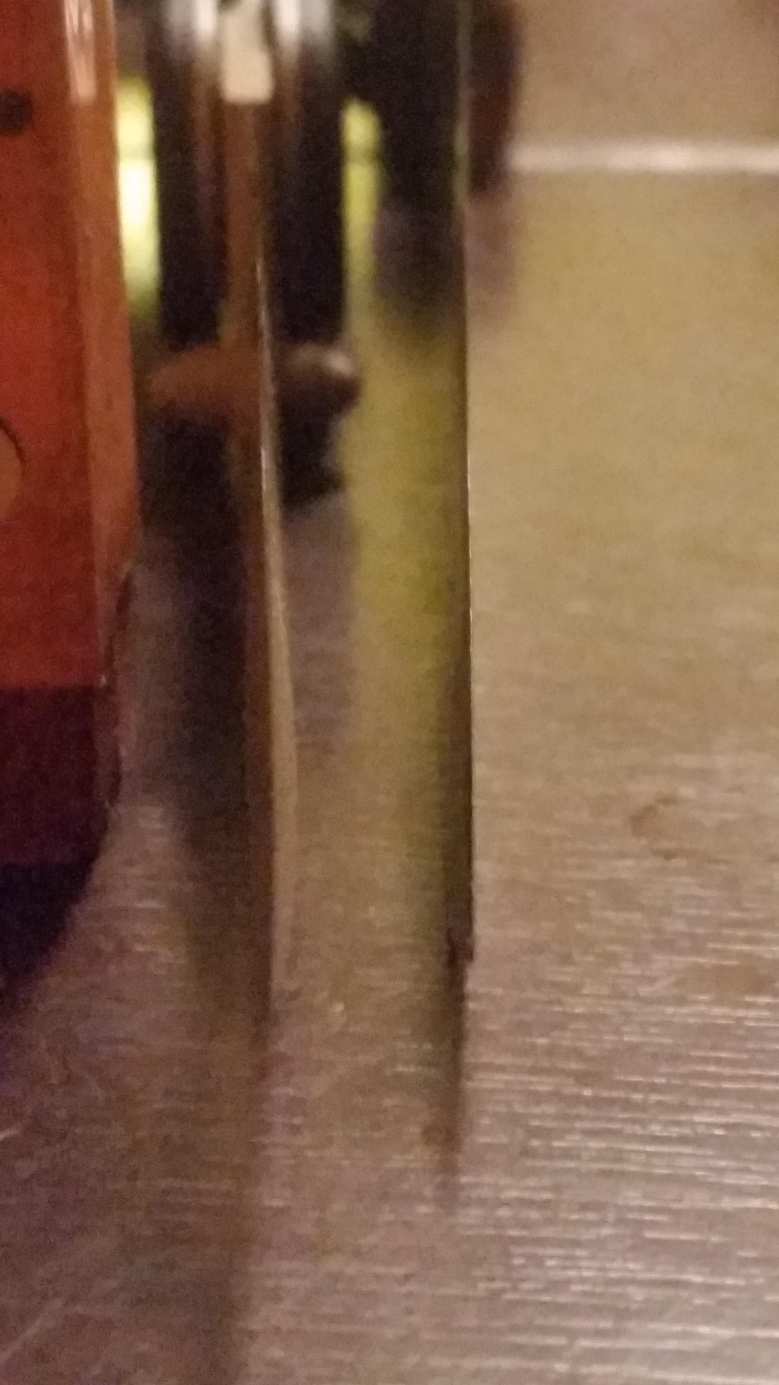

So the tip is bent? Oh, and if you have a caliper I would be curious if you can measure the shoulders of the edge to see how much they have thickened up through sharpening =)
I had the edge set at 15 dps when it left, not sure if it's still at that or not would be good to know.
Good stuff man. Looking forward to it!
I don't have a caliper on me but I'll try to get one in the next day or two to measure. Here it is next to a knife that's about .010" +/- behind the edge.

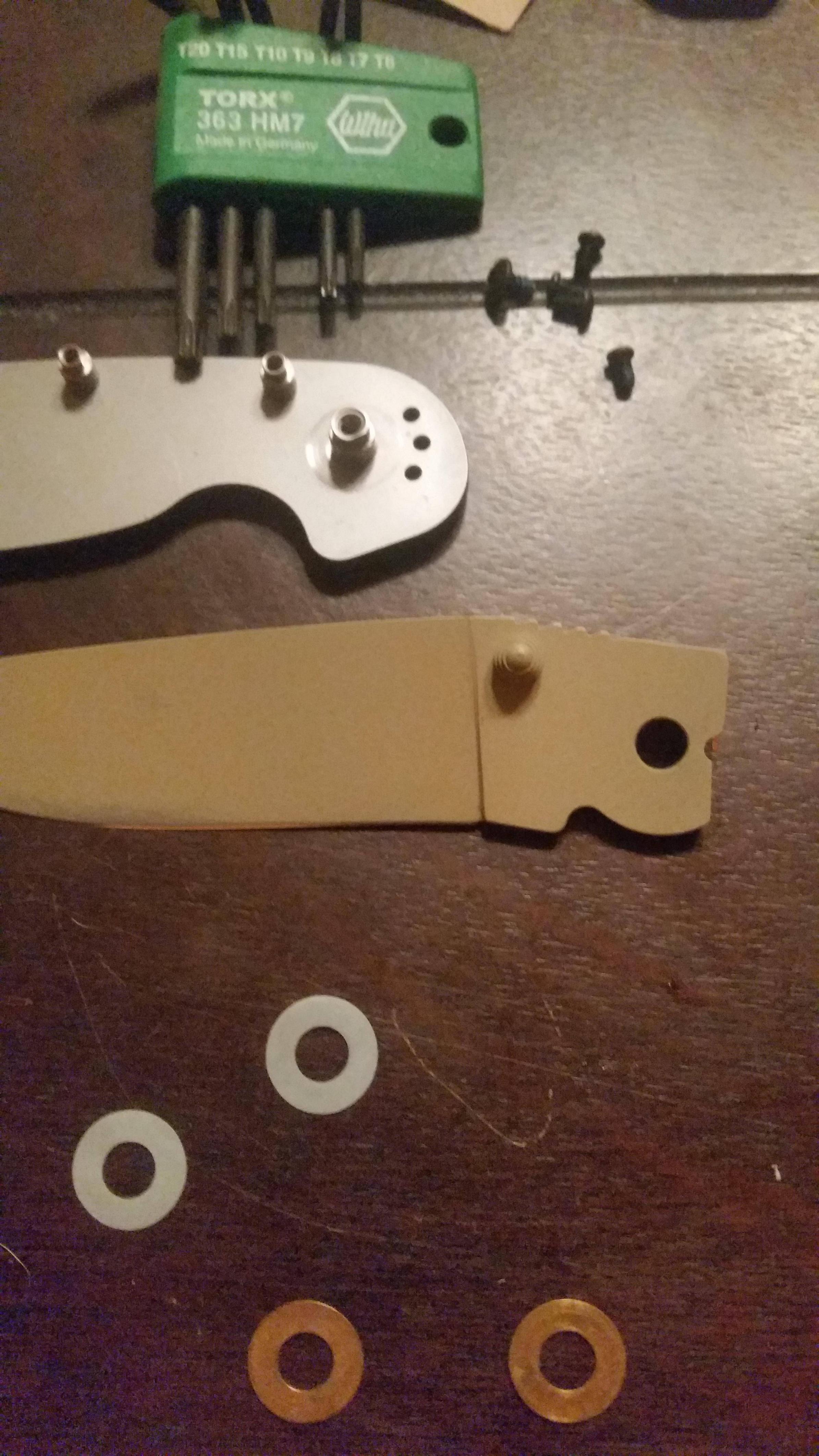

Torn apart. Cerakote at the pivot.

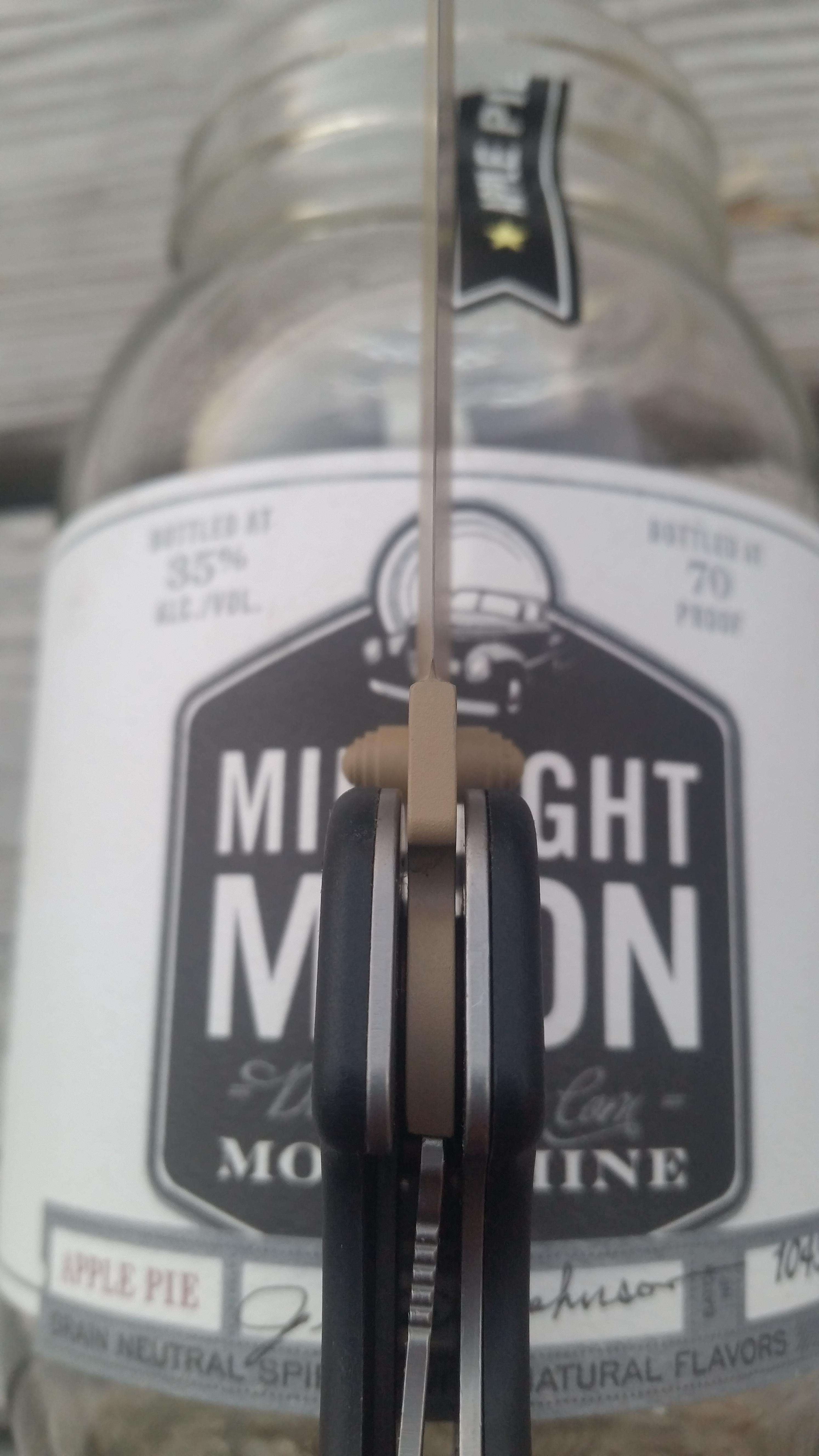

Well, I tried fixing the off centered blade and slightly bent tip. I fixed the centering issue but slightly screwed up the bent tip. I did a decent job polishing the washers, lubed with fireclean, and now it opens better now than it did before, IMO. I can thumb and finger flick it open.
But trying to straighten the tip resulted in a screwed up coating and a tip that needs some TLC.

No worries on the tip... you can either fix it by grinding the spine side down or just leave it and I'll do it when I get it. =)
That's one of the beauties of a thin edge - insanely easy to sharpen and maintain because it's such a small contact area for the stone which allows the abrasives to work very quickly compared to a wide edge!
If you're good with it I can fix the tip that way but it'd remove the cerakote from the spine near the tip...
Yeah that's cool I would do the same anyway haha

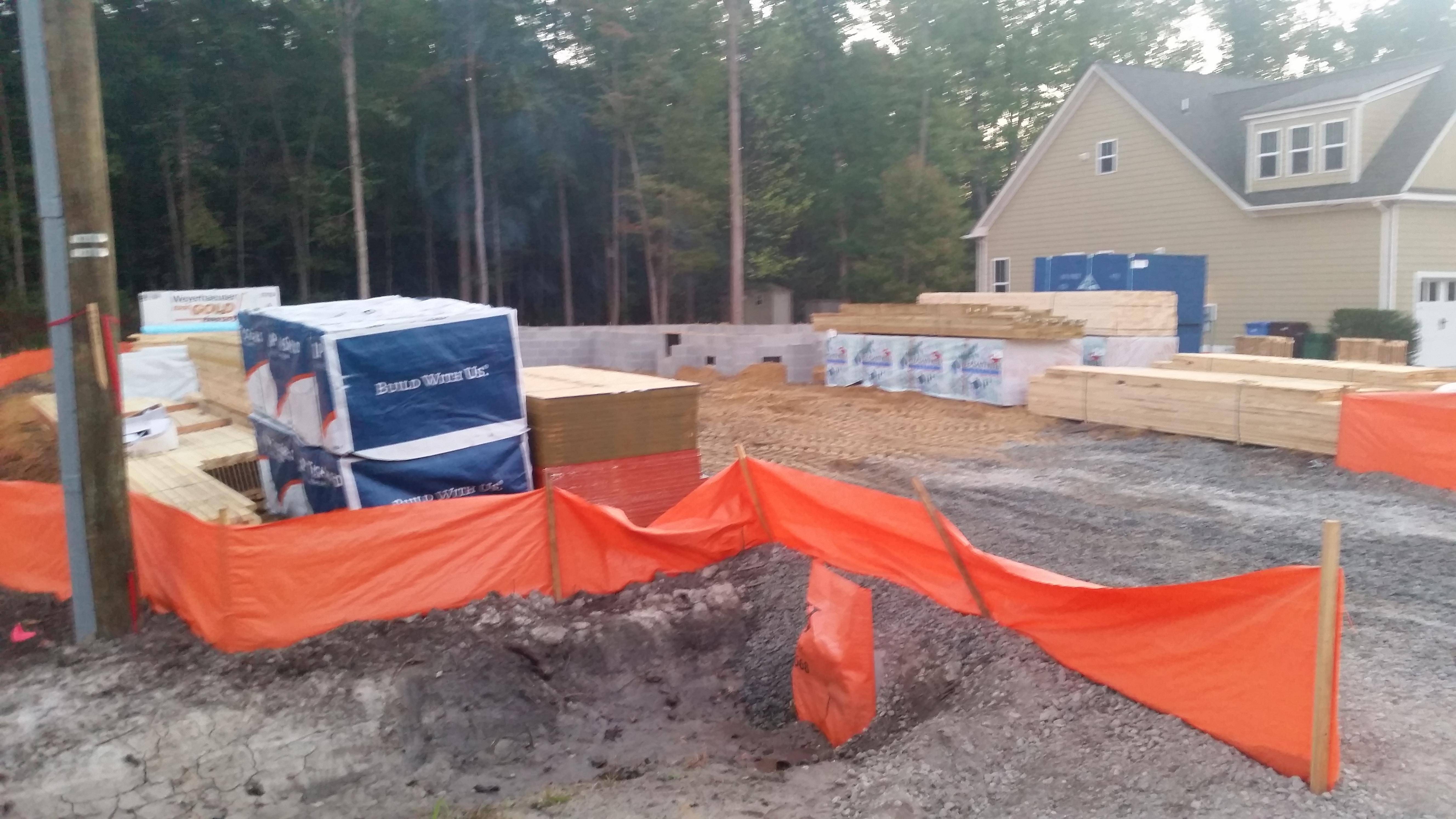

This morning I went to a home building site. I told the guys there I was doing a review of this knife and that I wanted to cut some stuff up. They said of course so I popped some pallet straps and cut some plastic sheeting. No big deal. That's all they had to cut up when I was there. A couple of them handled the knife and I believe Ontario may have a few new customers after I told them about how much they could get the knife for. They seemed to like it.

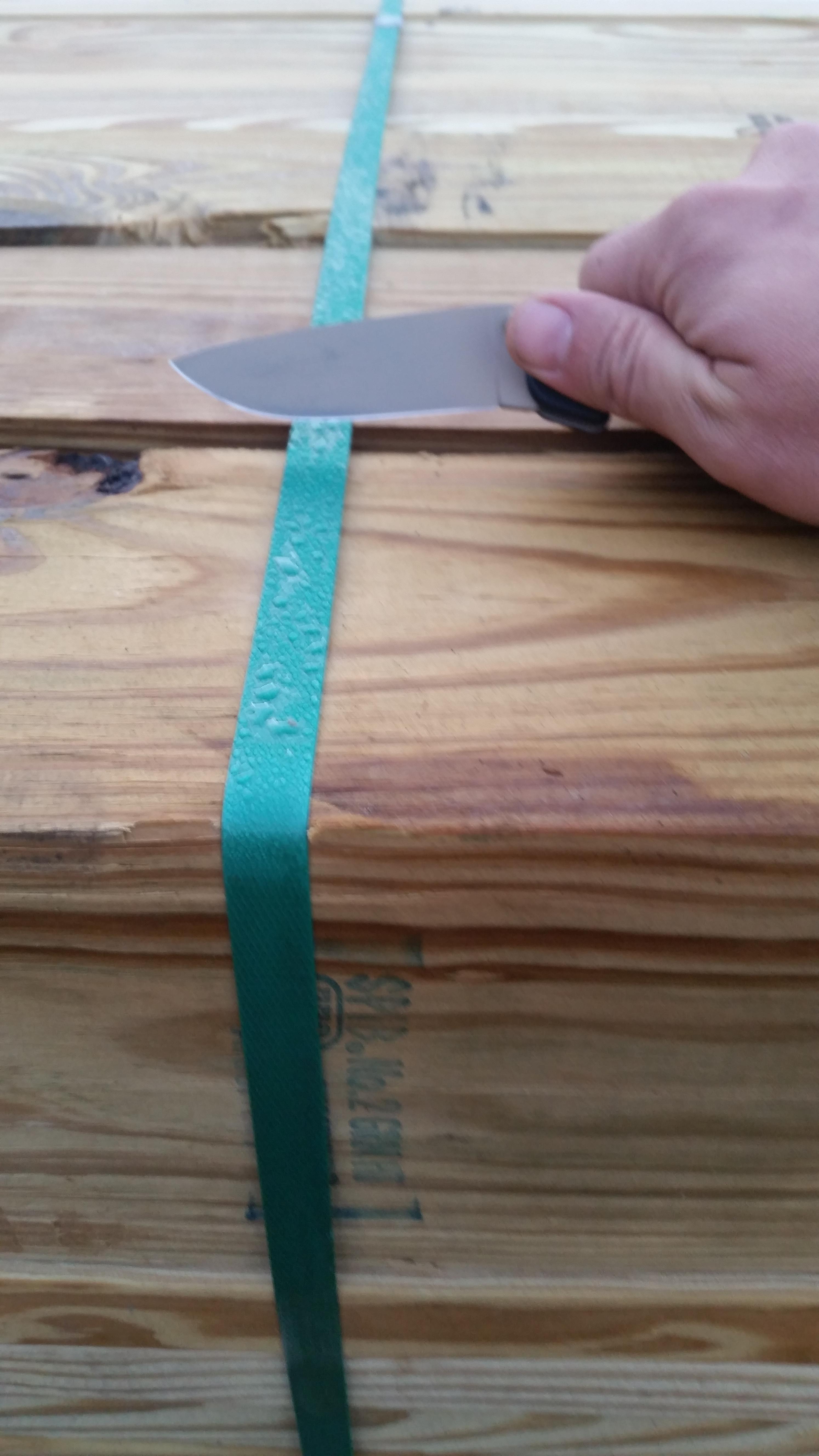

So these pallet straps are the thick plastic ones. I cut off a piece to do the comparison and basic test. We all know that AUS8 isn't the most wear resistant steel so I'd test the edge stability during push cuts to highlight the geometry.
I doubled up the strapping and the Ontario push cut through it cleanly and relatively easily. Geometry is important.
A thicker knife could not do it. I was pushing as hard as I could and it barely notched the straps.
Since the Ontario could handle the doubled up pretty easily, I doubled it again. It was pretty difficult pushing through quadrupled banding straps but it still did it where the thicker knife could only push through one at a time.
I whittled and bored into some fairly soft wood. With the Ontario I could cleanly shave thin slivers and carve out up to about a quarter inch without the wood splitting. The thick knife could not shave the wood quite as cleanly and trying to carve off an equivalent 1/4" split the wood instead of cleanly cutting it like the Ontario.
After this amount of work the edge rolled. Not terribly, but enough where I couldn't just strop out the damage. Several spine leading strokes on a 1000 grit stone straightened the majority of the edge but there were still some deformed spots that need to be sharpened out. It's super easy to sharpen so it's not a real concern. If you're doing this stuff all day everyday you'd probably want a knife with a tougher, harder steel. For edc purposes it's good to go, though, especially considering the price.
