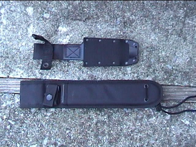

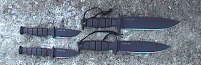

Here are the knives I tested:
Top Left: SP-40 Alpine style blade (slight drop point) with aluminum butt cap (threaded on the tang for strength).Overall length 8 ⅛, blade length 3 ¾, thickness 0.165
Bottom Left: SP-41 Skene Dhu style blade (elongated spear point) with aluminum butt cap (threaded on the tang for strength).Overall length 8 ⅛, blade length 3 ¾, thickness 0.165
Top Right: SP-43 Dirk style blade. Overall length 13, blade length 8, blade thickness 3/16
Bottom Right: SP-42 Dirk style blade. Overall length 12, blade length 7, thickness 3/16

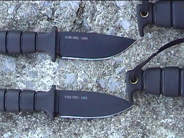

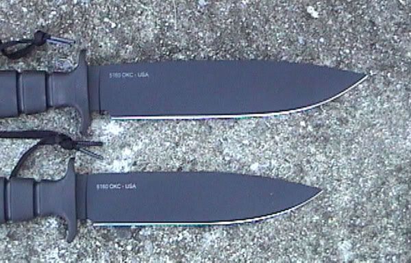

Here are some closeups of the blades.
General impressions:
All blades are ground to a distal taper, which helps to lighten the blade and adds to its flexibility under stress. The knives come sharp enough to cleanly cut paper, but not quite shaving sharp. While the knives are of excellent quality for the price, the sheaths leave a lot to be desired. The larger sheaths are nylon with a plastic liner to keep the blade tip from poking through. However, the knives fit much too loosely in their quasi-military sheaths (they actually rattle audibly). As for the smaller knives, their sheaths are built from sheet metal in the back that wraps around the bottom of the nylon front. This should keep the tip from poking through on the 5 blades the sheaths were made for, but fall short on the 3 ¾ Gen II blades (but at least they dont rattle). I think the smaller knives would do better in an entirely different type of sheathperhaps a pouch type as one finds on a Finnish puukko. Dan tells me he is planning a total revamp of the sheaths next year. In the meantime, those of you who know how easy it is to make a kydex sheath, such as those who attended one of my knife making/martial arts seminars, ( go to: http://www.pekiti.com/photo-gallery.php and click "summer camp" to view samples from attendees) can make a better version for your knife in about half an hour.

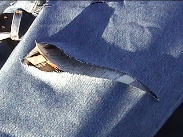

Test 1. Cutting through clothing in a defensive situation is more difficult than cutting through skin or muscle. Therefore I took an old pair of jeans, stuffed them with a roll of newspaper, hung the jeans up, so that they could swing freely and hacked away. I tested both of the longer knives in this test and both easily made deep cuts nearly the full length of their blades.

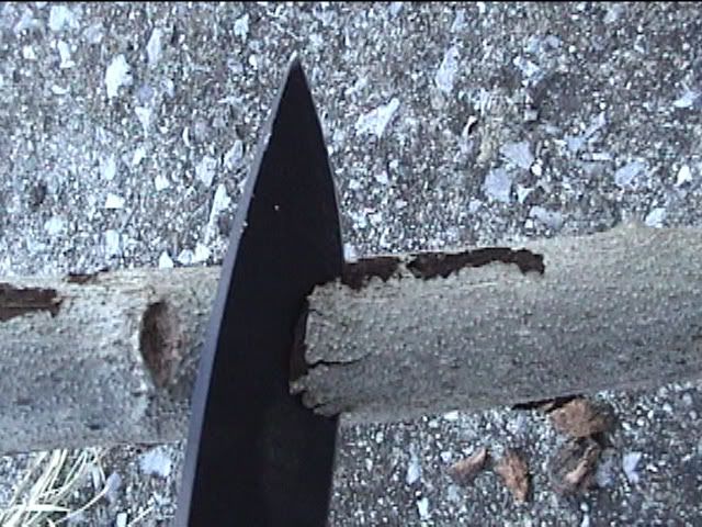

Test 3. To test tip strength I stabbed all four knives into a seasoned 6 diameter oak log and then pried the tip out (oak is of similar density to bone). I tried this test on both the end and side grain and none of the blades broke or bent on this test.

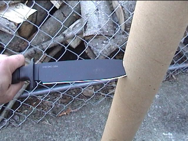

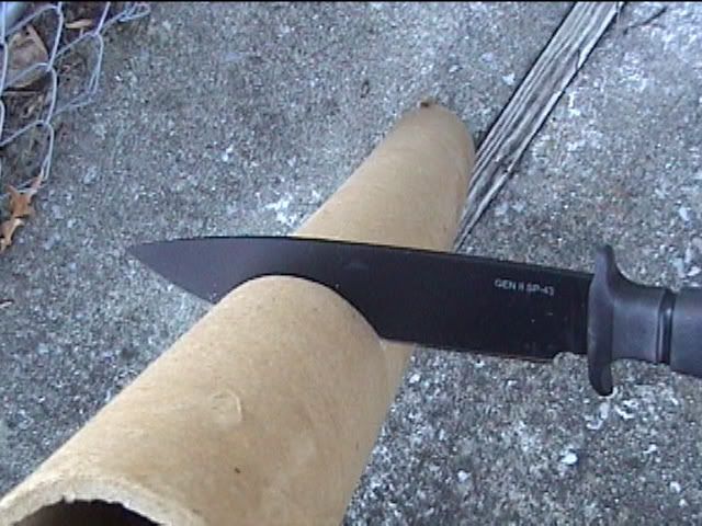

Test 4. The test medium here was a 4 diameter x ¼ thick cardboard tube from a carpet shop. I saw these tubes used in the class of Bando master Dr. Mung Gyi and liked the idea (and most carpet stores will give them to you for the asking). For this test I stood a cardboard tube up so that it was free standing and made a quick cut with each of the larger knives. Both bit deeply and held, rather than sending the tube flying, as a blade with poor edge geometry would. I also stabbed each knife into the tube, with the same good penetration with the thin, pointed blades. Again, I wanted to see good penetration without sending the medium flying away and both knives did their job well.

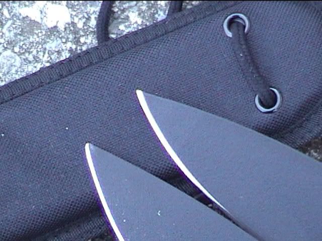

Test 7. Sharpening. I used three sharpening methods, a diamond dust coated rod, a ceramic rod and flat Norton stones-using a different method for each knife. As I expected with these carbon steel knives, the blades sharpened right up quickly and easily.
