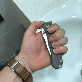

I believe this is more of a technique issue than a knife issue, and here's all you need to do in order to correct it...
1. Squeeze the BOTTOM of the knife, NOT the top. The biggest problem with opening a Zaan is that when you are squeezing the knife with your index and middle finger you are putting pressure on the clip/lockbar. The trick is to grip it more with your ring and pinky fingers, as that takes the majority of the pressure off the lockbar. You don't need to crush the knife to open it; just hold it in your last two fingers with enough pressure that it doesn't drop to the ground, and...
2. Push the thumb stud in a straight line along the frame. The Zaan does NOT open like a Sebenza, where you push out and around in an arc. In order to open (or flick it), you need to follow the line along the frame and push in that straight line.
If you do those two things, your Zaan should never be a problem to open regardless of the shape or size of your thumbs.:thumbsup:
