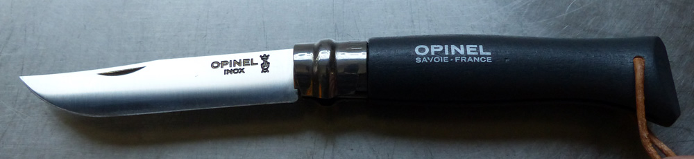

I’ve just got my first Opinel, #8 in stainless steel. This knife has been praised as a great slicer despite its price and outperform any modern knives in slicing. I wanted to experience it myself.
I got one with a blue colored handle and leather lanyard.

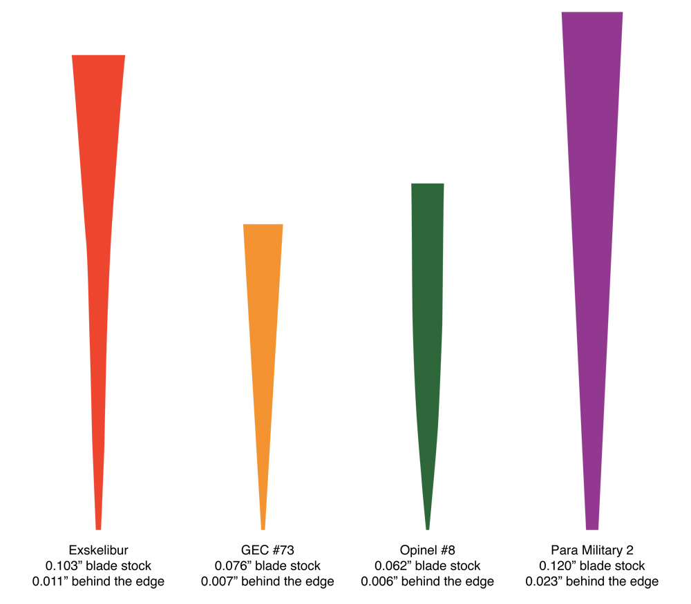

I was a bit surprised that the blade is actually convex but not full flat ground. Also I was pleasantly surprised that the blade stock and the thickness behind the edge is very very thin. Below is my measurements and comparison to other knives I own.
*Note that the blade stock measurement of PM2 was not done at the thickest point.
The edge came little damaged, so I could not test it before sharpening it.
I am very much looking forward to testing it against Boker Exskelibur I on light slicing tasks.

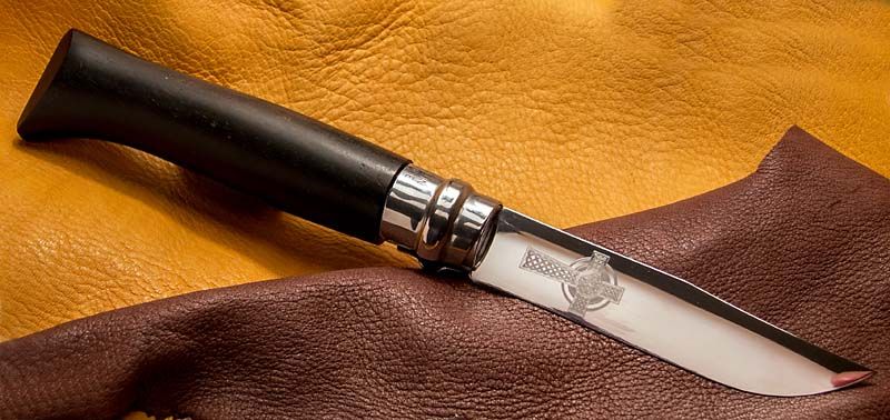

Nice, they are great slicers, here's one I use to own that I opted to have it engraved before they shipped it out, they did a nice job and they did it in a day and shipped the same day!
Handle on this one is Ebony, very solid feeling folder.

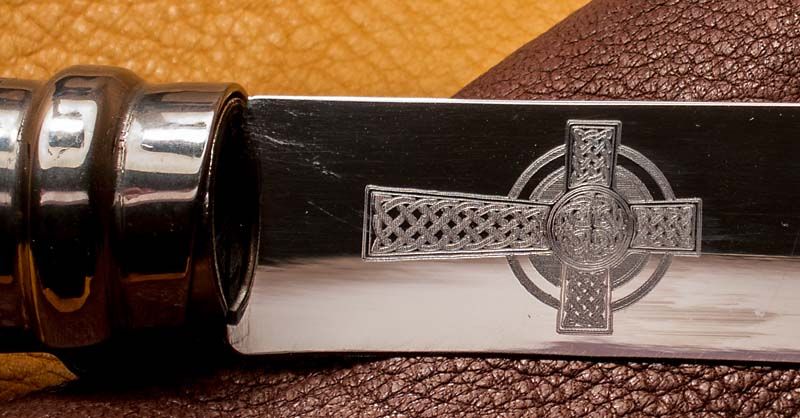

closeup of the celtic cross

Specs
Opinel #8: 0.062” blade stock, 0.006” behind the edge
Exskelibur: 0.103” blade stock, 0.011” behind the edge
PM2: 0.12” blade stock, 0.023” behind the edge

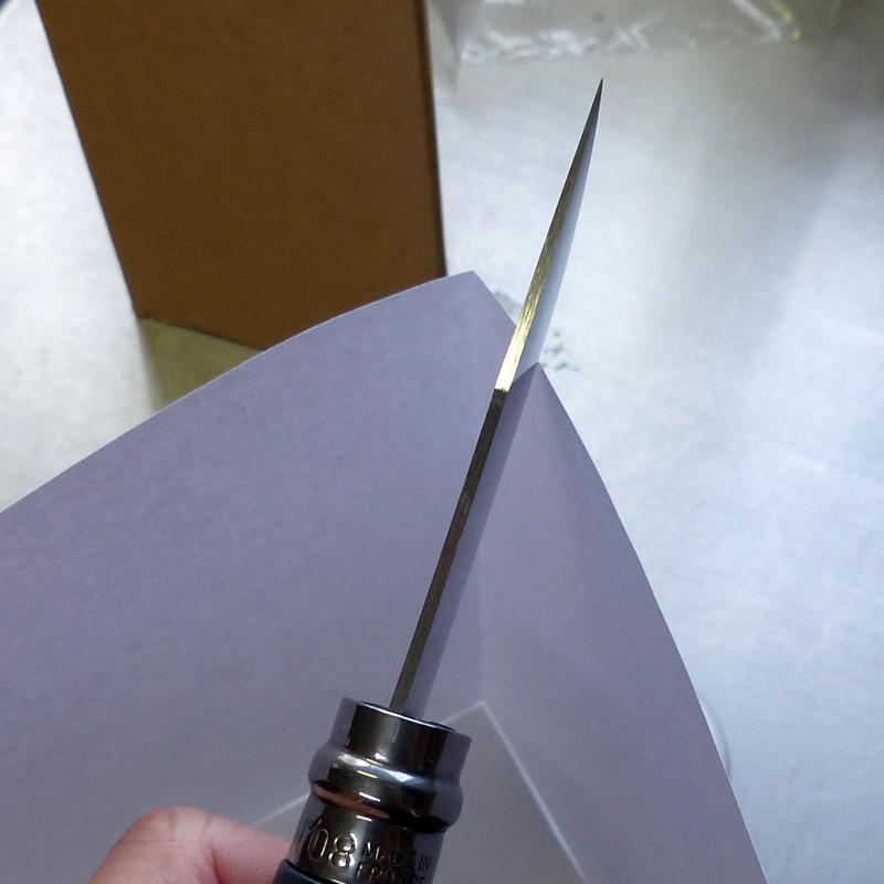

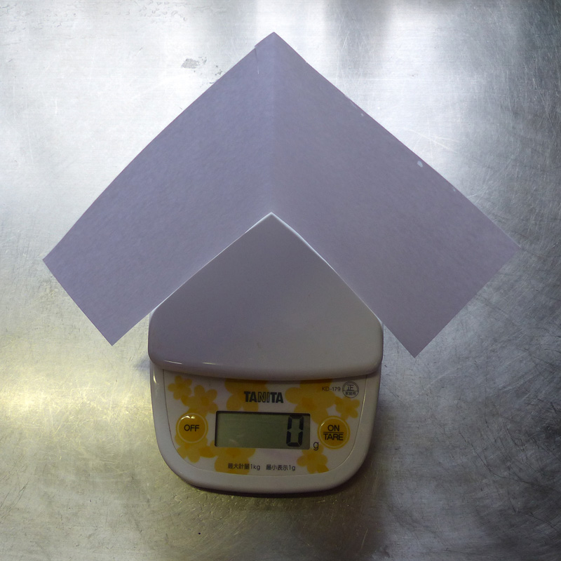

My thought was that a good slicer would require a small force to cut through a dense material like cardboard with good edge sharpness and minimum binding. So, my plan was to set the edge sharpness somewhat similar across the knives tested and to investigate how much binding would occur in cutting cardboard by measuring the force required to cut cardboard with a certain cutting angle. I averaged values from three measurements.
I first tested the edge sharpness by cutting printer paper and measured the force required to cut it.
I tried to cut the paper with a certain horizontal angle to the paper and with about 30 degree vertical angle. Hope that the image convey what I was trying to do.
This way, the blade geometry and binding of the medium would minimally affect the force required to cut the paper, and therefore it would mainly indicate the edge sharpness. The force each knife required was:
Opinel: 0.7 oz (20 g)
Exskelibur: 0.6 oz (17 g)
PM2: 0.6 oz (18 g)​
These results suggests that the edge sharpness was similar across the three knives tested despite their different edge and blade geometries.

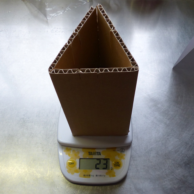

Then, I cut a piece of cardboard folded to a triangle pole. When cutting, the blade was placed perpendicular to the cardboard, and I held the knife with about 30 degree vertical angle. The force was measured when the blade sunk into the cardboard about 0.5 inch.
Measured values (averages):
Opinel: 28 oz (the entire blade was in the cardboard)
Exskelibur: 25 oz (27 oz when the whole blade was sunk)
PM2: 34 oz (42 oz when the whole blade was sunk)​
These results indicate that Exskelibur I is the best slicer among three with Opinel as a close second. As expected, the thick blade stock makes PM2 a less efficient slicer than the rest.

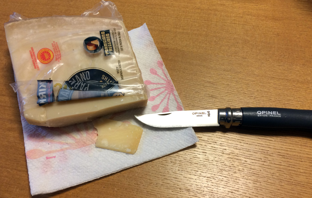

This French knife is really suitable for cutting hard Parmigiano Reggiano.

This is a great photo to illustrate the difference in geometry between Opinel and most production folders on the market, thank you very much for presenting it :thumbup:
Thanks, chiral.golim!
The blade is really thinly ground.
I wish other main stream production knives also have this much deep grind......
