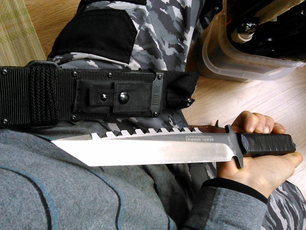

It's just that. I bought some "titanium coated" machetes and knives when I didn't know better, now they're all stripped, worn or just scratched and abraded after not much action at all. It's typical from Chinese junk and pot steel cheapos
Just wording to appeal to younger audiences

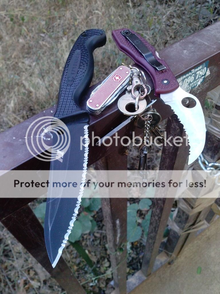

The true good Titanium coating is the TiN that Spyderco and others use, that's a true winner IME and I love it!
I've only managed to put a tiny little scratch on my Aqua Salts' coating
