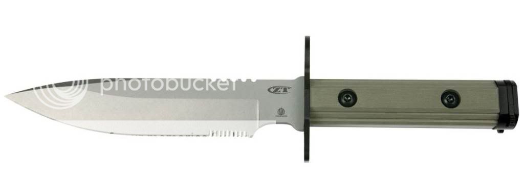

Any opinions\reviews on those two ?
Looking for a new , high quality , versatile combat fixed blade
I love the ZT folders , but doesn't have any experience with their fixed blades
I know the 0100 is basically a fixed blade version of the 0200 , and know nothing about the bayonet
How is the CPM3V in general , and comparing to the S30V on the bayonet?
Thanks

  • Blade – Full Tang S30V stainless steel, 7 ½ in. long,¼ in. thick, non-reflective, stonewashed finish
  • Scales – Textured G-10, Ranger Green
  • Muzzle ring & latch plate – 4140 stainless steel, black-oxide coated
  • Overall length – 12 5/16 in. (31.27 cm)
  • Weight – 1 lb. 3.4 oz. or 1 lb. 15.2 oz. with sheath
  • MSRP – $325
  • High-impact polymer sheath withballistic-nylon harness
  • Sheath can be worn in the drop-down position, on a belt, or attached using the built-in slots.
  • ZT-9 fits M16A1 • M16A2 • M16A4, Most AR15 • Israeli Galil ARM • Mossberg 590
