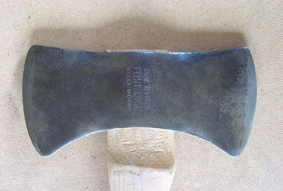

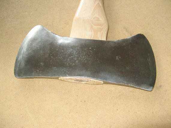

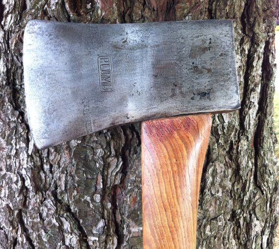

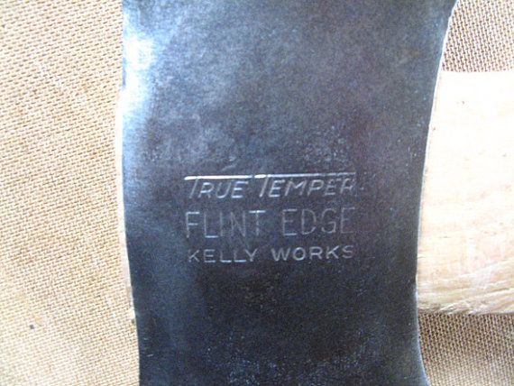

I would like some opinions on my two new vintage axes, one is a plumb boys axe and a kelly double bit
Hey, that looks like my Plumb. Nice.
They both appear to be in excellent shape.
In fact... I have the exact same pair of axes, but my DB isn't hung yet!
I think that what matters most is that it's tight. The handle protrudes through the top - can't get it further on than that unless there's concern about the kerf/wedge depth. Someone with more experience might weigh in here.
If you hold on and whack the bottom of the handle with a mallet and the head doesn't move further onto the handle, then it's as deep as it's gonna go as-is.
I think you should consider re-hanging your double bit. I should be near the shoulder of the haft. You will put a tremendous amount of torque on the 3.5 head when it meets a sudden stop in whatever you are cutting. There is a reason that the haft was designed the way it was. Just because someone took the easy way out hanging that axe doesn't make it correct.
You should be able to save that handle with a little work and use it again to hang it correctly. Sorry for the rant, it just trips my trigger when I see a half a$$ed job on any tool.

Just helped me ID a double bit I picked up at a flea market a couple of weeks ago. Thick paint obscured most of the words. Looks like its going to be like yours, just not as pretty.
