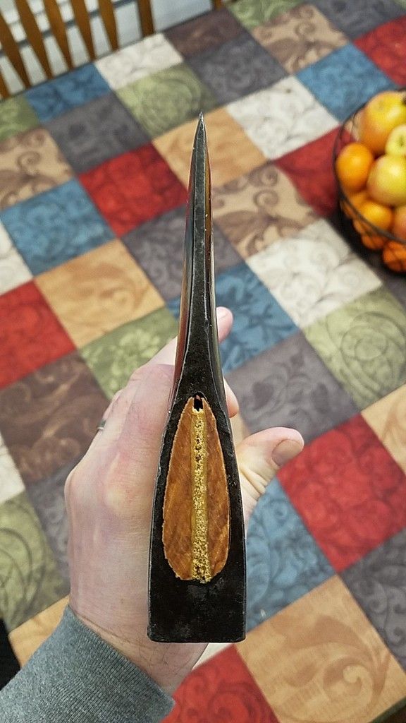

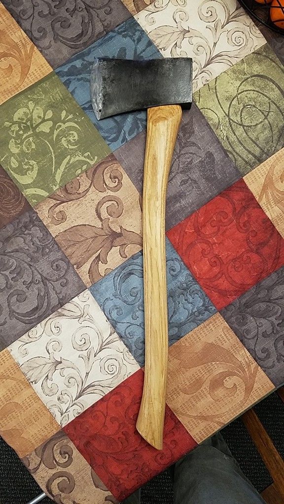

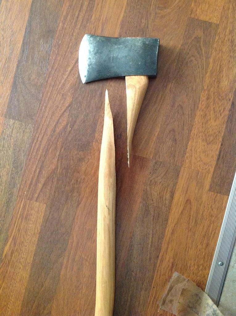

I cleaned, sharpened and rehung a Plumb boy's head on a new handle with perfect grain alignment. It left here and arrived to the buyer in great shape with no flaws. The buyer reports that after a few minutes of light use the handle broke against the grain and wants a full refund including a shipping refund. I have no evidence to refute his report, but the tool had a new, crack free and perfect handle. Part of me resists the idea that I should hold the bag and eat this. I don't mind allowing a return. I'll lose money and effort (handle cost, shipping etc.) on this which is fine but I feel like I did my part and delivered a good USED tool. Should I be expected to be the only loser here?
I am not fishing for people to tell me that I am right. I think that I am, but if I am not I want to hear it. Thanks.
This is what I delivered.
And this is the pic that I was sent.
Yeah, what's with the endgrain there, it doesn't look so good. Do you guarantee your work and materials? If so, then as you said, you should re-do the job, since you said you have no reason to doubt the buyer's story. If he doesn't want to send back the piece, then the guarantee doesn't cover him sending it anyone else for a re-do. Cost of shipping should not be refundable. The big factories don't even cover cost of shipping for warranty work. Why should you? Anyway, all internet transactions have their risks. The only time shipping is refunded is if the seller sent the wrong item or something like that.
Who warrants a handle? You break one you break one I thought. It looks like that one may be ash? If so they a not quite as forgiving as hickory but an over strike can break any of them.

Could you clarify what you are referring to as far as problem endgrain?

From what I can see that piece of wood was #1 select but you do have to realize there can be circumstances beyond your control whereby the sawlog tree struck the ground (or a rock or fell over another tree) rather hard or twisted severely which invisibly weakened the wood bonds. I think the term for this is 'shake'. The physical break looks to be the result of tugging upwards overly hard on a stuck blade but the handle shouldn't have 'let go' this early on in the game. Something else to consider: esteemed forum member Hickery Holler quinton clearly demonstrated that air dried hickory doesn't break cleanly whereas improper kiln dried, which can become brittle, does. What was the origin of that piece of wood?
In this particular case you bite the bullet and apologize and be thankful to get that lovely axe head back.
It is noteworthy that vintage Plumb handles were stamped or labelled with the words "tested" and perhaps this is something you (and all of us!) ought to consider doing before releasing any new hangs. Bury the blade in a stump and pull hard in all directions before final setting/trimming of the wedge and before 'signing off' on the job. Dem's the breaks, but better that they happen at home!

You got a bad stick of hickory. Ask him to cut it off and send it back for a full refund of his original costs (he pays shipping back but original shipping is refunded). Then re-hang it and sell it again.
