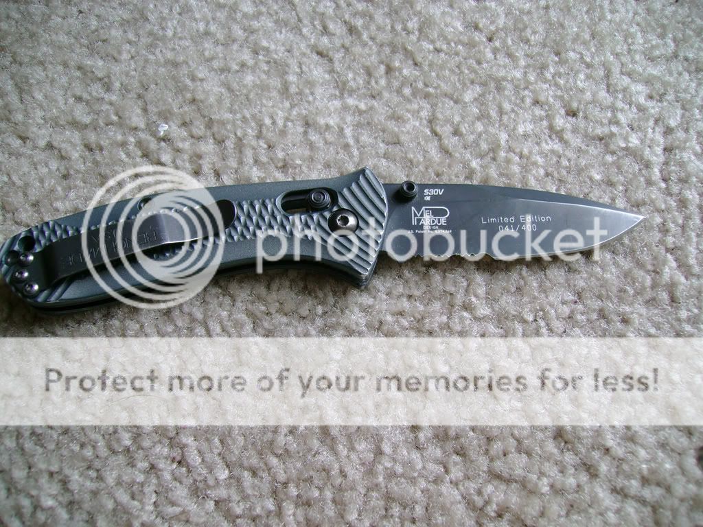

Ok, so a little background info:
I have an older Benchmade 941 red special edition, with the Boron (BC1) coating and it's bombproof. Unfortunately, for some reason, Benchmade stopped making it. Maybe it was radioactive or something. Anyway, I also have a Kershaw with their DLC, Diamond Like Coating, and it is very nearly indestructible. I also have a new Benchmade 943 with a black coated blade. I took it apart to polish up the pivot surfaces and make it open smooth as butter, and I was surprised how easily the black coating came off. I'm probably going to sell the knife because I'm EDCing fixed blades now.
If I were a collector, I wouldn't hesitate to get the BK coating. If I was going to edc the thing and use the hell out of it I would enjoy the BK coating and if it ever got so bad that I just couldn't stand looking at it, I'd just steel wool it off. BTW, Benchmade will replace your blade for a very small fee.
