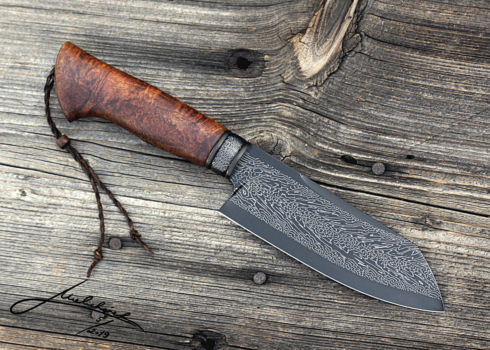

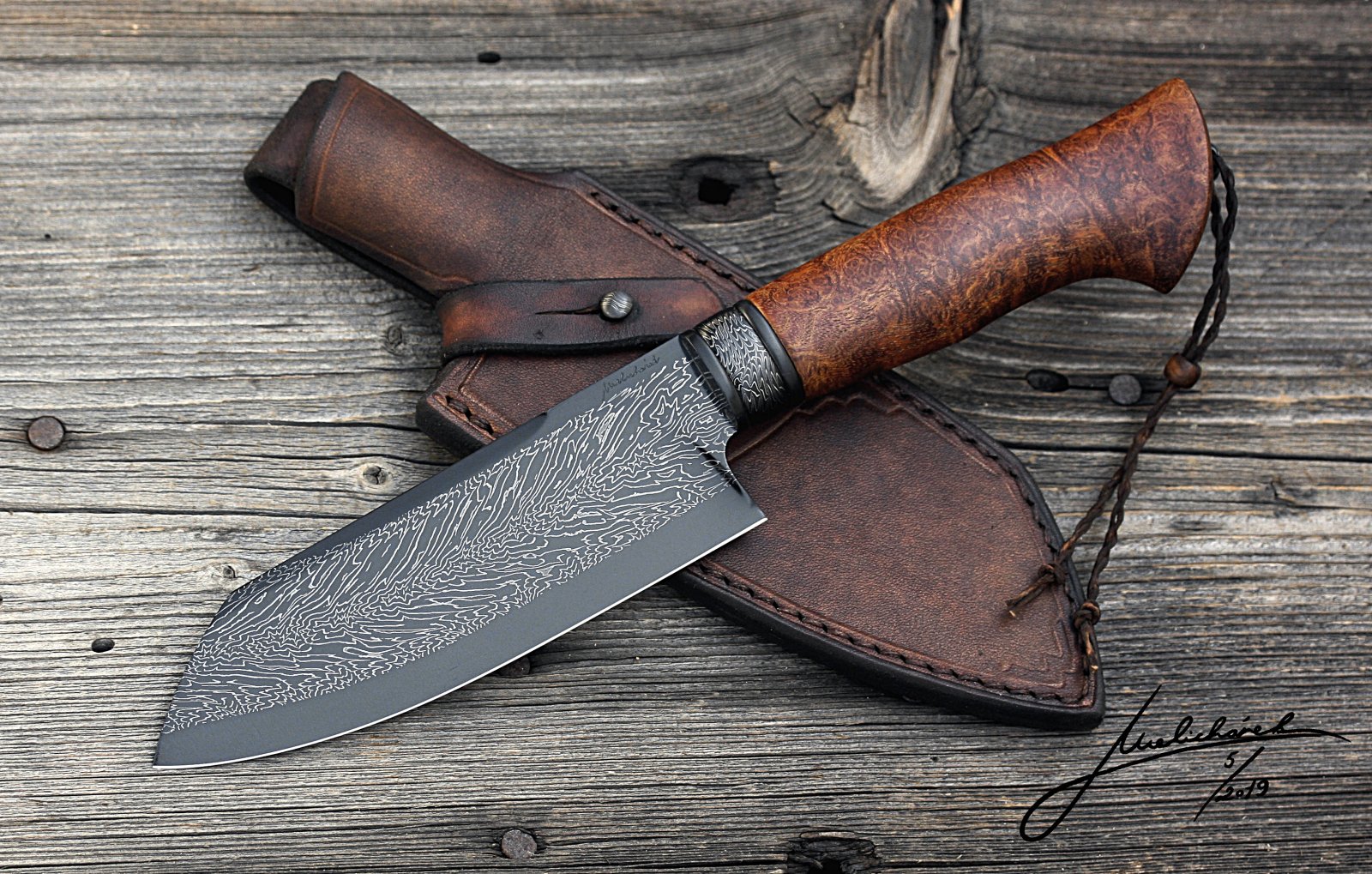

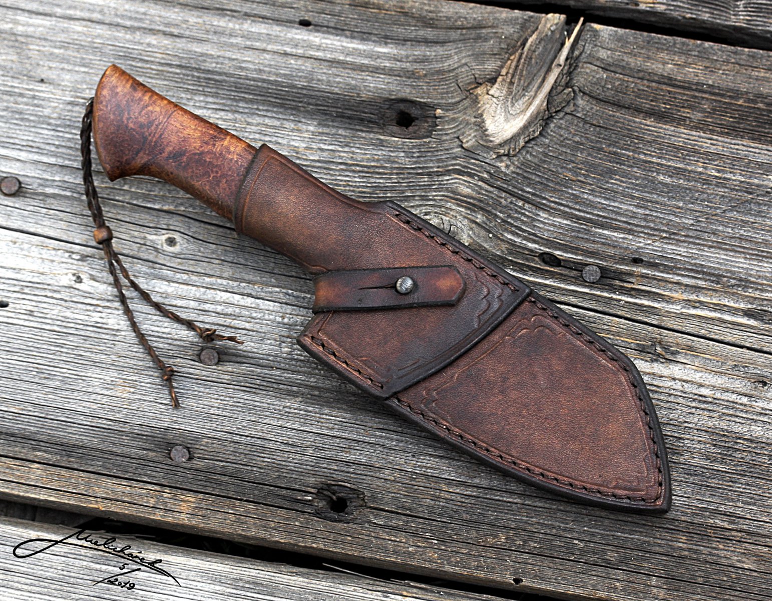

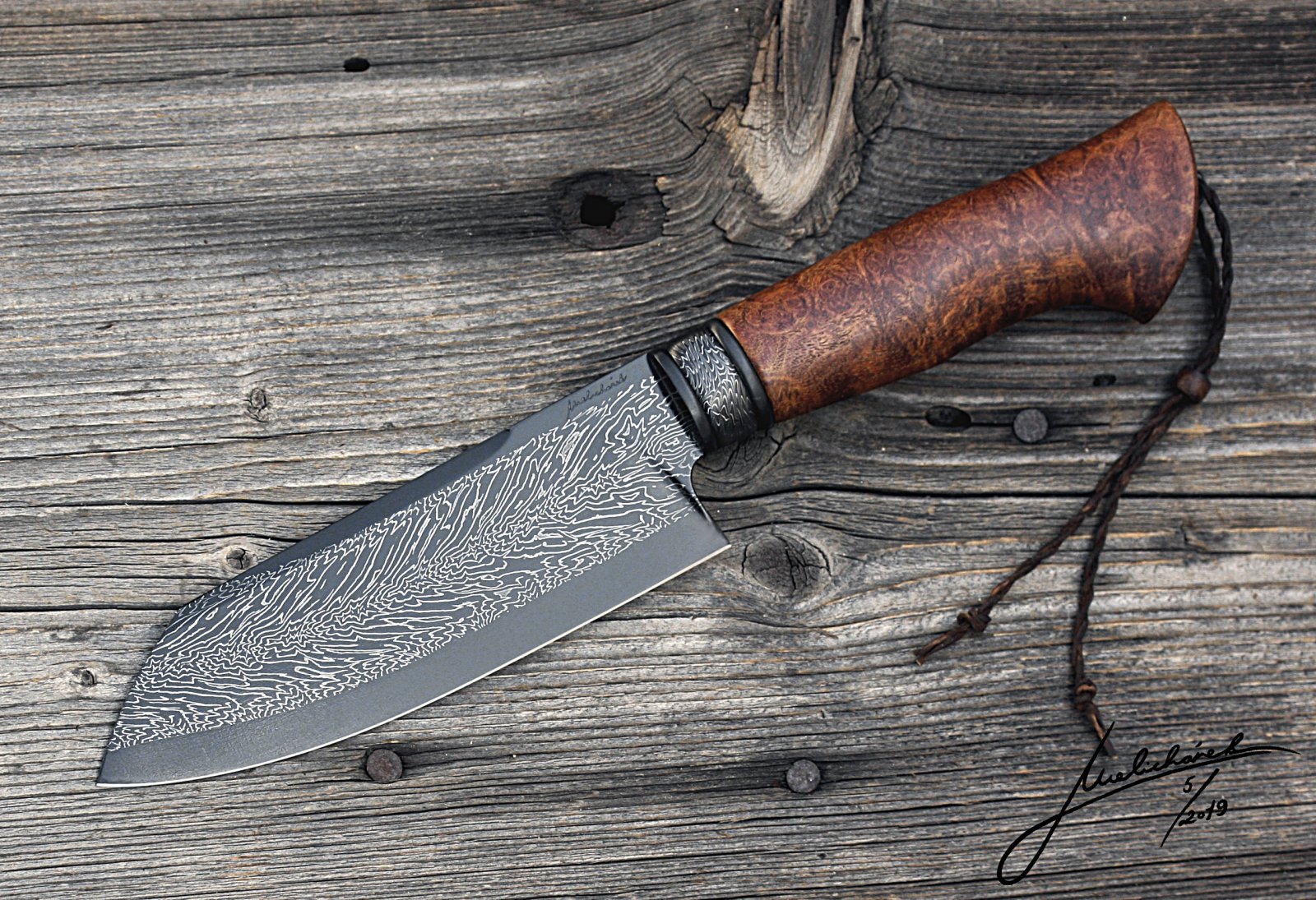

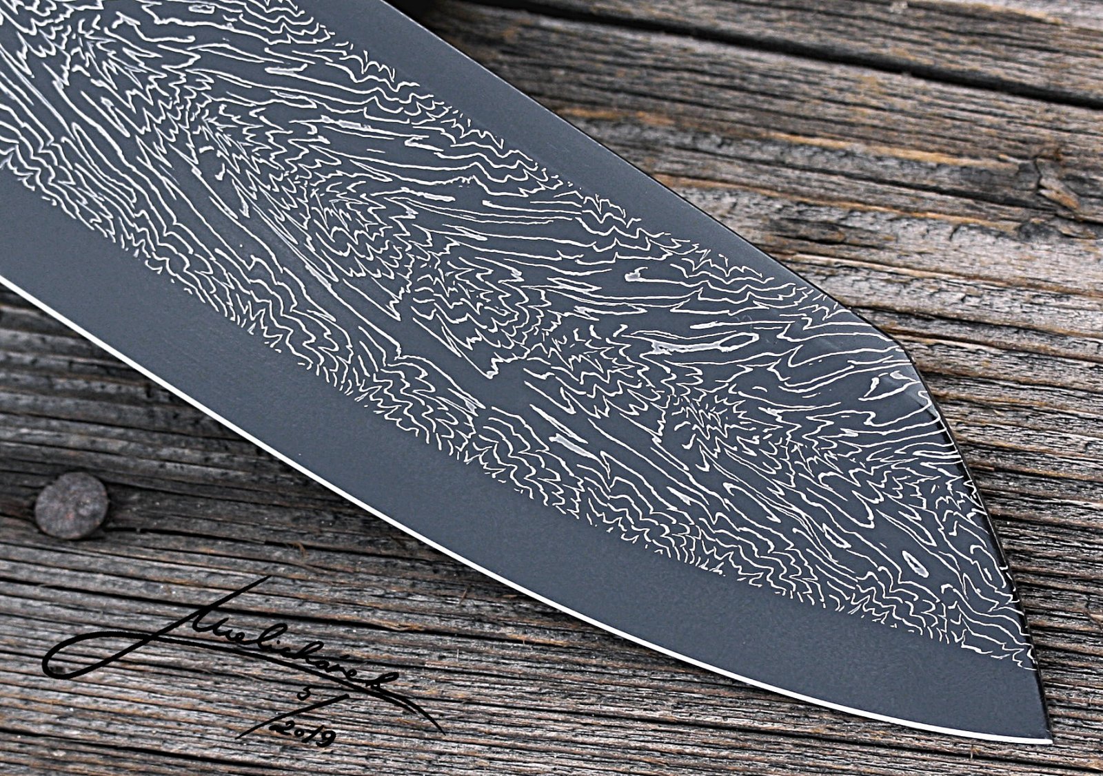

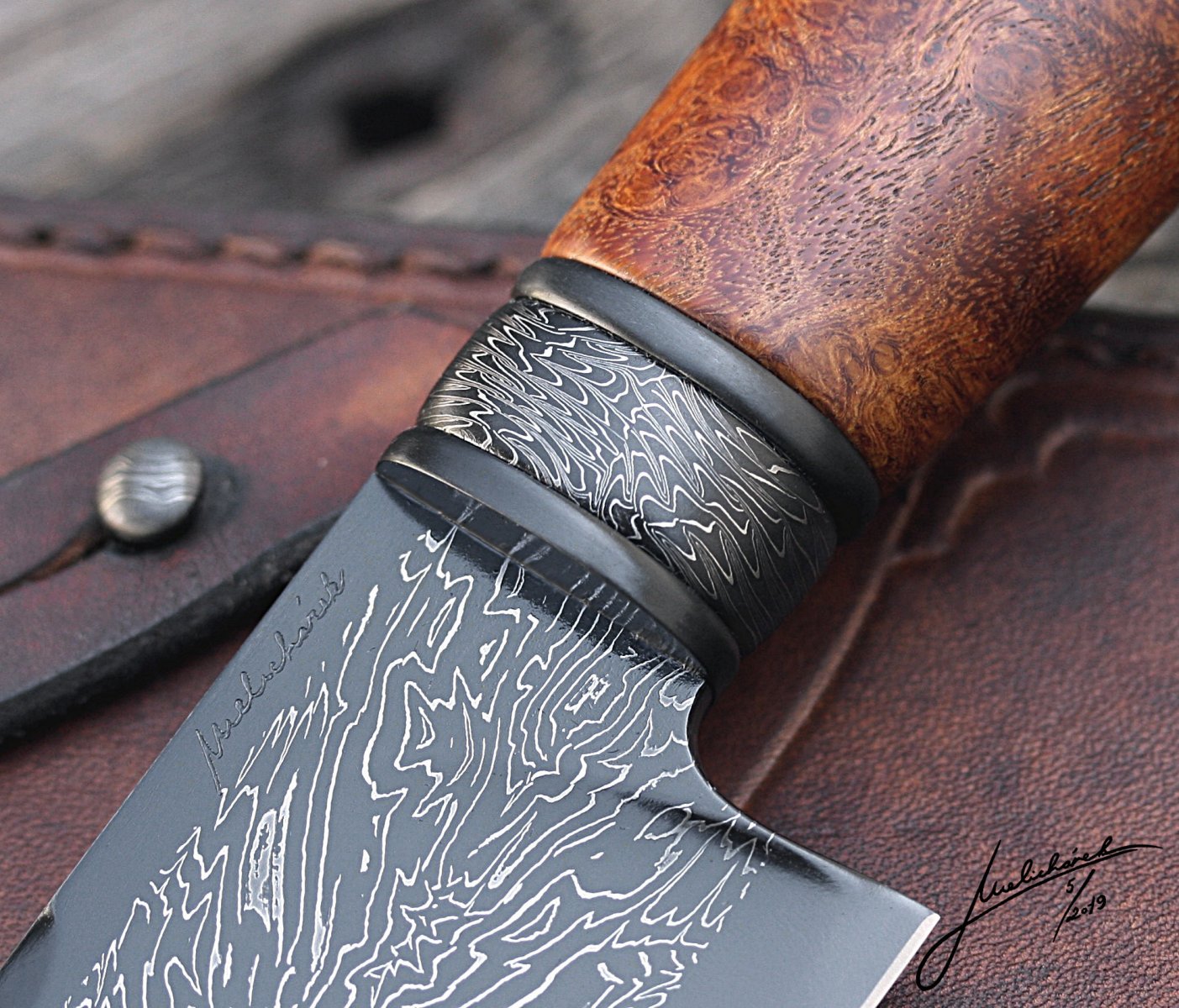

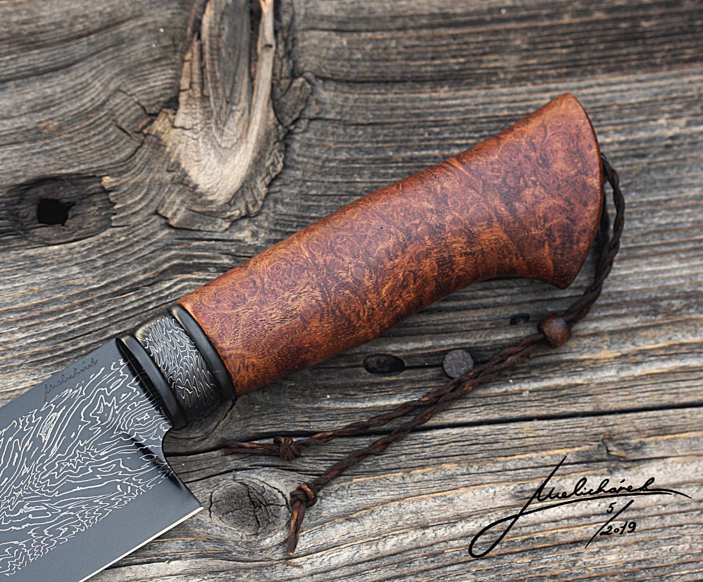

Hi everyone
Today i finished this knife. It is ment to be some kind of kitchen-outdoor hybrid, by customers request
See you with more knives soon, Petr
OLPRI

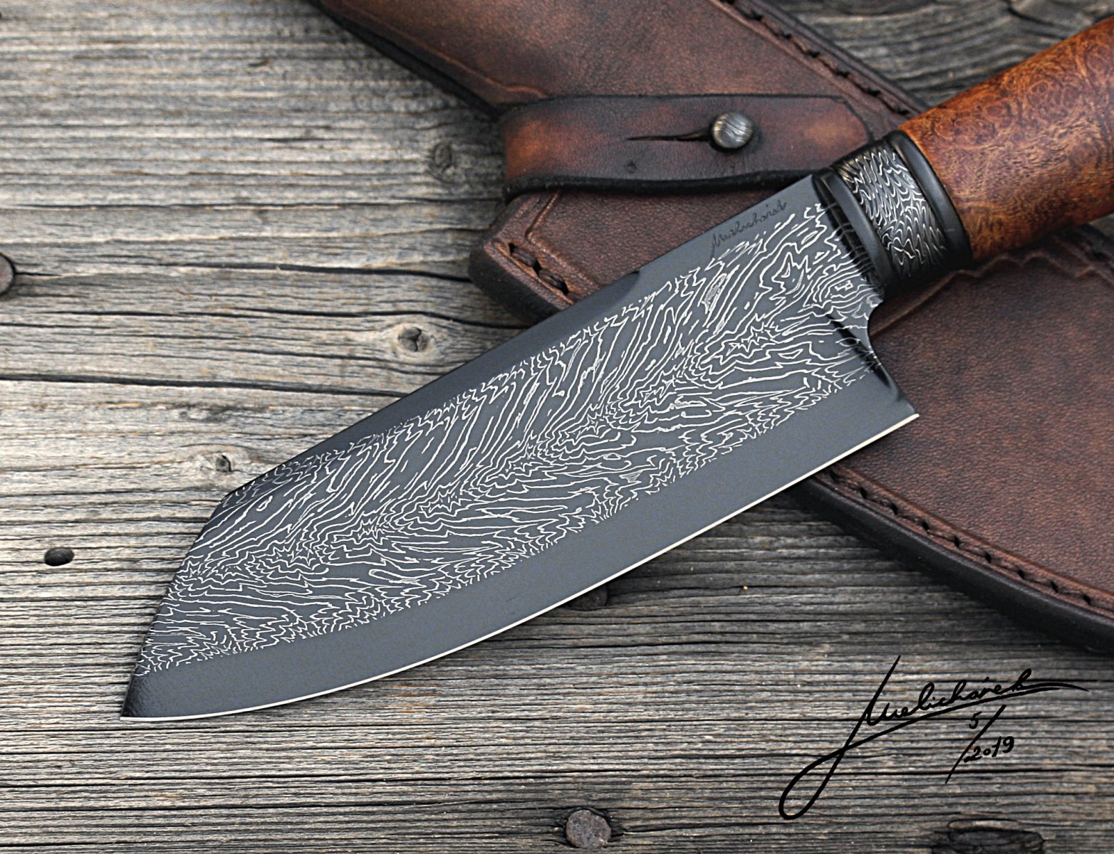

Blade - twisted damascus steel 1,2842 (O2) + 75ni8 Uddeholm (15N20) , added edge and spine 1,2842 (O2)

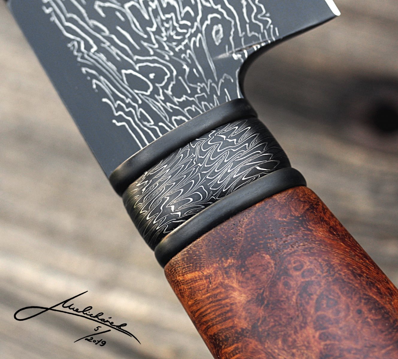

Guard - damascus steel 1,2842 (O2) + 75ni8 Uddeholm (15N20), rings 1,2842 (o2)
Handle - Black locust burl
Average length - 29 cm (approx- 11,42 inches) , blade - 15,5 (approx- 6,1 inches).
Blade width at widest point 47 mm (approx 1,85 inches) , blade thickness 4,2 mm (0,165 inch).
