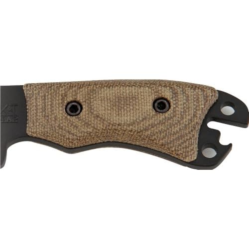

This was my first time working with RIT. I might give it another go for something a little brighter. Mirror edge is next. Some leather would really be nice.

I'll be interested to hear about the process that got you this color.
Also, for those of you that were trying to remember exactly what shade the stock micarta has, here you go.
That looks pretty darn cool. Definitely post up how you did it. I might have to try this with a different color if I ever buy myself an 11.
I did it by not following the directions at all.
1. Buy RIT Sunshine Orange Liquid Dye.
2. Lightly sand the micrata. Why? I don't know. It seemed like a good idea.
3. Get a paper towel and apply some RIT to it. Rub it all over the micarta. Let it dry.
4. Sand it a little more.
5. Apply a little more. Let dry.
6. Read some other threads.
7. By read, I mean pick out the part that said something about soaking it in hot salt water with some dye for 24 hours.
8. Heat up some water. Add a splash of dye. Drop in the scales.
9. Get impatient and take them out after about an hour. Run under cold water.
10. Dry.
11. Done.
If I were to do it over again (and I likely will with my fill sized micarta grips), I'd likely skip right to the soaking part. Concentrated RIT might have been a little much, but I still like the way it turned out.
And, yes. The color is fairly true. Maybe a little washed out in the pic. It really is a crap camera.
