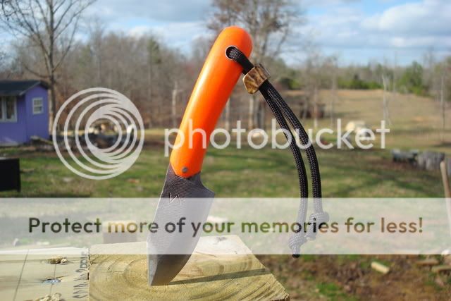

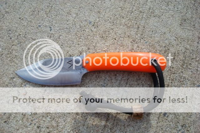

Hey everyone, this is my first post here, I'm new, and I wanted to show off my most recent project. I would be posting in the knifemakers area, but apparently you have to pay to be able post over there.
Specs:
Steel - Old nicholson file
Handle material - Vivid hunter orange homemade micarta
oal - 5 1/4" - 13.3 cm
Blade - 2 1/4" - 5.7cm
Handle - 3" - 7.6 cm
Weight - 2 1/4 oz - 64 grams
Lanyard - black paracord, with deer antler bead.
I finished the sheath today, and I'll be taking pics of it in a few minutes.

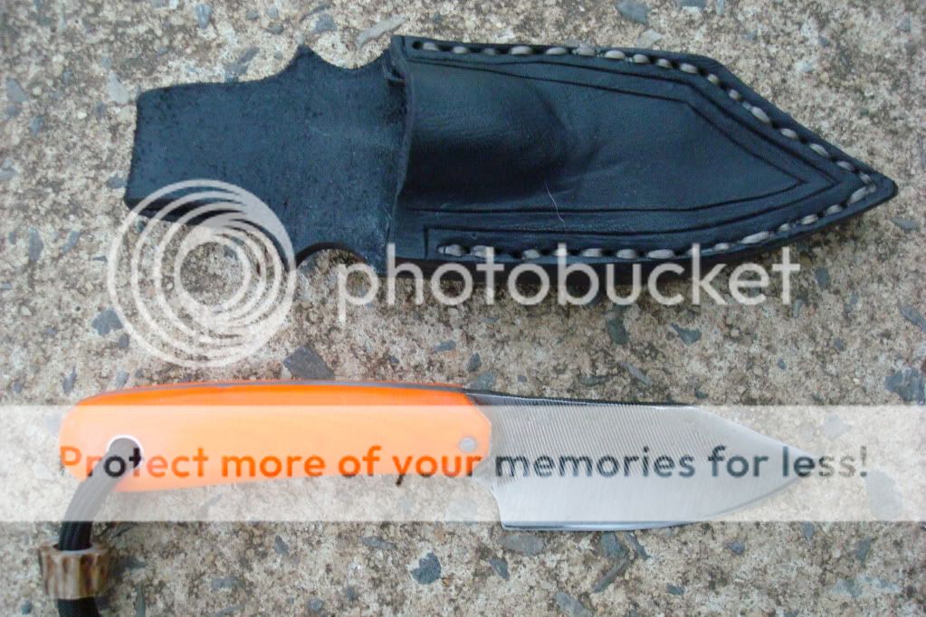

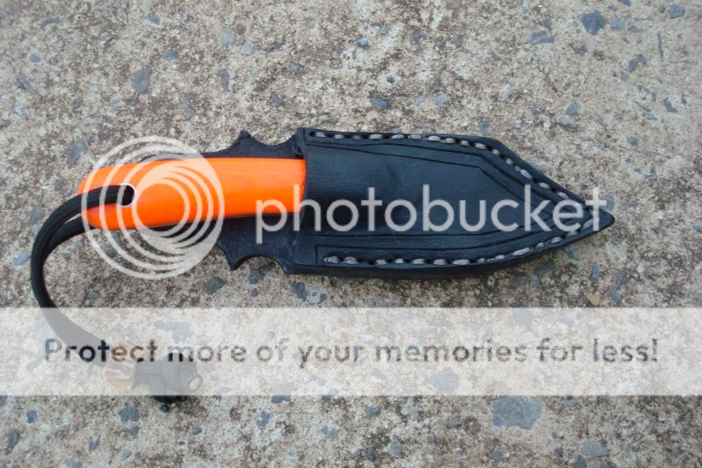

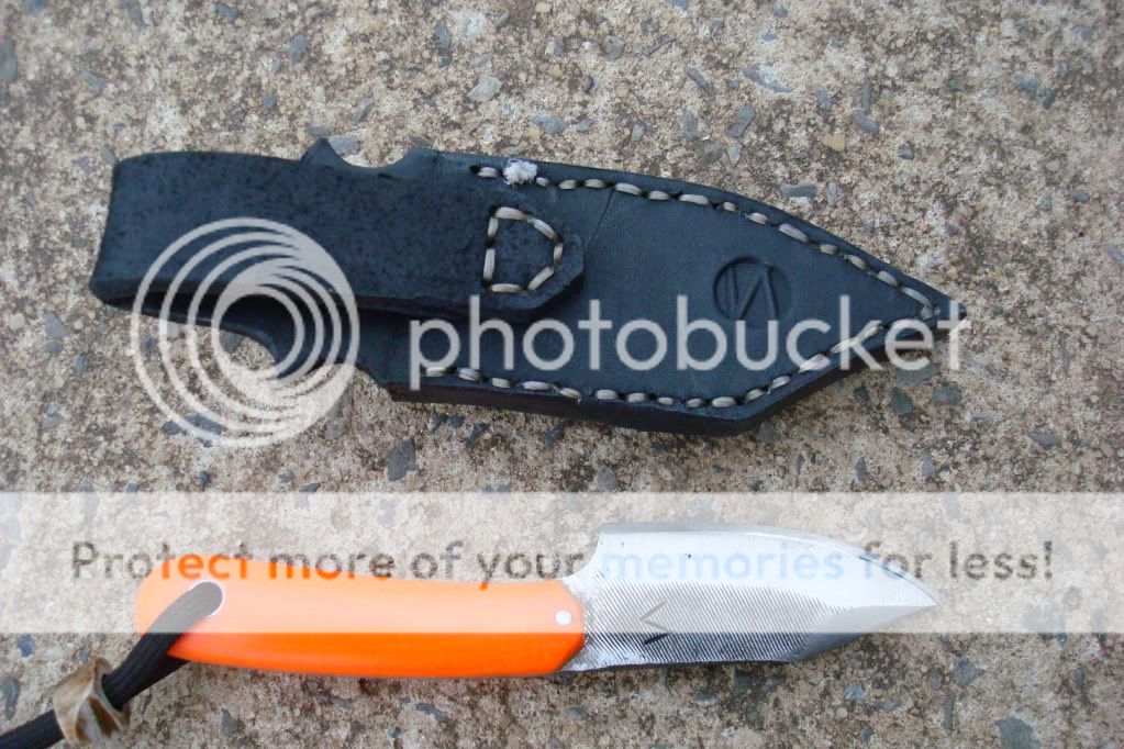

Sheath pics!
veg tanned chemically blackened with vinegaroon.
Lesson learned with this sheath, when you wet form a sheath, let it dry really really long before leaving a nice shiny knife in it for long. Insta-rust.

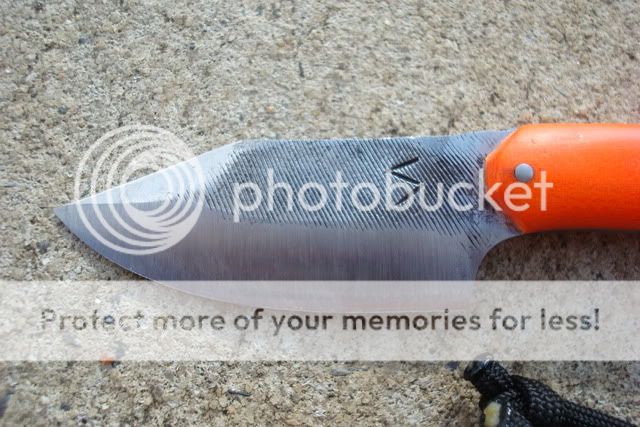

Thanks everyone, glad to hear you like it. I was worried people might not like the bright orange too much.
If you look at some of the closeups of the handle, you can see a defect or two, and those kept annoying me so I actually recoated the handle with super glue and resanded to get them out. Basically the same as before, just the little divots (i think that is what it is) are gone.
