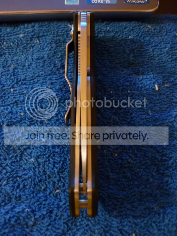

Well I got it today and it is grinding when I open it. There is no play in the blade though so that is a plus. I am thinking it just needs some oil so I will try that when I get home and hopefully that fixes the issue. I also noticed that the blade is not centered when closed. Is this normal for the cheaper knives?

If you've got the torx bits (good ones - the Chinese made Spydercos tend to have extremely stuck screws), then you can take it apart and check the washers. I got a Persistence for my dad for Christmas a year or so ago and mine was grinding. Took it apart and found that a tiny little sliver of copper (or phosphorus-bronze?) had been shaved off of the washers and was in there making things a little rough.
Took it out, cleaned it, lubed it with Lucas Assembly Lube (for engines) and it's been great every since.
Keep in mind that taking the knife apart technically voids Spyderco's Warranty (and if you strip a screw, you're pretty much on your own).
You can correct an out-of-center blade as well by following these steps:
http://www.bladeforums.com/forums/showthread.php/918247-Recenter-the-blade(framelock-linerlock)
Hey Wallbright! Congrats on your new Spydie! As others have mentioned, try making your screw adjustments to get the deployment action you want; if you still have an off-centred blade, try gently bending the entire frame when the blade is closed. My Persistence still has a bit of a lean, but it doesn't rub on the liners and works perfectly.

Thanks fellas! I used a few drops of mineral oil and the grinding stopped. I guess it had just been sitting on the shelf for too long? Idk but it doesn't grind anymore and opens flawlessly. I went to the link above and followed the directions and the blade centering is much better. It isn't perfect but it doesn't grind on the side anymore. I am afraid to mess with it too much as I don't want the screws to strip (knock on wood) so I will just leave it how it is unless it poses a problem. It kind of looks like the before picture now from the thread linked above. Should I leave it how it is or should I try taking it apart? I don't want to mess it up.

You don't have to take it apart, but you can try the above procedure again or even add the step (after you've shimmed the blade to one side) of putting pressure on the liners in opposite directions - basically pushing one liner towards the pivot-side, and the other one towards the bottom of the handle (making sure to push "up" towards the pivot on the liner that you want the blade to lean towards and "down" towards the bottom on the liner that you want the blade to lean away from) while you tighten the screws - if that makes any sense at all.

I'm not quite sure what you mean? Here is a picture of the knife. Do you think I should adjust it or just leave it?

That's up to you man. If it bothers you, you always have the option of sending it back in. If you're a do-it-your-selfer, you could try to adjust it again (again, if it bothers you - if it's not touching the liner and you're ok with it, then I'd leave it).
What I'm trying to articulate (and not very well) is that you can put pressure as if you were trying to slide both the scale and liner on the left-side (my left as I look at the above picture) up, while at the same time putting pressure as if you were trying to slide the right-side scale/liner down (again - my right in the above pic). Now when I say "pressure" I don't mean man-handle it to the point of trying to break a lug-nut loose, but you want to apply good firm pressure while tightening the stand-offs (I usually start from the bottom up).
If the stand-off screws are loose, this will push any slack in the stand-off holes and pivot-hole over enough to angle the blade towards the left-side scale. If you've shimmed the blade towards the left-side scale as well, then slowly tighten the standoffs (while applying pressure as described above) and it should move the blade quite a ways over.
Oh, and your pocket-clip is upside down :)
