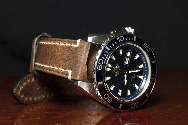

Some people like diver watches on thick leather straps.
That one looks good but it wouldn't work for diving.

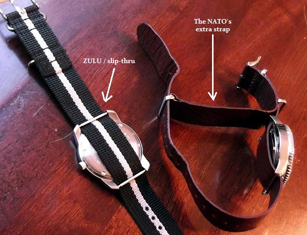

There are two different one-piece nylon straps that are called NATO straps.
The one on the right is what you bought. The keeper extension with the third ring is to keep the watch from sliding off the strap if you hang it on a wall hook. I kid you not. It is British MoD spec. If you were RAF, you might call it a G10 strap — G10 is the form to requisition something from supplies — or you might call it a NATO strap because it has a NATO supply number.
Someone though "hey, the watch isn't going anywhere and it doesn't need a keeper — but just to make sure, we'll use thicker nylon webbing." That's the strap on the left with two rings. Maratac called it a Zulu® strap and copyrighted the name. Other manufacturers call them "thick NATO" straps or NATO/Zulu.
None of these one-piece straps originated with NATO. Do I need to tell you where the idea came from?

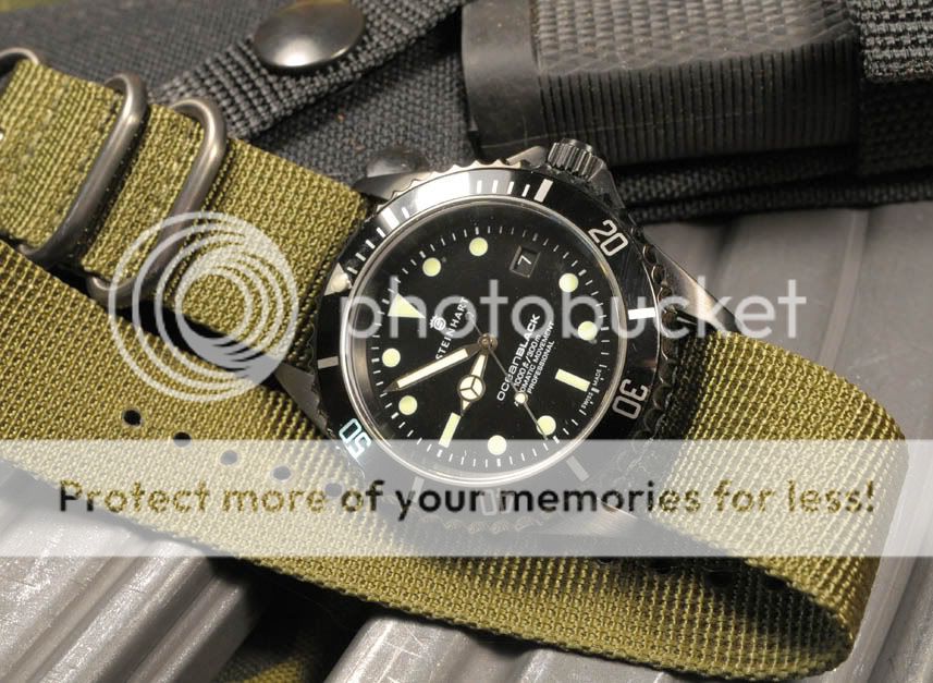

I like the ZULU straps better than NATO because they have slightly thicker material and bolder hardware:
