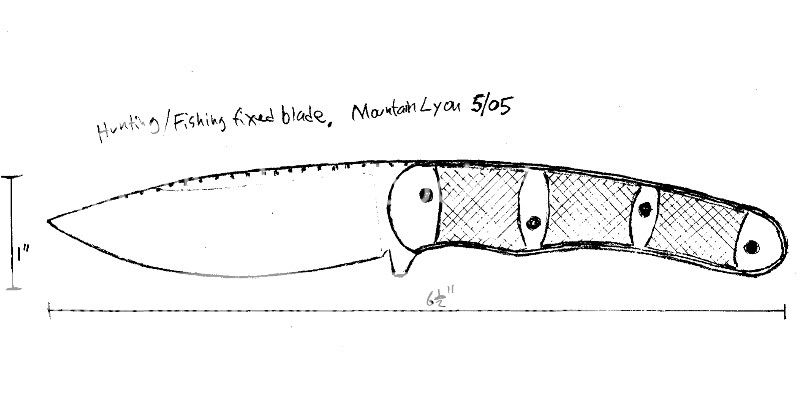

Hey folks, sorry a day late, that’s sort of on time for me. Here’s a small hunting/fishing fixed blade drawing, likely what I’d try to make first if I try to make a knife. Small and simple, sort of... If I try, it won’t be S30V, probably yard scrap like a broken mower blade or something. I drew this inspired by the curves of my Kershaw chive several months ago, I think I had seen a Buck mini alpha hunter also. I have since gotten a mini alpha, and it’s the same length I drew, 6 ½”, but the blade on my drawing is longer, thinner, and straighter, less of a skinner blade.
I like a short handle on a small fixed blade for keeping overall weight down in my pack. My index finger is often on the spine of the blade when I use it anyway, to keep from stabbing too far into the guts. Some file grooves on the spine for finger grip makes sense for that also. I definitely prefer fixed blades for grungy fish and game cleaning.
I found that my drawing looked somewhat like the Benchmade Snody 210 activator but different size and handle material, I like wood. The CRKT Ryan plan B is very similar in shape, but totally different purpose and materials. I find most bird and trout knives too thin or straight for my liking. I like the curved design for comfort and control, with a beefy enough blade to chop through heavy tendons breaking down a wild turkey at camp, and for cutting large salmon into steaks through the backbone.
This was drawn mostly freehand, so curves are not exact. The size gets changed when I load it on my computer, now it looks a little sloppy, I apologize. Supposed to be a 3” blade, 3 ½” handle, 1” wide, 1/8” thick blade, maybe 3/16” scales, 1/16” exposed tang around scales. I like checkered wood for grip like my rifle stocks, not too ornate to detract from the natural beauty of wood. Ovals left not checkered to show wood grain around staggered pins would look sort of like eyes.

I wouldn’t be surprised if there have been custom knives made like this, any I should check out? I don’t know why the curved shape isn’t used more.
That looks like a pretty sound design. You'll learn a lot when you make a model of it.
How did you plan on doing the selective checkering?
- Chris
Thanks Hesparus. As far as how I was planning to do the checkering, well, I wasn’t planning on making the knife to begin with, so I’m not exactly sure. I’ve done some wood carvings before, I’d guess that part might be easier for me than the steel work. Maybe I’d just stipple the grip instead like the grip on my old Feinwerkbau ten meter match pistol.
I don’t have as much time to read about knives on the computer/books right now, but I’ll start a new thread when I have time to scan and post the big self defense design. It barely fits in the scanner, I just checked. :^)
