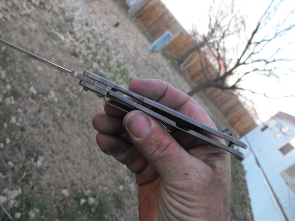

The lock on mine wore across the tang VERY quickly.
So, as I tend to fix issues myself, out came the punch, 3 pound sledge, and off I went to the 75 pound anvil.
Peened that lock-bar, and now it has a nice solid lock-up at about 50%. :thumbup:
It's now one of my brother's most used work knives. :)
