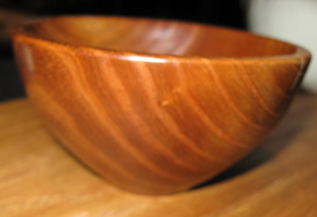

+1 on Mulberry. It is a close relative to Osage Orange. I don't see why it wouldn't be a good choice. Sorry for the picture quality, but hopefully you can get some idea of what it looks like:
Despite the photo, the grain and color are very much what it was in 2007 when I turned it. BTW, that's just a clear finish.
