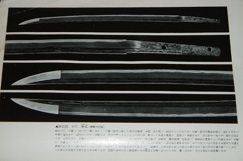

This is a piece that was inspired by a Japanese woodblock print that I saw that depicted a Fishmonger using a stylized slicing knife to cut up fish. Also the Osoraku style of Tanto played a part as well. It is chisel ground 01 with a hollow on the back for ease of flattening on waterstones. The flats on the bevel side were pickled and the tempering colors left. The handle is rayskin and Nylon fishing line.

It looks like this blade was broken and reprofiled as a utility knife.
But this Bou-shi(帽子) shape of nihon-to should be curved for fishing I think.
Filing center part of the surface is traditional and it is called 銑掛け(filing with sen).
It reduces sharpening amounts and makes well slicing, I'm glad to see this process.

Grinded spine is designed for scraping scales of fishes?

The spine treatment is only for looks, but there is a burnished 90 degree edge on the back that would work pretty well as a descaler. I wish I could remember where I saw the woodblock print. It was in one of the references in my teacher's extensive library. It stuck in my brain, Though!
