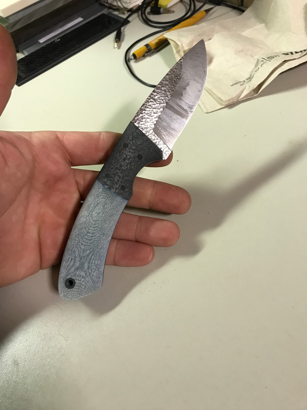

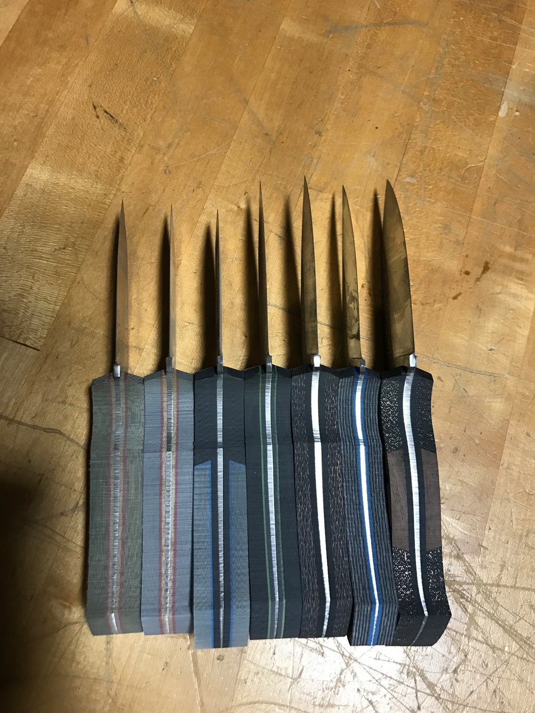

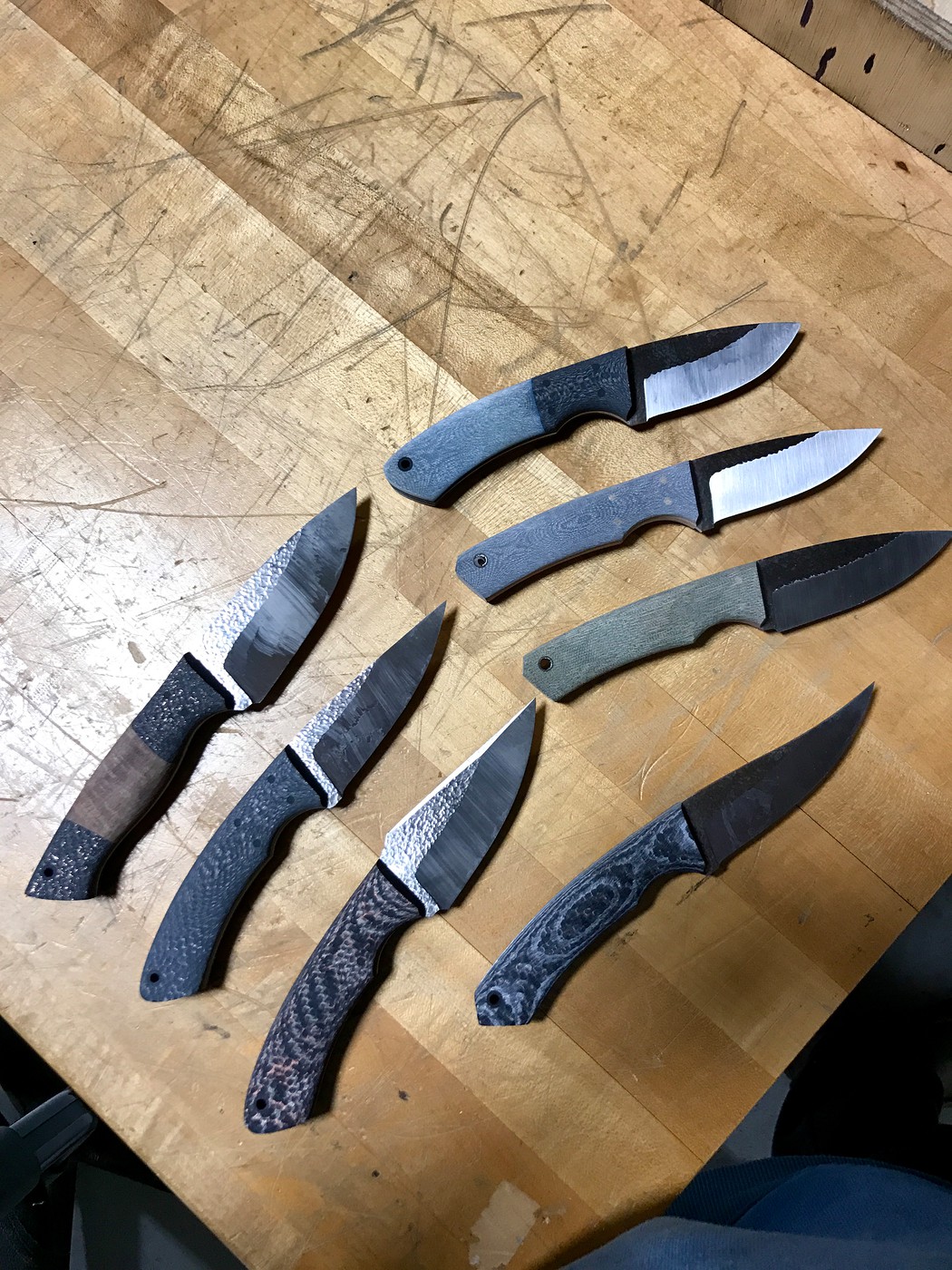

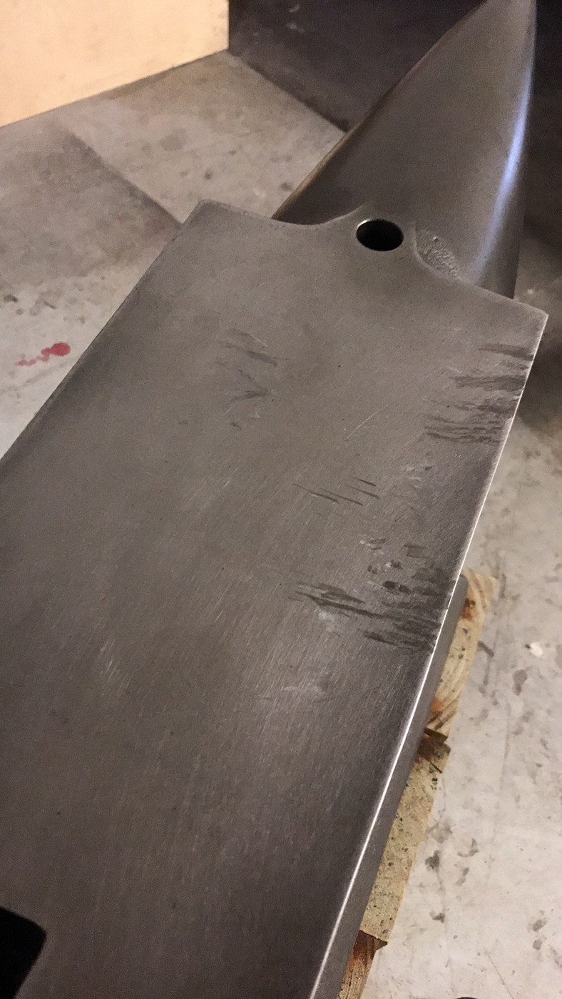

Here is what I am currently working on;
I started the next batch on Thursday last week, Sanding the flats on the knives prepping for texturing. I timed that I spend roughly a 30-45 minutes on each blade polishing the flats and hammer texturing. Once that is complete. I will wash the blade removing any oil, dirt, etc.. After the blades have been wiped down and dried. I apply a thin layer of Turco to provide and oxygen barrier to prevent decarburization. I learned by trial and error that Turco does not work for all stainless steels. If I use it on S35vn it will actually accelerate the decarb process. S35vn has to be heat treated with heat treat foil.

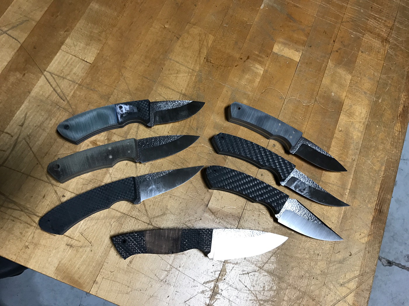

These have been washed after polishing then texturing and are ready for a layer of Turco.
Hosted on Fotki
Hosted on Fotki
Turco'd and ready to go in the oven
Hosted on Fotki
Fresh out of the oven, Heat treated and double tempered.
