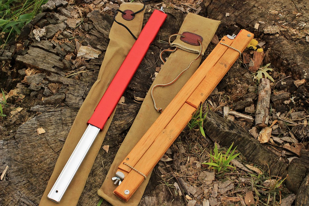

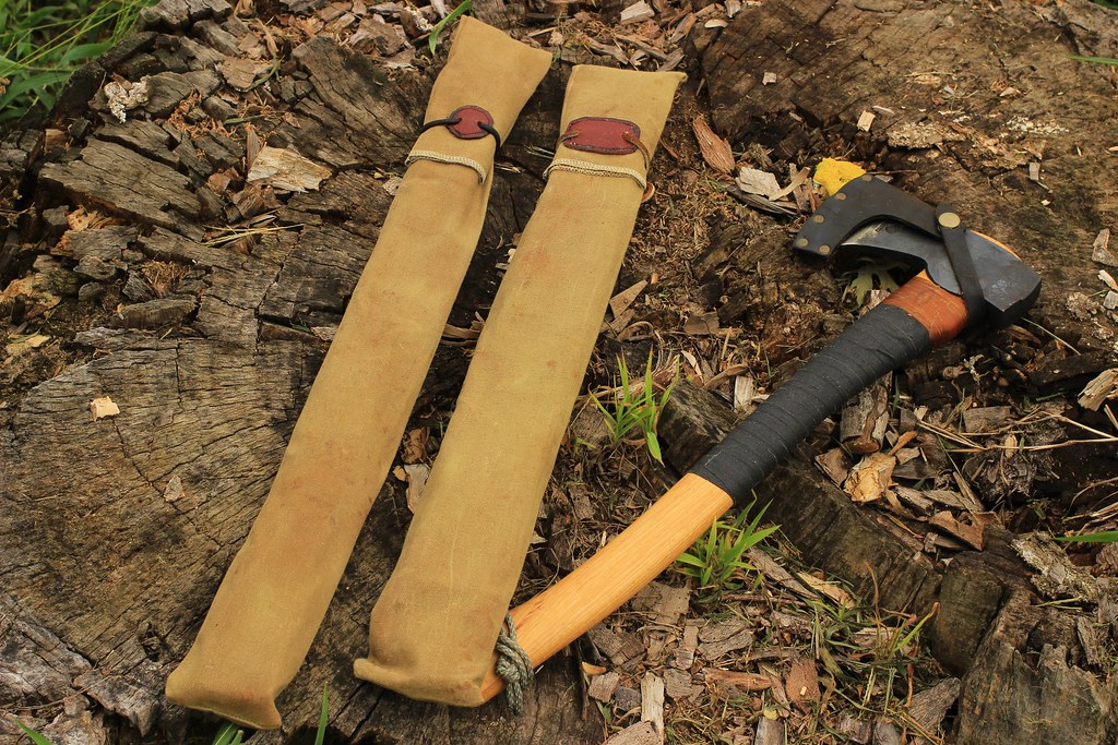

I've settled on these and been using them for a while now.
The Sven goes on pack trips. Not the best, but pretty light and gets the job done.
But if it's paddle camping and I want to be assured of a good campfire, It's this combo.
A "Fast Bucksaw" (made in Minnesota) and a Wetterlings. Makes getting a good fire going a pleasure.

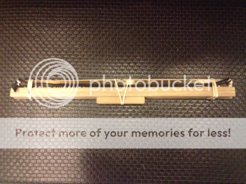

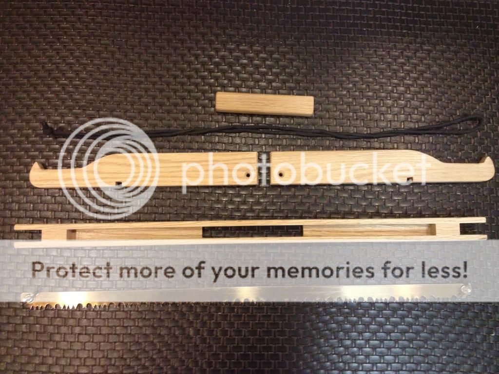

Well, last week, this thread was enough inspiration for me to get off my rump and do a project i have been planning and thinking about for longer than i care to admit. I made it from left over oak hardwood flooring. The screws and wing nuts are stainless and were also leftovers. I had to buy a blade. I chose the 21" over a 24 so it will fit in a pack a little easier. I picked up the blade at a local true value hardware for $4.99. Thats it, i got a whole 5 bucks into this thing. Here is the out come!
Bundled together, i think i may have to make a canvas bag similar to Tradewaters in post #9. All together like this it weighs in at 12.4 Ounces.
Exploded view of the pieces

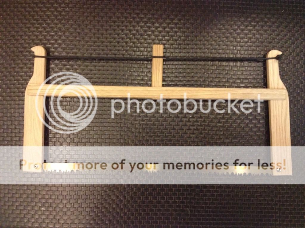

Ready to cut (it has about a 6" throat):
I only had time to cut one branch with it (about 4" diameter), and it worked great. However, i think it would be a little more comfortable if i rounded out the handle areas a little more. So far all i did was knock the corners off.

That's really great, Lethal.
I think I'm going to find a DIY tutorial and make one of those a project this winter.
